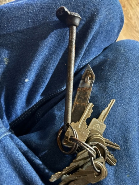

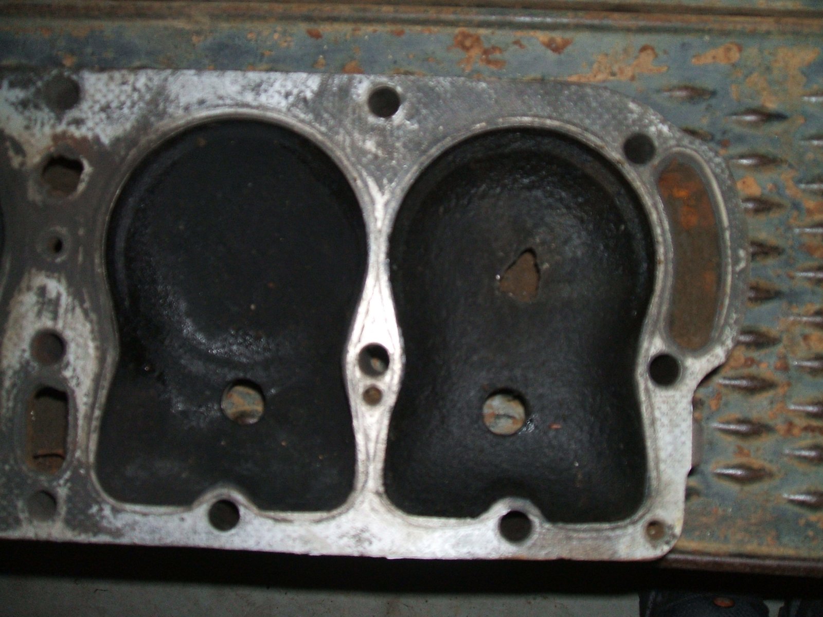

Post by RajoRacer » Thu Aug 22, 2024 10:12 am
This is what can happen ! I found the rest in the muffler !

If the valve head just breaks, that's one thing. It's when the broken piece punches a hole thru the top of a piston that things go downhill quickly.

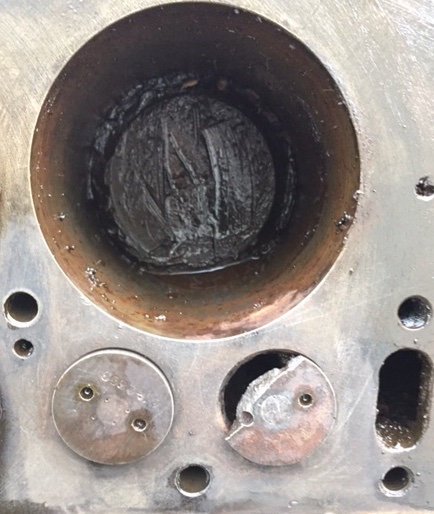

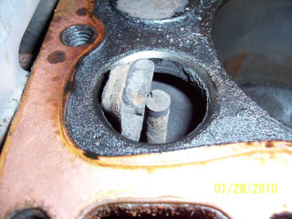

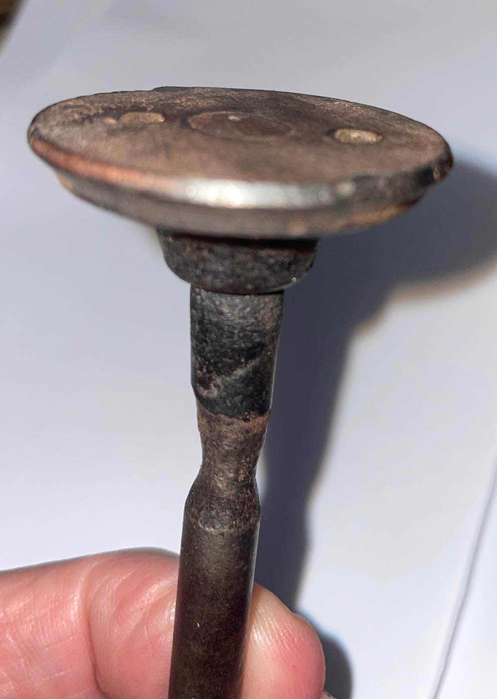

Post by DanTreace » Fri Aug 23, 2024 4:48 pm
Quite a few photos have been posted on the Forum over the years showing such damage. Those old iron head, steel stem valves should come out, always, if you want to save yourself some grief.
Steel stem burned away by intense exhaust heat, that iron head resisted though, may be because the higher quality iron used for the 2-piece heads, better than the iron used in the blocks?

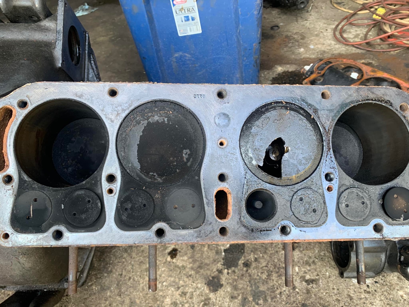

Another stuck 2-piece, at #4 , cracked off from the grinding recess holes. Also ran a while to ruin the seat. Hot exhaust.

Post by TXGOAT2 » Fri Aug 23, 2024 5:41 pm
I'd guess the valve heads were chilled iron.
Posts: 8673
Re: How often do 2 piece valves come apart?
Post by TXGOAT2 » Fri Aug 23, 2024 5:44 pm
A cylinder running lean for a long time will tend to destroy the exhaust valve and exhaust manifold. A poorly-seating valve in a cylinder that still fires will run extremely hot.

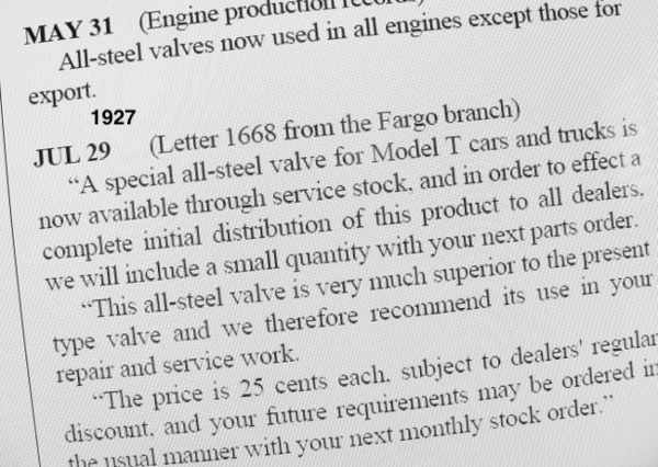

Post by John Codman » Sat Aug 24, 2024 12:29 pm
TXGOAT2 wrote:
Wed Aug 21, 2024 9:50 pm
Ford phased out the two-piece valves on some of the late production cars.
How late?
Post by TXGOAT2 » Sat Aug 24, 2024 3:41 pm
Very late, as I recall. There is a service letter or dealer letter somewhere that discusses it. I don't remember all the details. Unusually, Ford advised dealers to return unused stocks of any of the 2 piece valves on hand and to use the new one piece ones for service as soon as they were available.
The info is online, here or the Cimorelli site, or another well-known one.

Post by DanTreace » Sat Aug 24, 2024 8:18 pm
Very late indeed ;). From Bruce's book, documentation

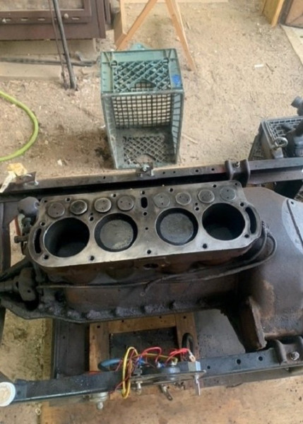

Post by J1MGolden » Wed Aug 28, 2024 6:26 pm
I recently purchased a 1925 engine that was in dry storage for about or over 100 years and has all the original valves and pistons.
After removing the top and cleaning up the area, I found two intake valves #1 and #4 stuck open.
They released with some cutting oil and Kroil added.
The block top was cleaned, and the head replaced.
To my amazement the engine started right up and runs great!

I recently purchased a 1925 engine that had been in storage for between 90 and 100 years and it was only used a few months each year to cut ice blocks in the winter season there.
The engine still turned over with the crank and did not have a starter or generator.
That made a compression test difficult to do, but two cylinders seemed to have no compression.
#1 and #4 or # 2 and #3 had the intake valves stuck open, but a little Kriol and some light taps let them move again.
#2 lasted "stuck" a little longer.
The engine started right up again, which was amazing.
A later compression test measured 55, 54, 51, 55 so #2 and #3 may have been the ones stuck open.

Post by dykker5502 » Mon Sep 09, 2024 5:23 pm
Been there - done that. I'll never hessitate to replace the 2 part valves. It costed me a head.
