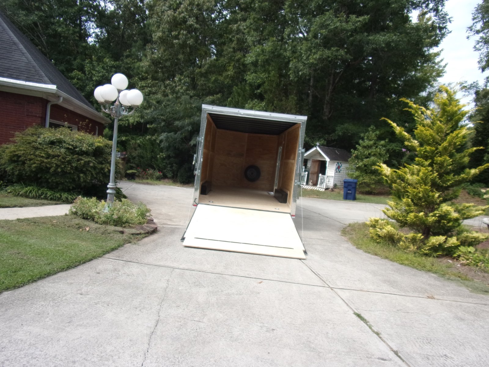

After constructing WWI ambulance project to the Ford plans, my overall height was 81" and the top is permanently attached. So, no issues until I start to look for enclosed trailer to transport and store this thing. Seems most standard enclosed trailers are not tall enought for most Model T's unless the top is lowered and the windshield is removed or moved out of the way.
So, it took a custom built enclosed trailer with a rear door height opening of 87", an interior height of 7.5 ft, a length of 18 ft and a width of 8.5 ft to allow me to enter the ambulance from the interior of the trailer to steer in and out. It will get winched in and out of the trailer and the floor of the trailer is slanted at the end to allow for shallow ramp door angle.
Mounting winch and painting plywood floor this weekend. Looking forward to loading and getting all the strap points figured out. I've been reading forum posts on winch cable attachment and tie down points.
Just didn't figure on a custom trailer, but at least I didn't have to take an ax to my garage door bricks like Henry did.

Congratulations Robert !! Did you find the trailer or have it custom built. The dimensions are the same as my custom designed trailer. I bought a TSC winch and took it locally to have it mounted. He quoted me $1000 just for mounting it ! I laughed in his face and spit in his eye :roll: Then I found a 5’ length of chain in the shop and bought 4 of those threaded chain lengths. I fitted a 2’ chain length to both forward D rings and each side of the winch frame. Hooked winch to a 12V battery for a test..VIOLIN ! It works and my mounting cost $26 :lol: :lol:

I had the trailer scratch built from my requests and it was ordered last Friday and picked up this Friday, so a seven day build. Polycor panels and I had them weld in a winch plate up in the V nose to the trailer frame. They wanted $1,500 for a winch and I can purchase a 12k winch for under $300 and purchase a battery and ABS battery box and install the winch myself. Keyless remotes on the winch will allow me or my wife to sit in the T and winch ourselves into and out of the trailer.
Spare tire mounted up in the V nose, but not much storage room left over. I'm designing in my head two 10" deep storage cabinets to mount up in the V nose area to hold tow straps, tie downs, spare tools, etc.
Trailer Plus wanted over $14k for this trailer and a six week build date and I paid less than $8k for this trailer out the door.
It's only been one day, but I'm a happy camper with it.
