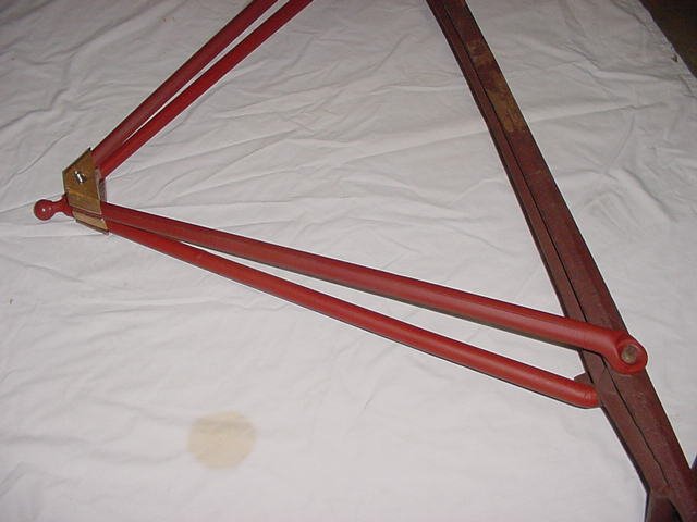

George, it would be nice if the bronze clamps were available again - they work well.

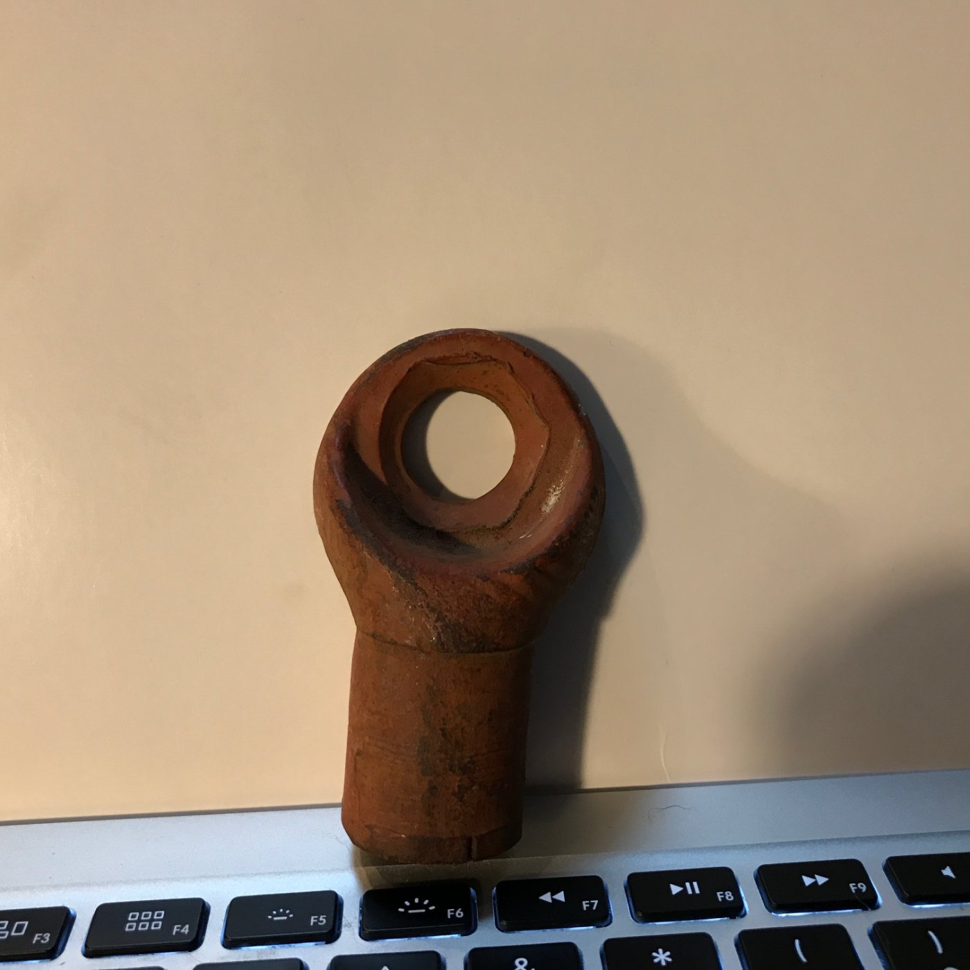

My under-axle supplementary wishbone uses the bronze clamp I think you're referring to. The guy who used to make them also sold eyelets that appeared to be cut off the ends of stock under-wishbones. You could weld them to a piece of tubing then clamp the tube in the bronze clamp. It still took some finagling to get the eyelets to fit over the threaded ends of the perches with enough room to mount a castle nut and a cotter pin. I ground a cup into the eyelet and a taper onto the castle nut. Still working good 10000 + miles later.
In the first photo you can see the bronze clamp and the eyelets used to attach the auxiliary wishbone to the underside of the axle, which is upside-down in the photo. Next is a close-up of the eyelet showing how I ground a cone into it to accept a tapered castle nut.

Yes; that’s what I want to explore for production. Only I won’t use the ‘eyelets’ welded to pipe. I’ve cut off the ball end of the later plentiful wishbones and plugged them into the 3 pc bronze system. The only somewhat difficult process is grinding the 2 under axle pieces down from over 3/8” to a little under 1/4”. This enables the earlier perch nuts and cotter pins to be used. I feel this is an obligatory safety feature and consequently approved for a Stynoskie entrant.
