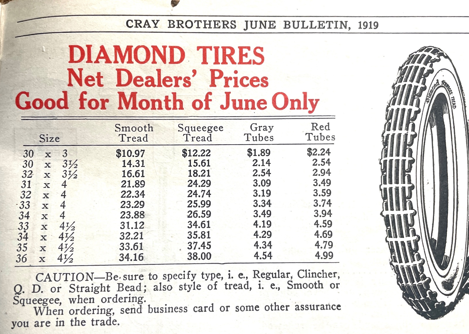

- Posts: 4090
Re: How late were smooth tires used?
Here is a rather new 1921 and it has smooth tread tires on front, and anti skid tires on the rear.
And catalog from 1919 listing smooth clincher tires.

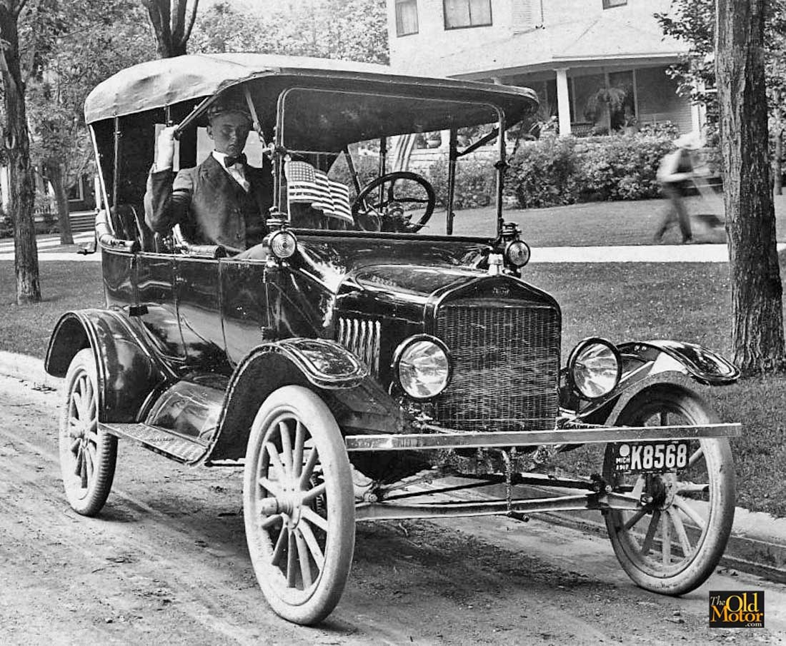

Dan:
Your photo shows a 1917 Ford. Note the 1917 Michigan license plate. It also has the 1915/16/early 1917 windshield hinges so it may have come off the assembly line in 1916.
Erik
Thanks for the correction on the year of that new like Ford as a 1917, my quick error.

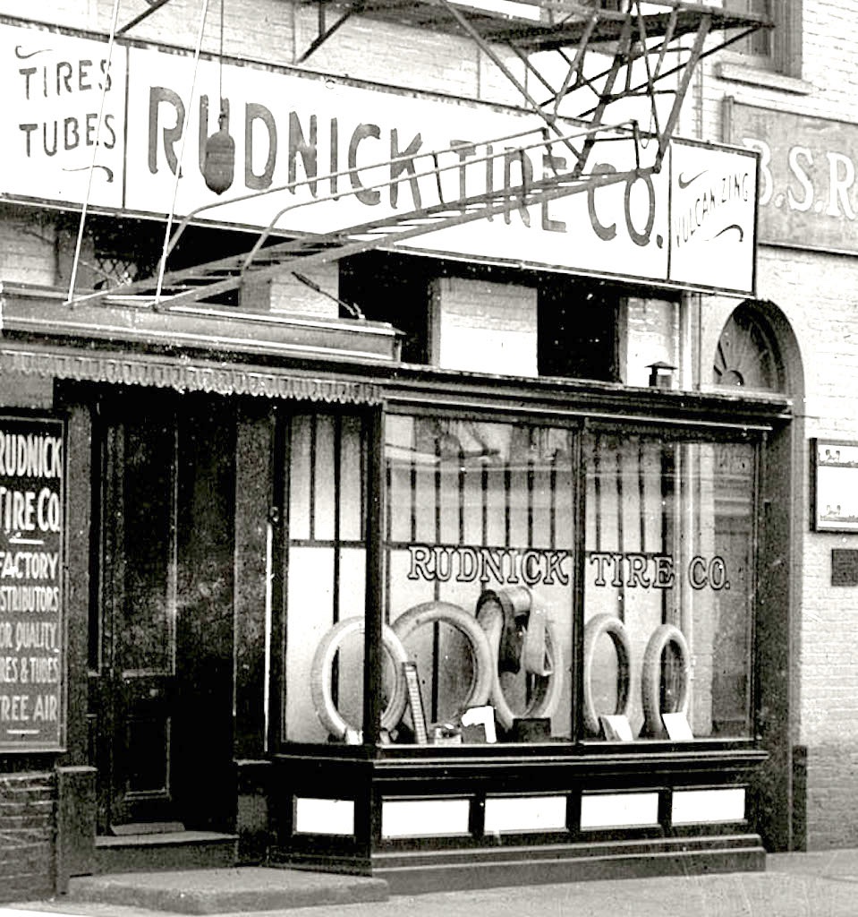

Jeff
As for white and black wall tires, many types were made before 'all black' became more popularity accepted by car owners.
Some of these tires were still with gum rubber, and many tire mfg experimented with different fillers to reduce the percentage of gum or to add cosmetic look or strength when laying up cords or fabric in building up the tire casing. So there were many different looking tires then.
Note the tire on the far left in the window, gray tread with white wall, and the tubes hanging, some gray, some red, as red rubber tubes and some red wall tires were deemed higher strength.
Jeff
