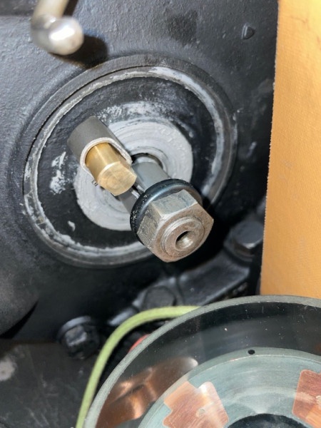

Post by DanTreace » Sun Oct 20, 2024 10:21 am
Might check if the timer front plate has the brass shield with felt behind for oil seal. The forward facing New Day rotor housing can impinge on a bent shield. Modern oil seal is preferred over the Ford brass shield and felt.
Or the New Day rotor protrudes too much due the the cam shaft designs, have seen that before, and modifying the rotor housing may be a cure.
Perhaps the New Day rotor brush was mis-aligned when fitting the New Day timer cover, allowing the bronze brush to be at an odd angle.
Wobble would be due to some mechanical interference somewhere, be sure to the New Day cover seats neatly and concentrically in the timer front plate groove, checking that with the rotor removed.
Brass shield, if the felt oil seal is used, the brass plate must be present or the rotor will grind up the felt.
IMG_2590 (314x500).jpg (96.49 KiB) Viewed 3109 times
The modern seal is preferred.

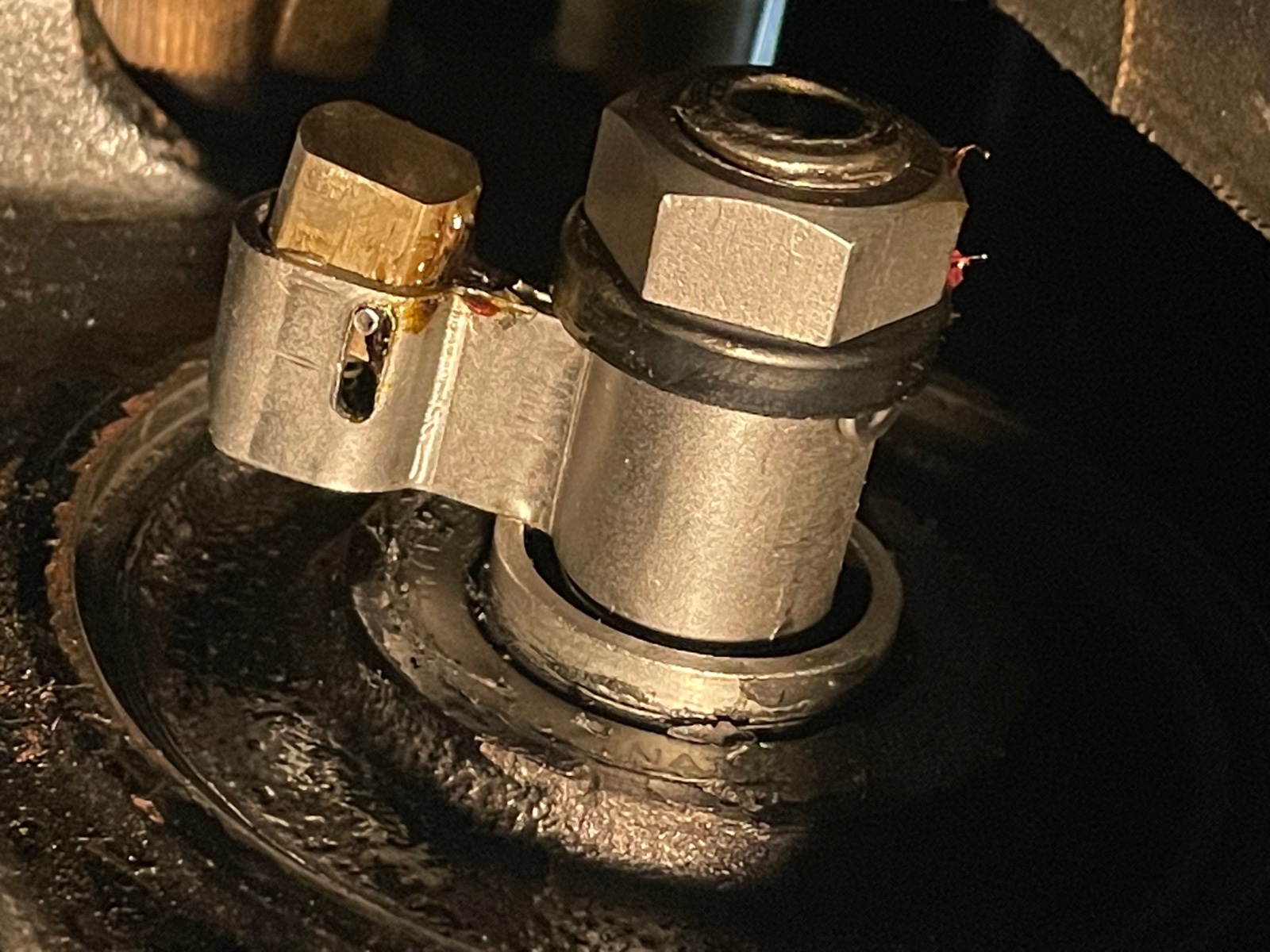

Post by bdtutton » Sun Oct 20, 2024 11:58 am
I had that same issue. The problem was that the oil seal I have sticks up and I had to cut a notch in the rotor it to make some clearance. It was a really bad wobble and it was grinding away at the timer. I am not sure what kind of seal is in my engine because it was that way when I bought it and it does not leak a drop so I am not going to touch it.

Post by speedytinc » Sun Oct 20, 2024 12:12 pm
The brush is sticking out further than the timer contact face.
To see how much, make a simple gage. A strip of thick paper strip trimmed to fit from the timer face to the mounted edge around the total inside diameter.
Take your gage & place in place of the timer in the timing gear cover. Eye sight or straight edge across the edges with the brush fully compressed. The brush must sit lower than gage the edges. It does not now.
You can look into the oil breather to see the type of cam gear.
The brush holder, brush or gear nut can be modified to fit. The brush holder should be seated down on the cams machined edge.
The felt & brass plate isnt good enough to keep ALL the oil out. That timer has to be run dry. Put a modern lip seal in.
What I see is the timing gear nut is sitting to high, not allowing the brush holder to seat on the cam.
The brush holder modification got the holder to seat properly.

What do you mean wobbles? Up down side to side or rocking across the face? Not sure how there would be up down side to side movement using a New Day as the brush should not be affected by the cover not being centered.
The nut used should have been the shorter one. The gear used would have been thicker than stock so the lip sticks out further. The nylon gears come with a shorter nut for example. But the solution works.
