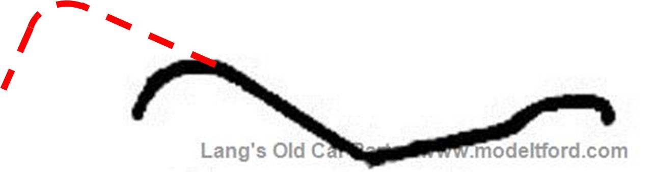

The timing may still be too far advanced. Count on having to reset the timer position per the instructions, ignore the part about checking it and maybe leaving it alone. Be sure that the #1 piston has gone 1/8 inch back down the bore after passing TDC before you set the initial timer position.
I couldn't stretch the stock timing rod enough to push the timer over to the correct position without the rod hitting one of the timer contacts, so I ended up having to fabricate a longer than stock timing rod, see the attached sketch.
