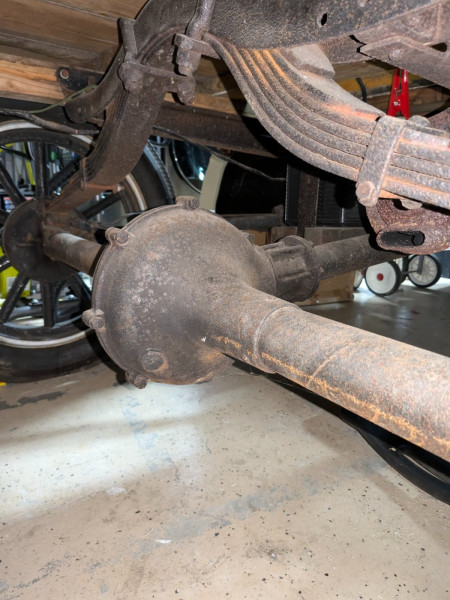

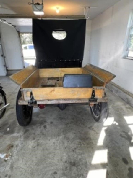

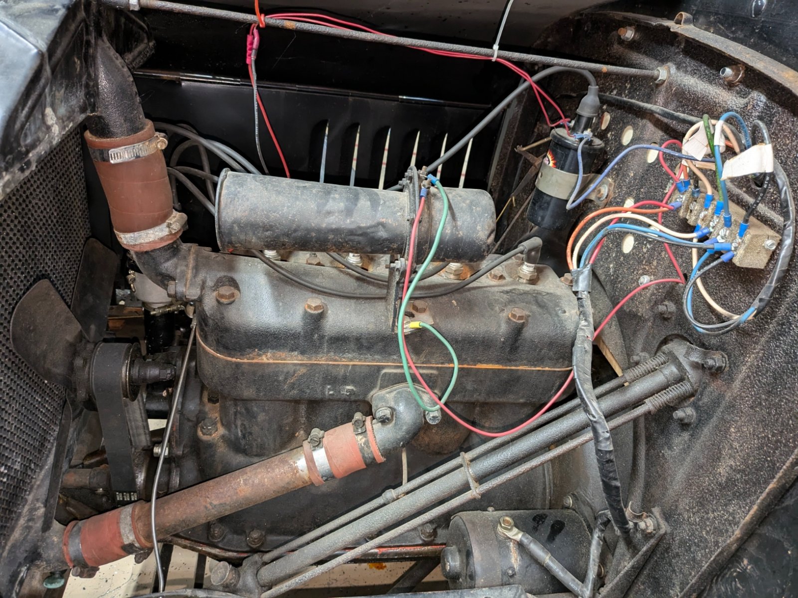

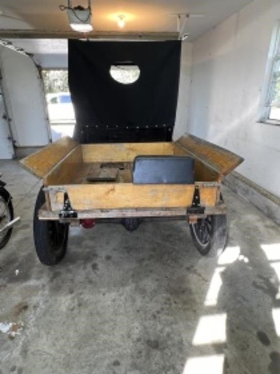

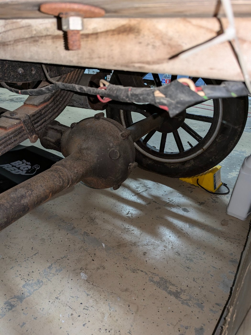

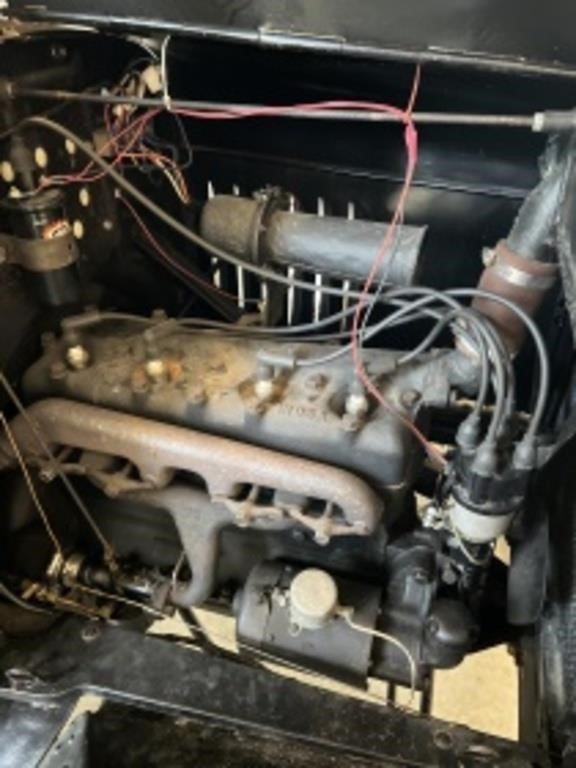

Post by suley » Tue Nov 19, 2024 10:33 pm
Wow! I love an active list!
I am not sure if it is a model T truck or a TT truck. I do have the engine serial number and will try to date it as soon as I am done typing this. Here are the pictures of the differential, truck bed and engine.
TIA!

Re: Newbie here
Post by KWTownsend » Tue Nov 19, 2024 11:46 pm
It is not a TT, but a standard chassis truck.
Looks nice. It may have a TT cab on it.
Need more pics...

Re: Newbie here
Post by Jerry VanOoteghem » Wed Nov 20, 2024 6:29 am
Yes. More pictures please. I would suggest that at some point, you install a complete new wiring harness. For now, however, if it works fine, that could probably wait a while.

Post by Oldav8tor » Wed Nov 20, 2024 4:09 pm
Definitely not a TT rear end. Please provide some shots from the side and front view. I suspect the car is made of a conglomeration of parts but don't let that bother you. Unique is fine :-)
If you aren't able to pin the serial number down to a specific day, post it here and I or someone else will look it up. Serial numbers are not necessarily definitive - the engine could have been swapped at some point.
Did you get the 1925 date from a title or other source?

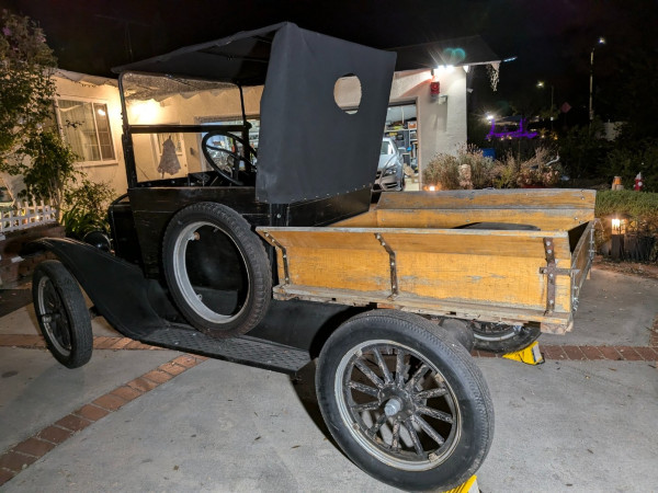

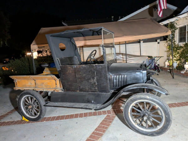

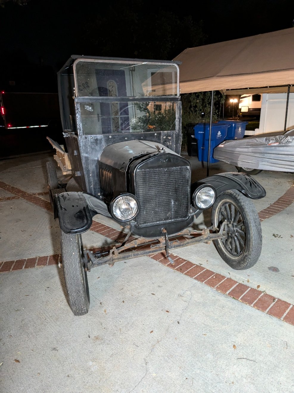

Post by suley » Wed Nov 20, 2024 9:27 pm
Yes a full rewire is on the cards... Also might paint the head as repainting and finishing has to be done...
I got the 1925 year from the PO and confirmed with your guidance and the database on fordmodelt.net. it was made April 24, 1925.
Right now I want to start it and am still waiting for the carb and oil change parts to be delivered. At least the battery is charged and I have found out that there is no engine oil leak. It was one of the petcocks which was not fully closes and was dripping oil. The non original distributor is bothering me and I am seriously wanting to revert it back to the timer... but one step at a time.
Also, there is no sediment bowl under the gas tank... the fuel line runs straight to the car with a valve just before the carb elbow. it is all copper with a piece of rubber line connecting it to the tank.
Here are some more pics...

Post by A Whiteman » Wed Nov 20, 2024 10:05 pm
Thanks for sharing and welcome to the hobby!
She looks a great old gal :-)
The cab is 'home made' or at least aftermarket - but hey, that is not unusual and it looks great.
All the best and enjoy the drive

Post by Oldav8tor » Thu Nov 21, 2024 6:12 pm
It's a good question what body your car originally had. The current body is a homemade pickup. You can keep it as is or rebuild it as whatever you want. Factory bodies become available, or you could build a speedster, Depot hack, piewagon or whatever. I suspect you'll have a lot of fun, regardless!
One safety item you should check - grab the spokes and see if they are loose. If any are, it's probably time to consider having the wheel rebuilt. Wheels are one item you shouldn't fool around with.

Post by RecklessKelly » Thu Nov 21, 2024 6:44 pm
Looks like a neat truck. It definately has some history behind it. The distributor may have been added due to a broken mag, but should be fine.
Before you start it, you may want to put a teaspoon of oil in the cylinders and hand crank it slowly to distribute the oil. You can hook up the plugs and rest them on the head and check for spark.
You may find all of the oil leaks after its been run, which is when they leak the most. You may want to do the inevitable before you put gas in it, clean the tank, fuel line, carburetor with fresh gaskets.
