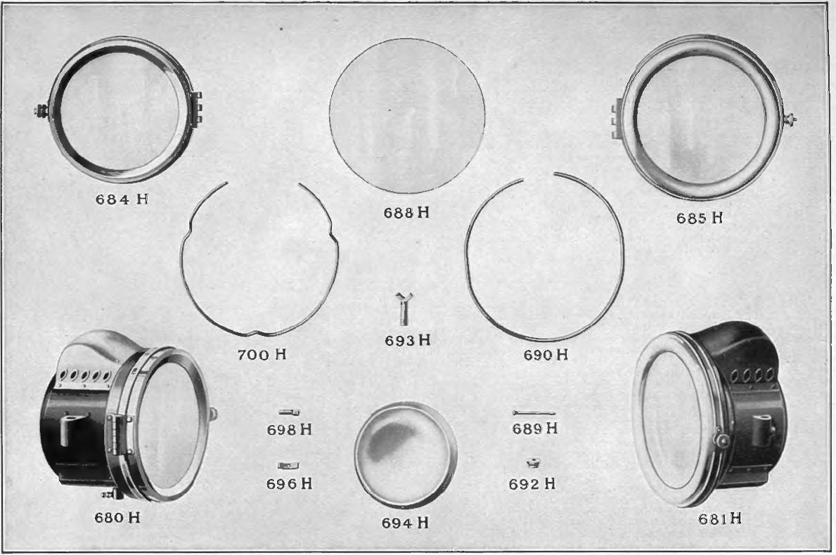

Are you talking about the retaining ring shown in this headlamp rim?
I have John Brown 16s and made mine from brass rod which snaps in
the groove provided in the headlamp rim.

The parts list for accessories shows a wire retainer. Part 690H

So the "ring", 690H, is open and made of spring steel to allow for expansion
