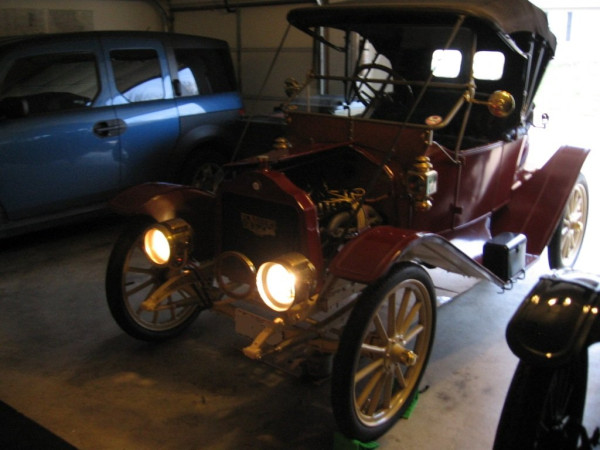

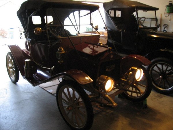

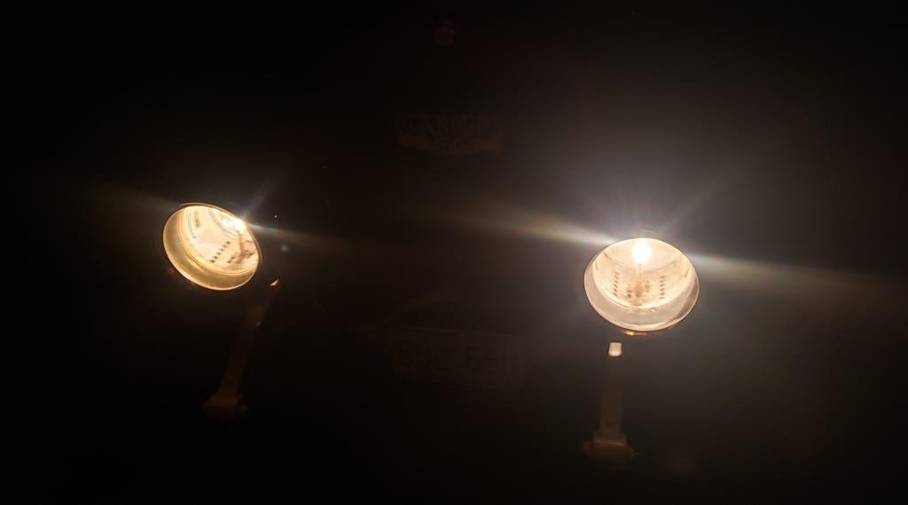

When I was first experimenting with the E&J 366 headlamps on my 1912 Flanders 20, I found that a golf ball size pile of carbide and a water drip rate of 1 drop per second would keep both headlights lit for about 20 minutes. Open the headlight doors before starting the water flow, then wait a few seconds for the acetylene to reach the burners. Then lightly blow into the open headlamp just before lighting the burners to clear out any acetylene that may have built up inside. I used one of those long-nose lighters to light the lamps to keep my hand away from the burner when it lit. The lamps are surprisingly bright, Have fun! :)
One other thing - once the flow of acetylene stops, be sure to thoroughly rinse out the inside of the generator and basket with water, then let dry. The residue is messy and is nearly impossible to remove once it dries.

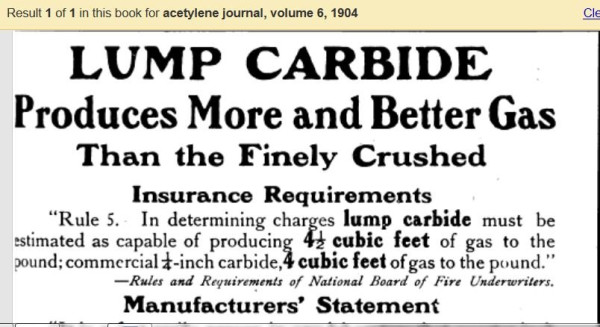

Mark has answered a good "show how it works" with the least mess. I just checked Karst Sports
and see ten pounds of 1/4" to 1/2" carbide is $174.95. Your two 3/4 cubic foot burner headlamps
use a little less than a 1/4-pound of carbide per thirty minutes.
