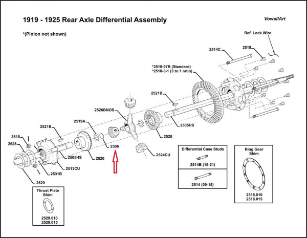

The red washer goes between the ends of the axles in the carrier. It keeps the shafts from moving in and out.

Something seems to be seriously wrong. The red washer goes between the inner ends of the two axle shafts. It will do nothing to take away 1" (!) of side-to-side bearing travel. If you don't have the MTFCA rear axle rebuild manual you should seriously consider buying one.Rajo T Speedster wrote: ↑Fri Dec 20, 2024 8:49 am

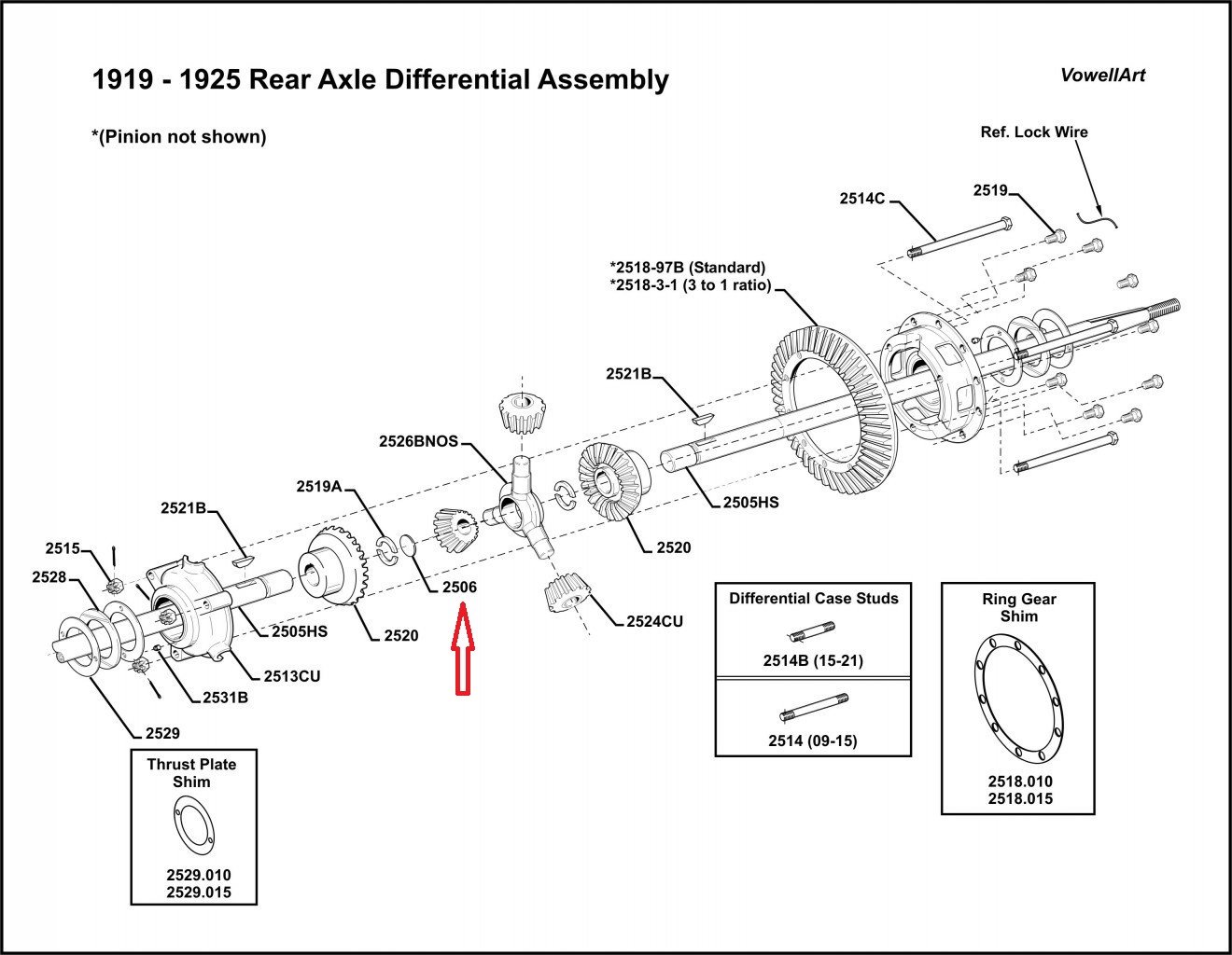

Part 2506 is normally red but different thickness may be required - gray or brass

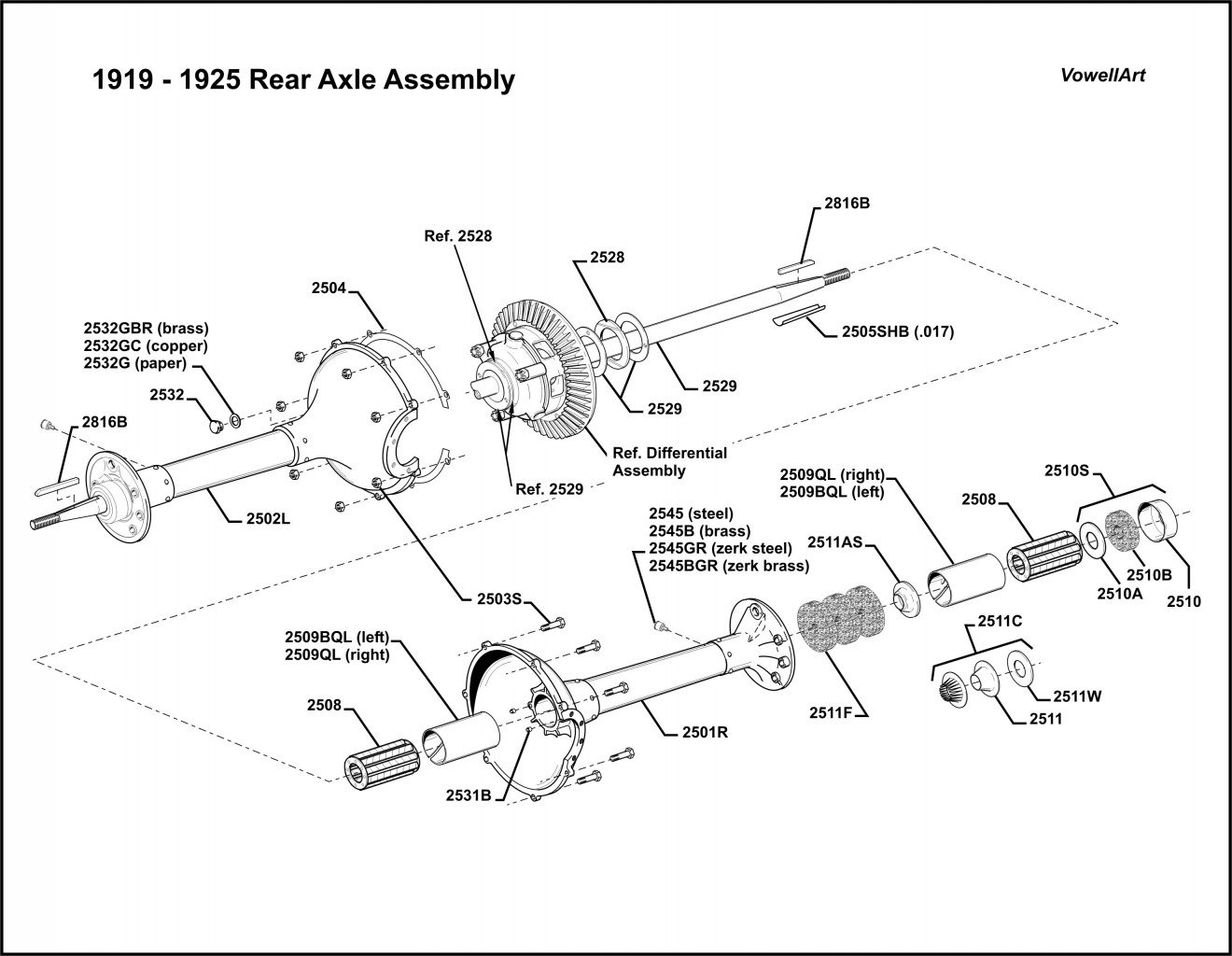

Both ends of the axle housing have an internal thick ring held in with the rivets that hold the backing plate or pumpkin onto the tube.
This is your bearing stop. Its right @ the edge of the sleeve. 1" is really excessive, even for a lot of wear from a rubbing bearing cage.
The only way I can think you could have an extra 1" possible bearing travel would be if the collar was never installed or removed in a "re-tube" process on an old pumpkin. Possibly a shorter than normal bearing??

If the axle shaft moves it could be an old babbit ring inside. The replacement bronze rings last much better. The right side movement would be limited by the gears.

Should be the same length. The sleeves will be different depending on the right or left. The dimple on the sleeve will fit into a hole in the tube with the open side of the sleeve down.

1” diameter fiber washer goes between the axle ends when assembling the spider gears and center carrier
