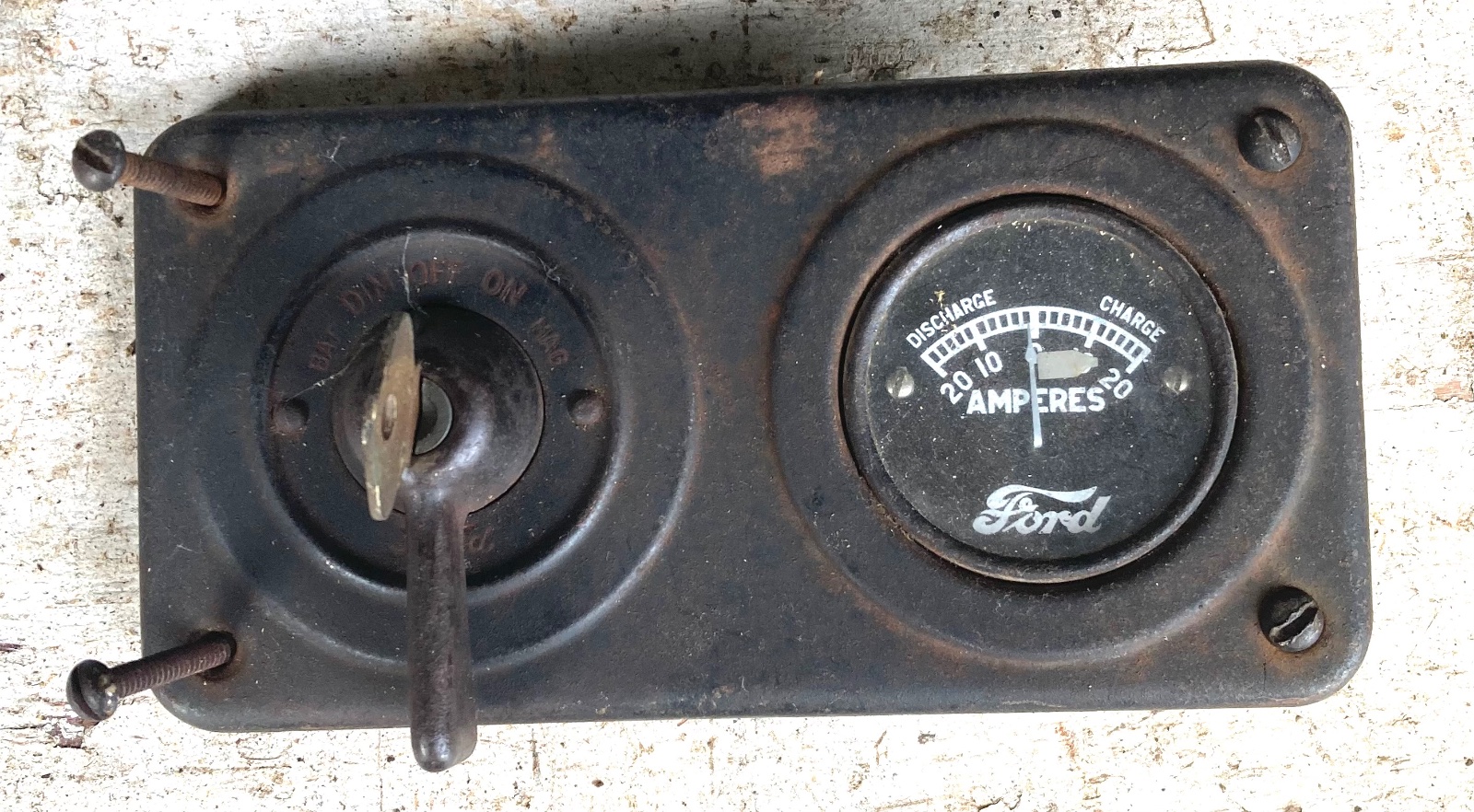

My key fits nicely into the ignition of the switch plate but doesn’t move the tumbler. I’m afraid the pot metal is swollen but really don’t want to purchase and install a new one. Has anyone had this ignition challenge and overcame it ?

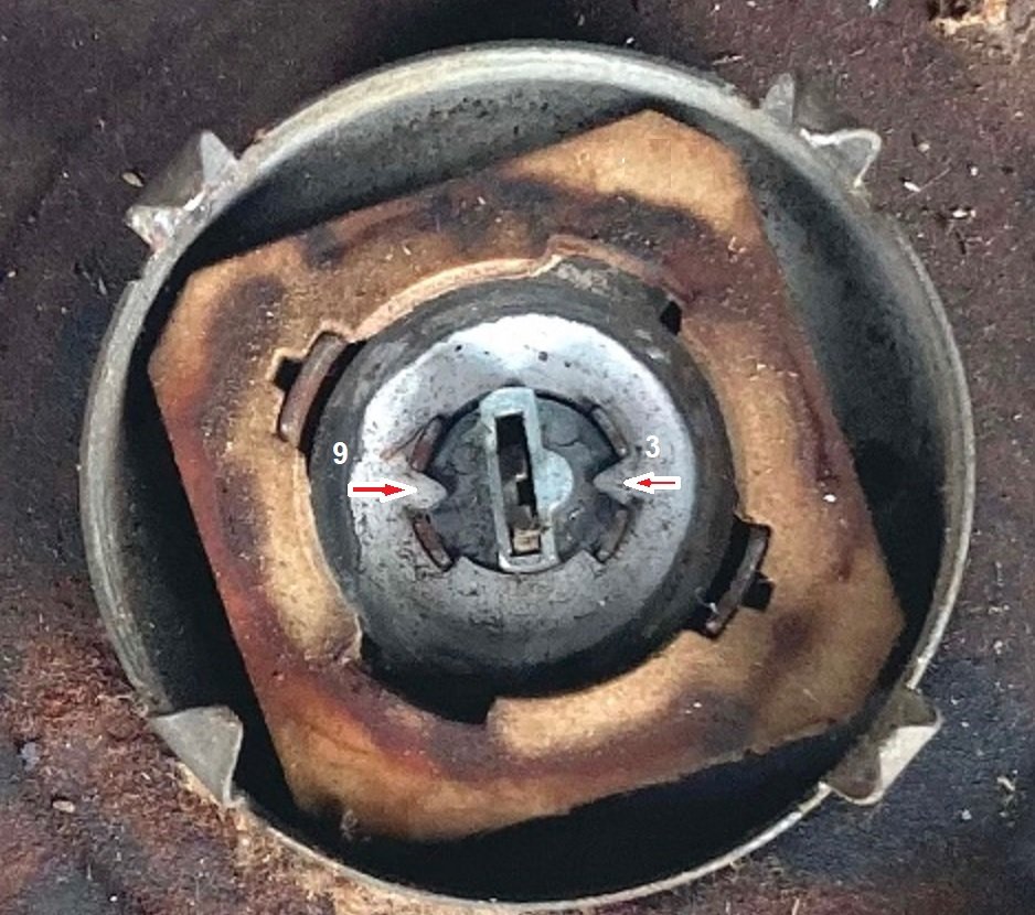

Yes, the cylinder slightly moves Jerry. Zoom in to the backside of the picture I posted. In the small vertical rectangle you can see the key front. The cylinder surrounds the ‘rectangle’ and the triangles at 9:00 and 3:00 disallows movement of the cylinder. How should I proceed to overcome ? Thanks all….

Swelling of the lock cylinder is most likely the culprit - the cylinder should turn either direction until the "stops" - mag. one way, bat. the other. If lubrication doesn't assist in operation, it might very well be toast !
Hard to say without holding it in hand. I'm wondering if growth in the cylinder length isn't causing it to bind against the "9 & 3" tabs you mention.
The switch is actual two switches in one.The "rectangle" piece is operated by the handle is toi control the lights. The key selects the power source OFF, BAT, MAG. there is no connection between them. The arrows pointing at positions 9 & 3 are stops to prevent the key from going past the respective positon

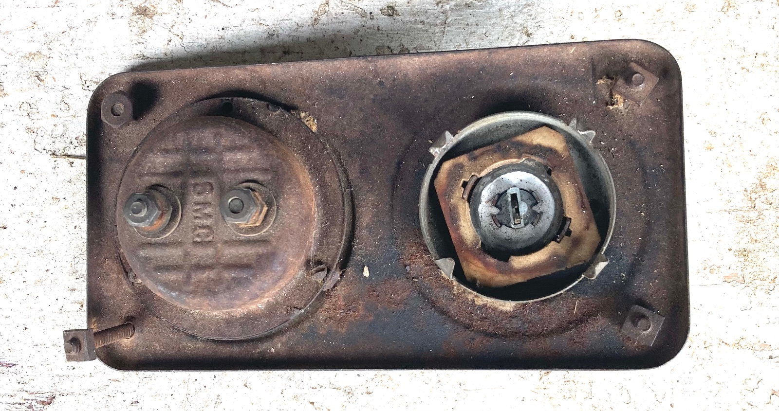

Frank, I moved the headlight lever from DIM to BRIGHT and it actuated that tan square paper-like component with 4 rounded corners. Not the tumbler/cylinder. But I’ll soak the latter in PB Blaster again tonight.

The headlight lever only moves the tan square component. The key only turns the rectangle end on the cylinder (tumbler) slightly to the left or right. That is attached to the mall circular disk.
when viewed from the back \ MAG & / BAT
You can pry up the square fiber rectangle, carefully a little at a time. It may be stuck with some rust residue. Note the handle position.

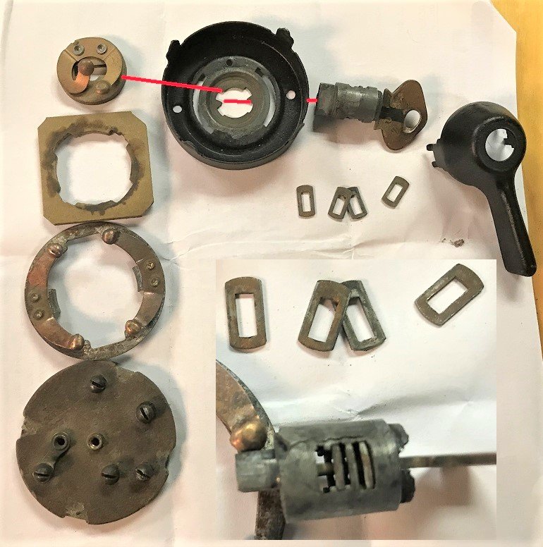

The cylinder resides inside a cage that has openings, top & bottom, to allow the wafers to drop/raise when a key is inserted. When no key in in the cylinder the wafers drop down do to gravity. Some wafers are brass others steel. Some times a key need to be pulled back a hair to setup the wafers properly

Yes; I was just answering your “rectangle piece is operated by the handle to control the lights” by stating the headlamp lever actuates that square piece. If you’d lift that G shaped central component in your last photo, you’ll see the cylinder and the 2 points at 9 and 3. The cylinder (#58) slightly moves with key #58 but those 2 points prevent the key&cylinder from going to BAT or MAG. Therein lies my problem. But I greatly appreciate your illustrations when its time to reassemble the loose components.
