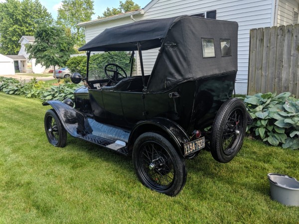

My touring car is titled as a 1926 but bears none of the improved design features of a '26/'27.
The engine number is 12521890 and my research indicates that it was manufactured at the River Rouge plant in October 1925.
Keeping in mind that the engine may not be original anyway, is there some other way to narrow down the date of manufacture of the car?
It has an oval gas tank under the front seat, 16" O.D. Fordite steering wheel, 11 inch rear drums and wire wheels.
Thoughts? Does it matter? Or is it enough that I've got it narrowed down to '20 to '25?
Or did they manufacture some of these in 1926 before changing over to the improved design?

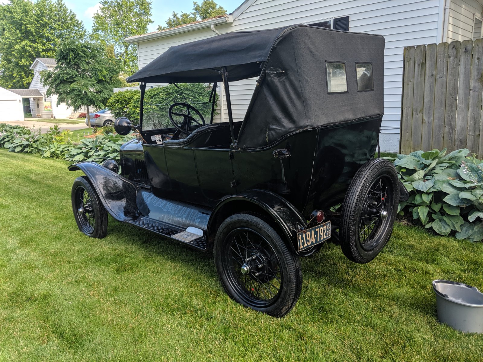

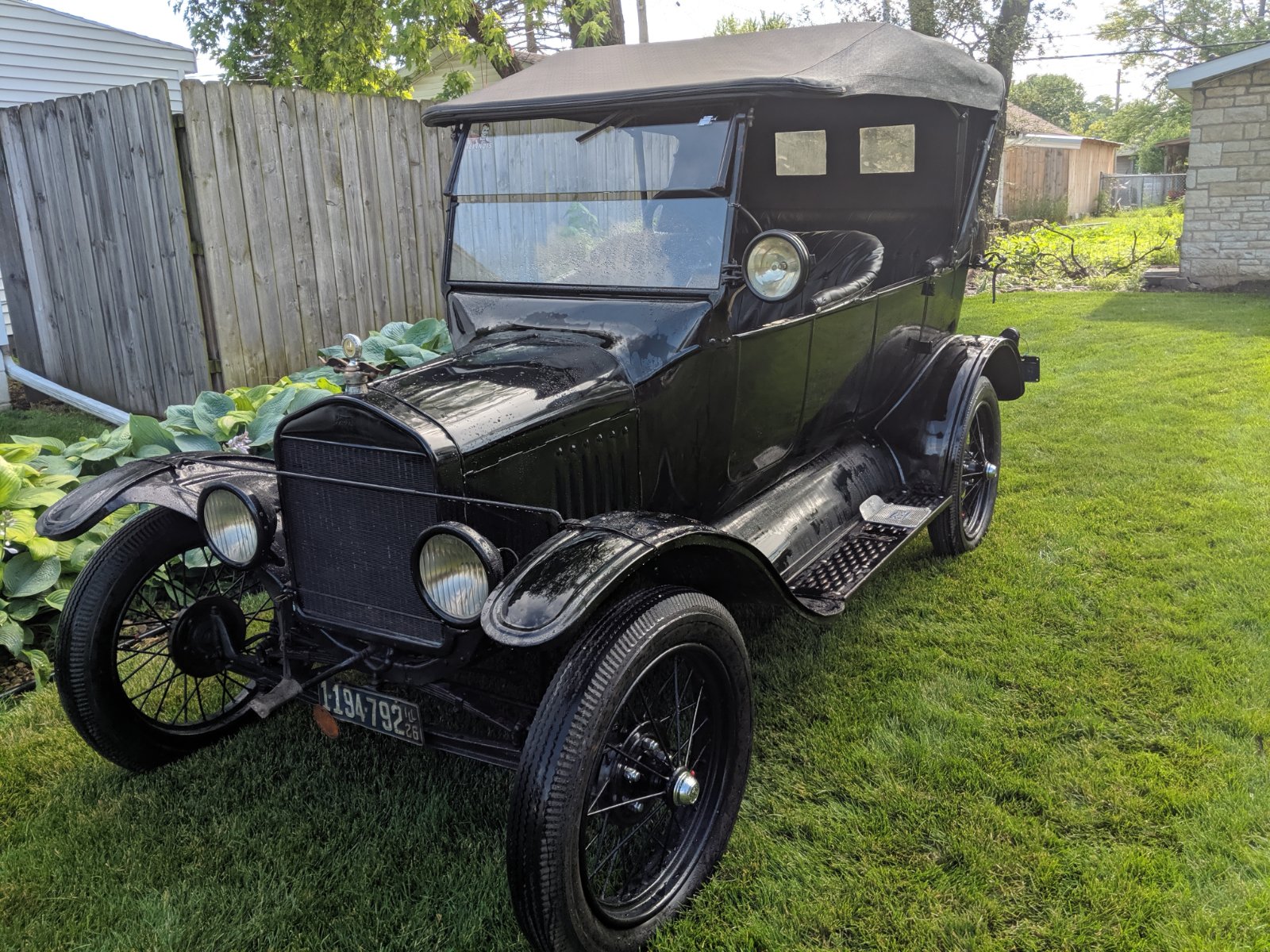

The sloping windshield would make it 1923-25. The large drum rear end could make it a late 1925. How about a view of the front fender's raised curves? Does one curve go under the side splash shield or run parallel to it? Under would make it a 1925, parallel would be 1923-24, give and take a month or two depending upon the assembly plant's supply of obsoleted fenders for the 1925 model. The wire wheels didn't come out until mid-1926, so they are definitely incorrect for your Touring, although a nice reliability and safety feature over rotted wooden spokes.

Seems like it goes under (if I'm understanding what you're talking about - I'm still learning the lingo.)

You're right about October 1925. Monday the 19th, to pin it down. That's in the 1926 model year of course, but the absence of any improved car features makes me suspect it's a replacement engine in a 23-25 car.
- Posts: 4622
Re: Titled as a '26 but . . .
Your car sure looks to be a 25 to me. It’s not a 26 body wise. If that’s the original engine in the car and it’s a Oct build date it could have been sold as the next years car or it was a T that didn’t actually get sold until early 26. The wheels are 26-27 wires and were probably added later.

The engine could well be a 26, especially with that serial number. The big obvious change made to engine and trans that year was a set of wide pedals for the clutch and brake, and a less visible change was a set of bolts between the top of the hogshead (trans cover) and the back of the block. It seems those bolts are frequently missing but the presence of the holes is a clue.

Hard to distinguish but from the first photo, it appears the rear door hinge is longer at the bottom than the top one - indicates a '23 - '24 body. Door hinges that are parallel would indicate a 1925.

From the steep angle on the cowl, lack of the wide radiator apron and not seeing any apron on the fender skirt. I claim this is a low radiator 23.

If it’s a low cowl 23 it has the later 24-25 fenders that have the lip next to the radiator on it.
You can see the fender lips in the photo. The earlier and later fenders in the 17-25 era will interchange. A lot of T’s have have either this or that style of fender on them in this year range.
A look at the engine to see if it actually has a 26 engine in it will tell the rest of the story. If it’s a 26 engine you can tell by looking at the back of the engine just below the cyl. head and see if it has the 2 bolts that go through the transmission cover and screw into the back of the block.

This might help to see if it has low or high radiator to help date the car;
http://www.mtfca.com/discus/messages/41 ... 1403557682
Generally you can't mix and match body, hood and radiators between low and high radiator cars, things just don't line up. Tops, windshields, fenders different story.
From Bruce's book, the US one man top was introduced in September of 1922. If it has low radiator and one man top, I would say it is a 1923 model. If it is a tall radiator it would be a 1924-1925. There is, except the rear end, wheels and maybe engine, nothing 1926-27 about this T. I am guessing someone used the engine number (?) to title the car if the engine is 1926 as described above. I would let sleeping dogs lie re the title and paper work, but if you do sell it disclose the information to buyer. (I don't think without a lot of rework that the forged front irons can be put on 1926-27 frame)
