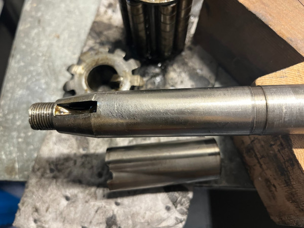

Wondering if I should replace this drive shaft now that it's out of my 1915 roadster. The thrust bearing cut a groove, visible in the photo. I'm installing a modern pinion bearing from Texas T Parts which I assume is the old Fun Projects design.

If you are asking, replace it. It is possibly 110 years old and that groove will be a weak area.

I think it looks worn where the sleeve sits. Look at the lip at the back end between the pinion and sleeve.
Since he got the sleeve off in 1 piece tells me it's worn.

While without miking it, does look a bit worn, just the fact that the sleeve came off in one piece does not tell us anything. Depending on what tool that was used to pull it off, such as the Stevens puller, they can be removed in one piece without slitting.

I would see how the modern pinion bearing fits. There are two bearing surfaces & the split lock ring. Even if the bearings fit (slip fit?), my guess is that the split lock ring will sit on the groove made by the thrust bearing and that would eliminate the usability of the drive shaft

Thanks for the replies. I agree that a replacement drive shaft would be best.

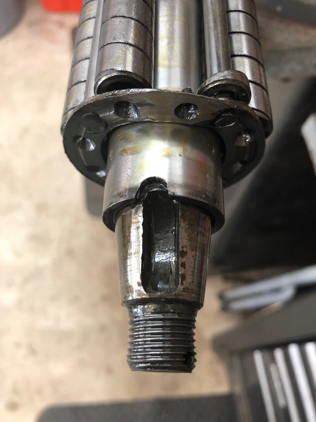

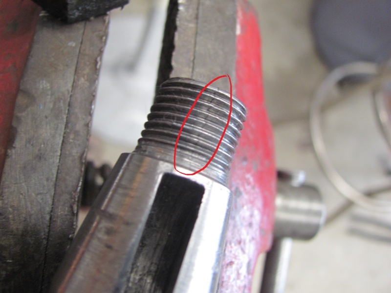

On these, the one has wallowed out key way, and the other was good in all respects, except very close inspection on that used driveshaft shows a deep crack.

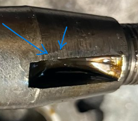

That shaft is severely worn in several places. It also has a crack forming. Always look closely at the side walls of the keyways for emerging cracks. Same holds true for axle shafts and steering column shafts as well.

I had an axle shaft do the same thing. It was split in a dead straight line, from one end to the other.
