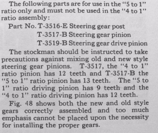

Wayne, both the 4:1 and 5:1 have 36 teeth so the only real difference is the slot length. Slot width did change, however, probably to accommodate manufacturing tolerances. This is from the encyclopedia.
02-23-22 Changed angle between centerline of case and the center of 13/64” radius at ends of slot for stop pin from 45 degrees to 51 degrees.
05-27-24 Changed angle between centerline and ends of stop slot from 51 degrees to 60 degrees.
09-27-24 Changed angle between centerline and right hand end of slot from 60 degrees to 65 degrees. Specified for 1925.
10-07-25 Changed angle between centerline and ends of stop slot from 60 to 62 degrees on left side and 55 to 67 degrees on right side.
I took a 4:1 gear case that I got from Dave Stroud and milled it to match the last angle change before putting it in my car. I did not do the research but the slot angle changes may have coincided with changes in pitman arm length.

Correct. He needs to swap the 4:1 steering shaft for a 5:1 shaft and use 5:1 gears. Pin spacing on the two steering shafts are different. That may be why slots were made wider to accommodate different pin spacing. After I assembled my converted gear case I had to trim two spots in the slot with a dremel tool to clear the pin.

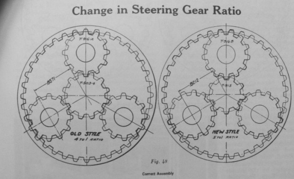

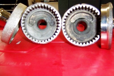

That is likely the engineering change, the wider pinion posts on the 5:1 ratio steering post shaft.
Here are the two cases, on right is the 4:1, on the left 5:1 for the balloon tires, note the longer groove.
gear case.jpg (69.45 KiB) Viewed 8510 times

To me, Wayne Sheldon's comments sure made sense. The main shaft only rotates so many degrees no matter what ratio is driving it. I don't know why they made the groove any longer, but do know that it had to be wider as the distance from the center of the shaft to the center of the gear pins increased with the 5:1 setup. I've converted 6 Model T's from 4:1 to 5:1 and never had a problem and did not notice a change in turning radius but did notice the ratio change providing more control in actually steering the car(s) . For my '25 Coupe, I found a short pitman arm ( almost 1" shorter ) which also helped although I had to fabricate a blocking plate to prevent the system from going over center.
