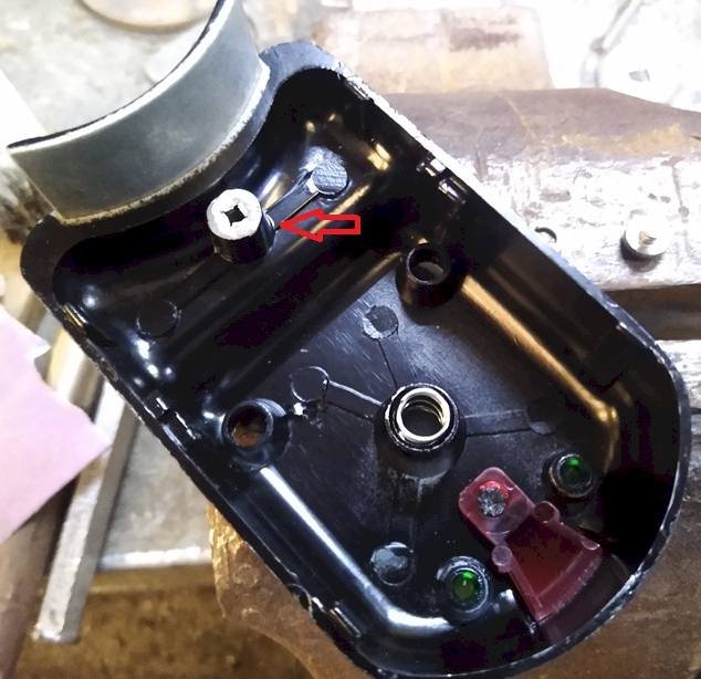

This is the opened top half of the turn switch. The instructions say to scrape away paint from the steering column so that the clamp makes electrical contact between the column and the exposed zinc casting. Some time ago I already stated that we disassembled the frame, fixed it, painted it and reassembled it to find poor grounds everywhere. We decided to run a separate wire for ground to all points needed. And here we are again, attaching a small black wire.

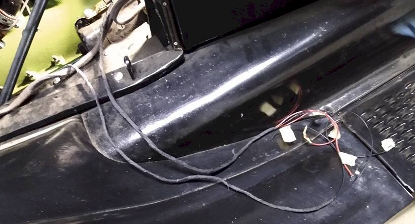

There is a blade fuse, not the glass one provided, from the starter switch positive hot, red wire to the brake switch. Two red wires leave, one from each side of the brake switch, one carrying the hot, and the other for the brake light. These two red wires join two black wires from the bright contact of each tail light into a loom.

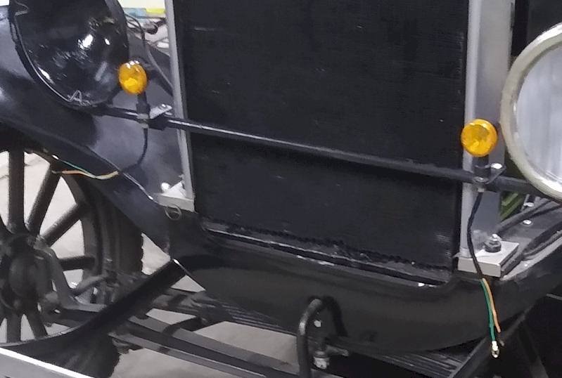

It's time to make brackets for the front turn lights, single contact, no parking lights on the front.
turn 03.jpg (36.4 KiB) Viewed 1709 times

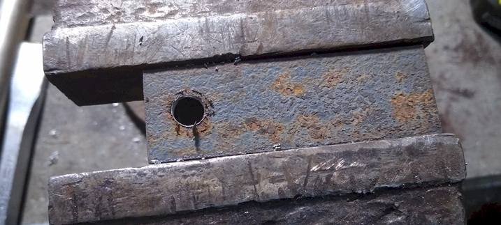

This is the hole for the motorcycle turn light which has been repurposed.

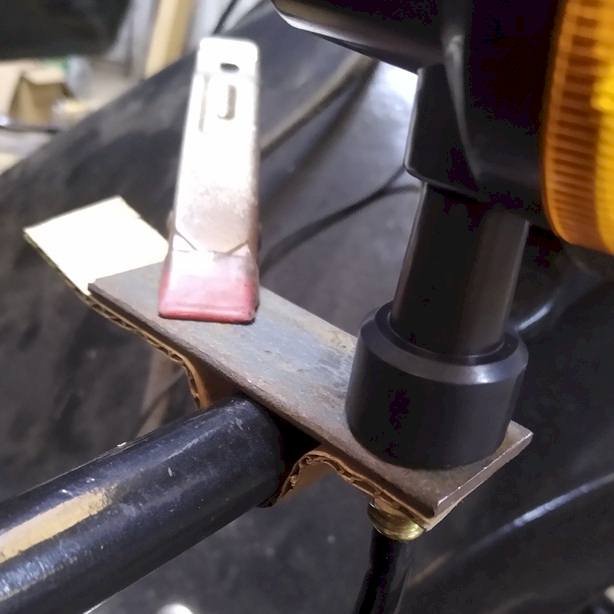

With the turn light mounted in place and a piece of cardboard, it's time to mock up the lower brackets.

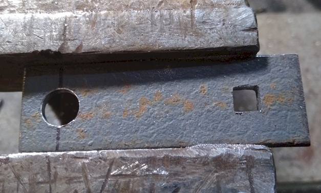

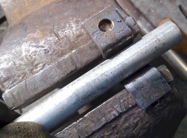

This is just conduit that I keep rolling as I strike with a hammer.
Got the shape that I wanted.
Both get a round hole, aligned.
turn 08.jpg (51.07 KiB) Viewed 1620 times
Top plate gets the square, for tightening the two brackets.

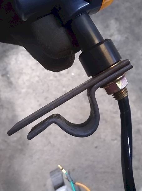

1/8" Rubber friction hold.
I had to purchase extra...hate saying it...metric nuts on the business end to prevent cracking the plastic mount. There is stress between the two brackets and using only 1 nut puts way more pressure on the plastic than it can handle.
turn 12.jpg (38.5 KiB) Viewed 1575 times

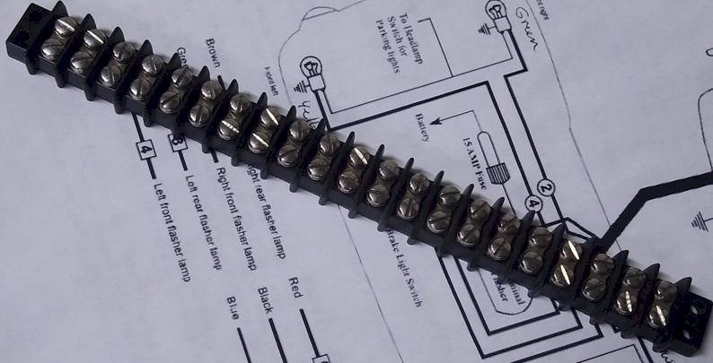

My first thought was to solder the wires together inside the cowl & dash area. But then I remembered the way Henry did it and followed his example.
Cut down the bus bar, crimped blade connectors for the flasher (6v electronic), and came up with a plan. This flasher requires a separate ground anyway. I do not quite have a mounting location but am considering utilizing the strews from the stock bus bar to hold a bracket on the inside. Makes me think, why didn't Henry mount the electricals on the other side of the firewall?
