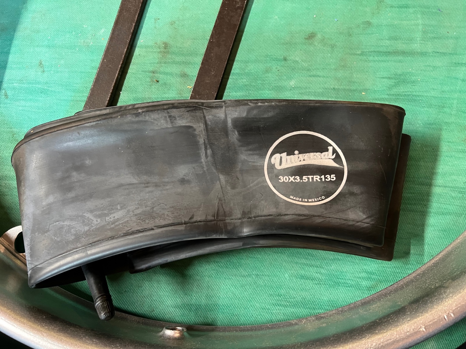

Put the tube in first inflate the tube (low amount of air) just so it doesn’t have any wrinkles. Now put your flap in being sure to fit it on both sides of the tube. The flap should not be bulging out locate the valve stem, pinch the tire sides together where the stem is and insert it into the rim, now work the lower bead over the rim using your spoons. The flap should help you from pinching the tube. Once the lower side is in start working the top bead over the rim with your spoons. Once the bead is over the rim check your valve stem to make sure it’s straight & not in an angle. Inflate the tube a bit more making sure the beads are locking under the rim edge. Once you get it there inflate to 45lb. This is where I’ll inspect the edges and use a rubber mallet to make sure the tire bead is catching under the rim edge. If I’m satisfied I’ll air up to 55 looking for any problem & trying to listen for the pop as the beads are locking in under the edge of the rim. If all is good I remove the the Schrader valve a bit and deflate the tube then tighten it again and inflate to 60lb. Some folks use talcum power, some use plastic garbage bags but I’ve had no real issue not using either. Your mileage may vary. Best John

John explains it perfectly. Tube, inflate a little, install flap, inflate a little more, then install on rim. Course I have it easy since I let Adam put my tires together on his tire machine, but that is how he does it.

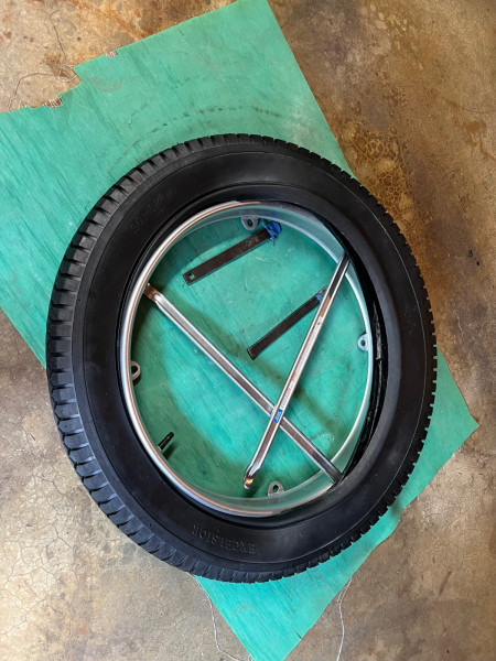

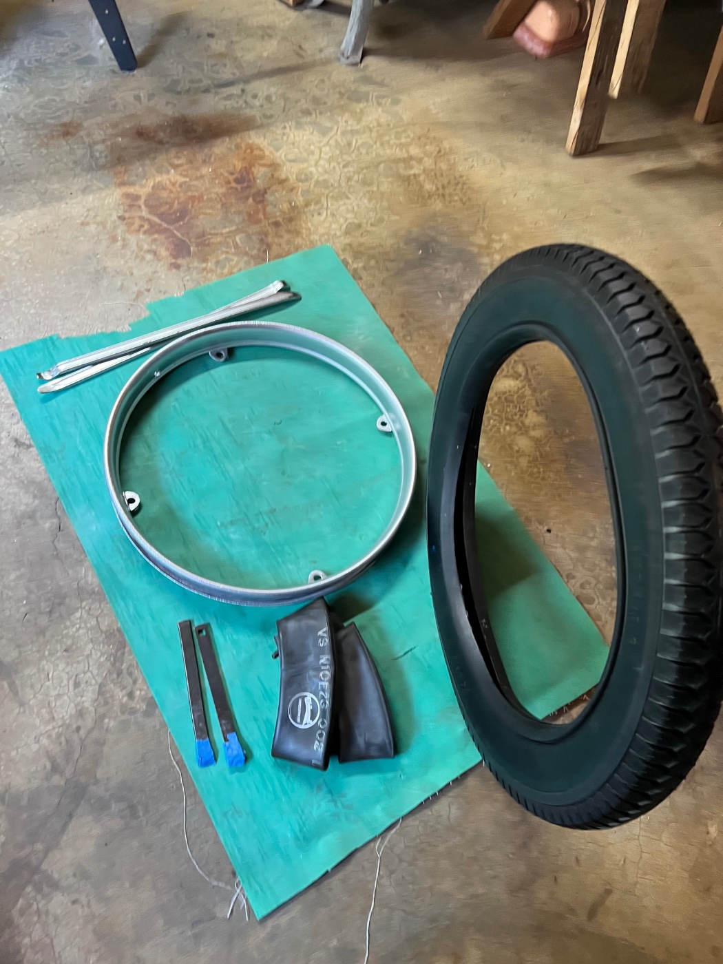

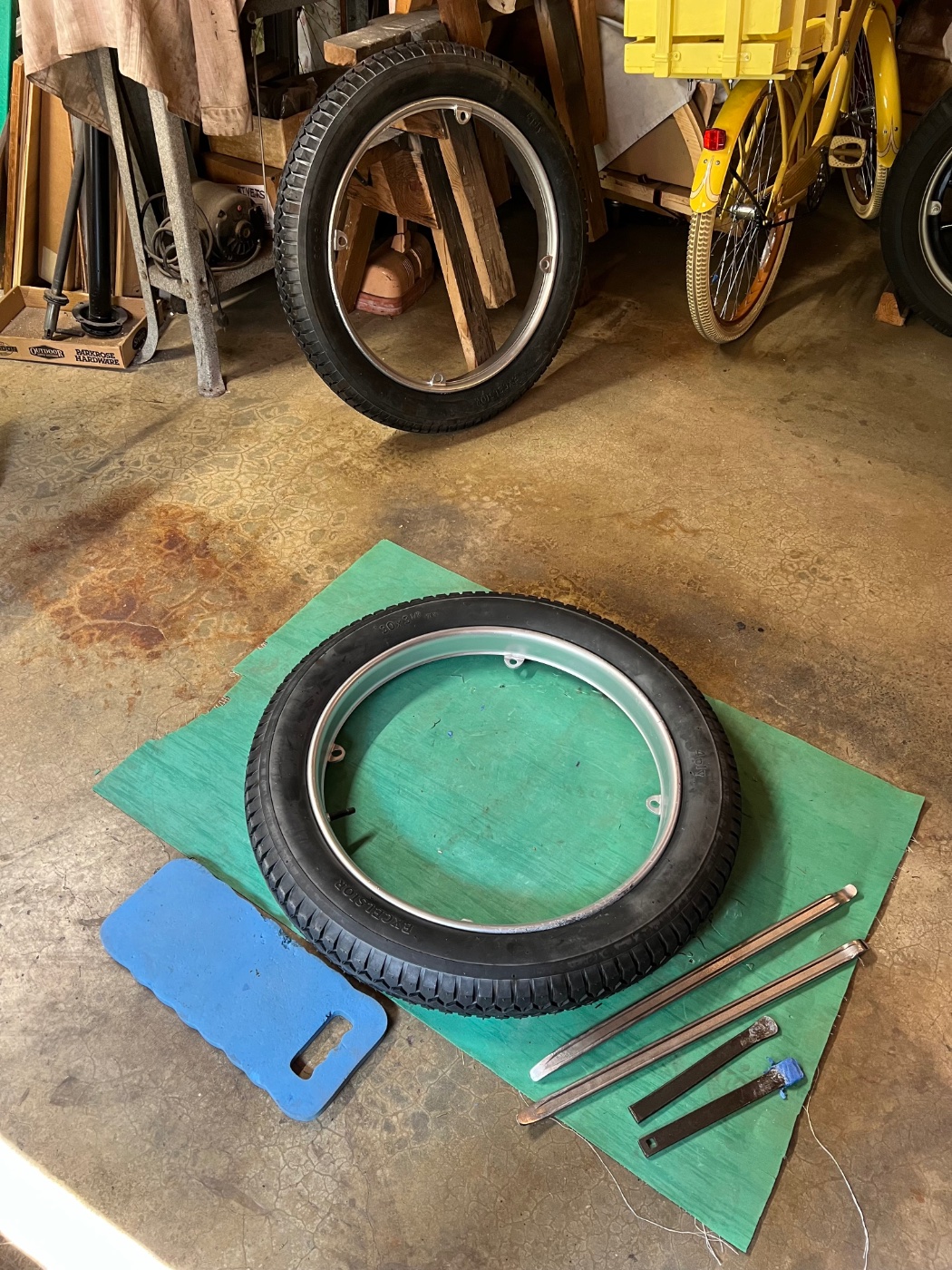

The picture montage should be helpful to you.
Early on I used flaps on clincher tire installs.
Flaps do add a bunch of extra protection against pinched tubes. Without flaps, you have to be extra careful.
The garbage bag video method using only your hands is on drop center tires. (21" wires), not clinchers. Not the same.
I do install both beads @ the same time for all T tire types.

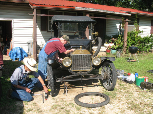

When I first got into this game, like all new guys, I found mounting tires quite a struggle. Eventually I got into Model T travel, which means covering lots of miles. It also means an occasional need to change a tire. I guess practice didn't make me perfect, but it got me to the point where changing a tire was no big deal. If I ever have the opportunity, I'll make a video. Until then, I'll just tell some things that may help.
I prefer changing a tire with the wheel ON THE CAR. Let the weight of the vehicle work for you.
I agree with using HF two-foot irons. Little Ford irons make changing tires the job from Hell. Mister Archimedes tells us that a long lever makes prying easier.
Lubrication helps, but the lack of it isn't a major impediment. I use baby powder. Talc or starch? I don't care.
Procedure summary:
Jack the wheel off the ground. Position the stem at the bottom and lower the vehicle only enough to keep the wheel from turning.
Starting at the top, pry the tire (both sides) off the rim. Raise the vehicle and extract the tire.
Installing is easiest with the tube in the tire, inflated only enough to keep it in there. Again, the stem hole should be at the bottom. Put the stem in the hole and lower the vehicle only enough to keep the wheel from turning. Beginning approximately at the four o'clock and eight o'clock positions, pry the tire (both sides together) onto the rim. Inflate to forty pounds, completely deflate to let the tube find its position, and inflate to running pressure. I use 65 psi in front and 70 psi in the rear.
Did Ford use flaps? Neither do I. I do make sure my rims are excellent.
George is checking the wiring while I inflate the new tire. After trying various methods of inflating tires, I finally settled on a HF compressor and a 12 volt battery to run it.
