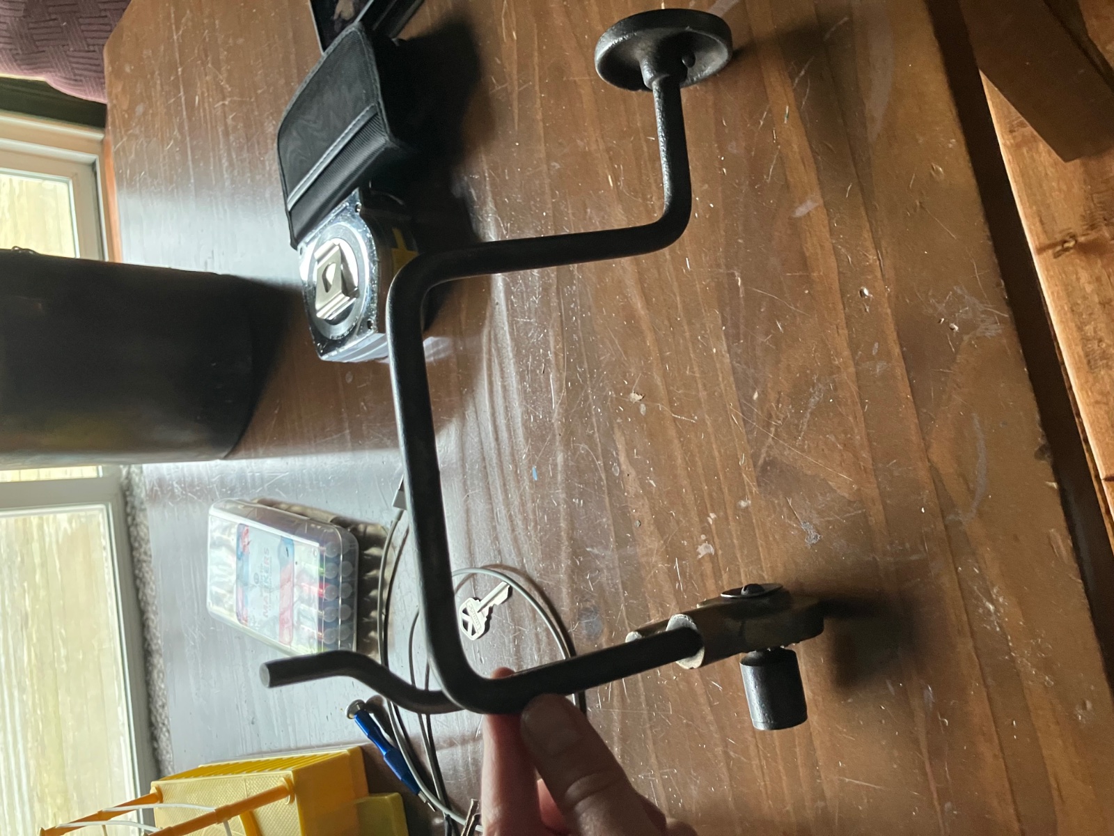

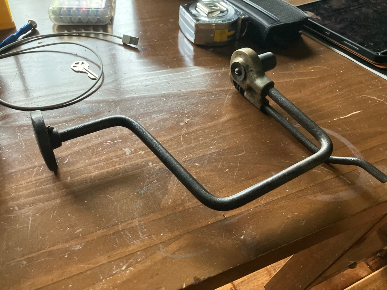

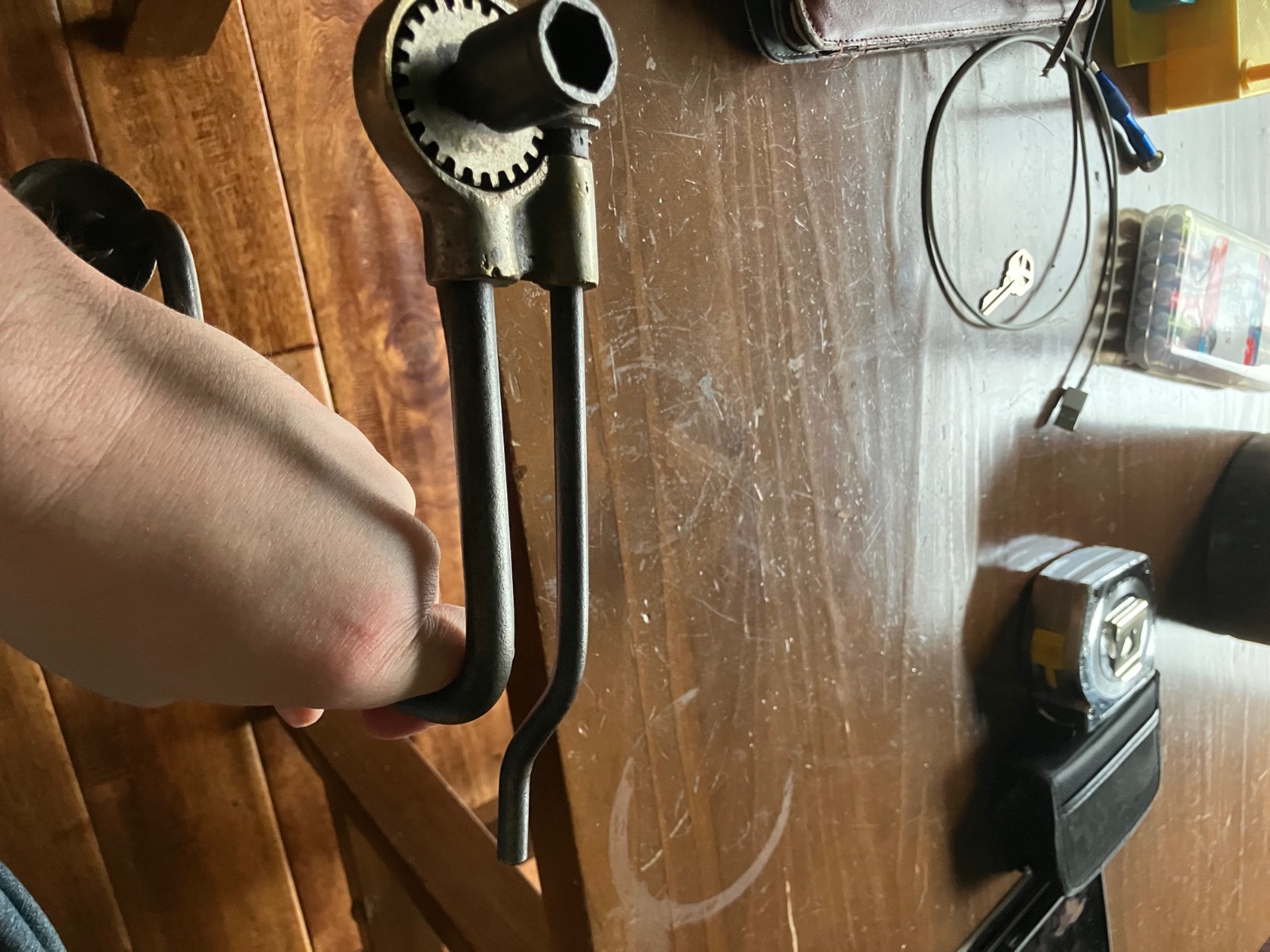

Someone gifted this to me thinking it was some sort of tool for a Model T oil pan drain plug…
I know that it’s not for that.
Anyone want to take a guess?

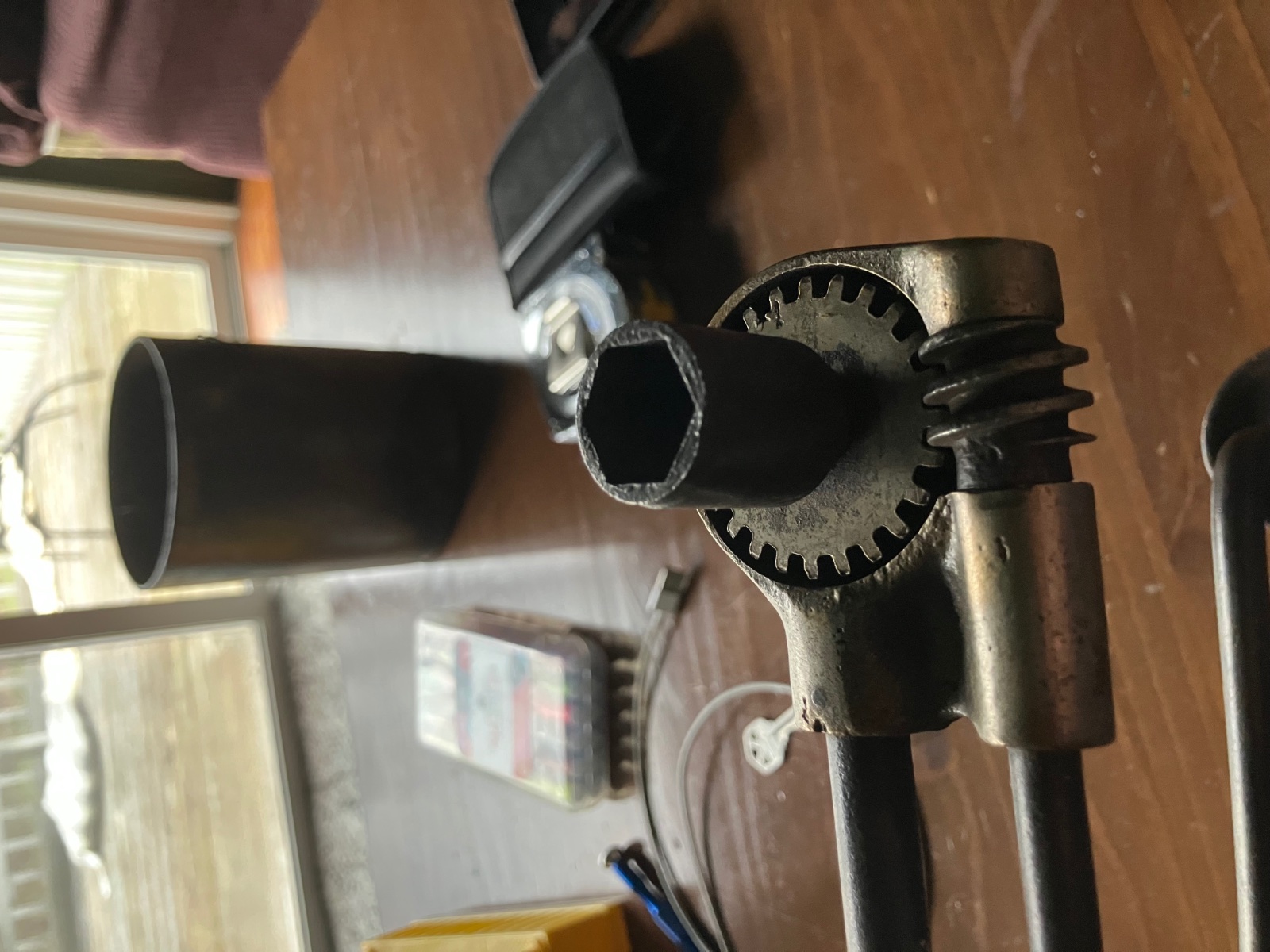

The socket is removable with a screw.

Interesting worm drive - what size is the socket ?

I have no clue, but whatever it is, it is very cool.

Any patent numbers or dates on the tool?

It is an aftermarket tool for removing and installing the nuts on the third main bearing cap on a 3 dip pan.

No one has stated the obvious yet - brace and bit.

Henry is correct.
