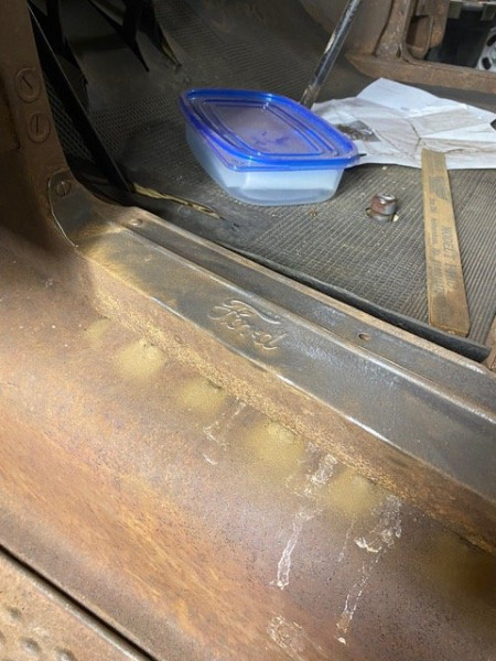

Re: 1926-1927 ROADSTER What do I have
Post by Norman Kling » Sat Apr 05, 2025 5:33 pm
Two easy ways to tell them apart. The front door posts on a 26 are offset at the top for the front of the door. The 27 go straight up. The door sills on a 26 have an aluminum plate with the name FORD on them. The 27 does not have the plate. The name is right on the steel sill.

Post by 36mike » Sun Apr 06, 2025 10:50 am
Thanks for the comments
Here are some pictures of the sill.

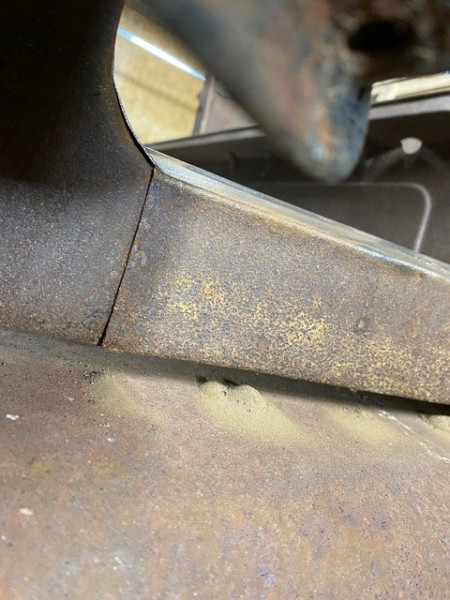

36mike
Posts: 40
Joined: Thu Apr 03, 2025 8:04 pm
Last Name: Russell
* REQUIRED* Type and Year of Model Ts owned: 1926 Runabout, 1922 Pickup Express,
Location: Columbia Missouri
Post by 36mike » Sun Apr 06, 2025 10:55 am

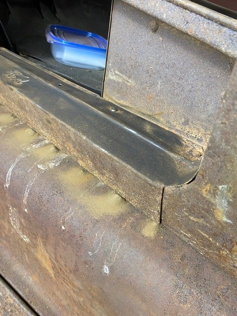

Post by 36mike » Sun Apr 06, 2025 10:59 am
36mike
Posts: 40
Last Name: Russell
Post by 36mike » Sun Apr 06, 2025 11:15 am
Well clearly, have some learning to do with regard to adding photos to my posts.
I think the body came with doors but that was a long time ago and other projects since then have brought about the mixing of parts and pieces. The doors have the tall latches.
I had gathered a few doors, over time and when I was adding doors to the body, I tried 2 or 3 on the drivers side before I found one that fit properly. It was, of course, the worst one of the lot, (with requisite bullet hole). The non fitting doors were fine except that they did not hug the body at the lower rear corner. Both(?) of them hung out 5/8 or 3/4 of an inch. To correct this, I would think that I would have to twist the door which would mean the skin would need to slip a bit on the door structure. They seem much too stiff for this to occur.
