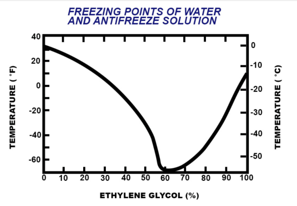

100% antifreeze is counter productive
Choose by your winter freeze

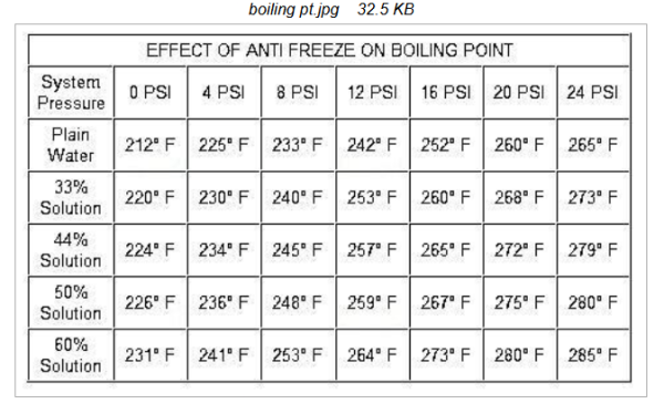

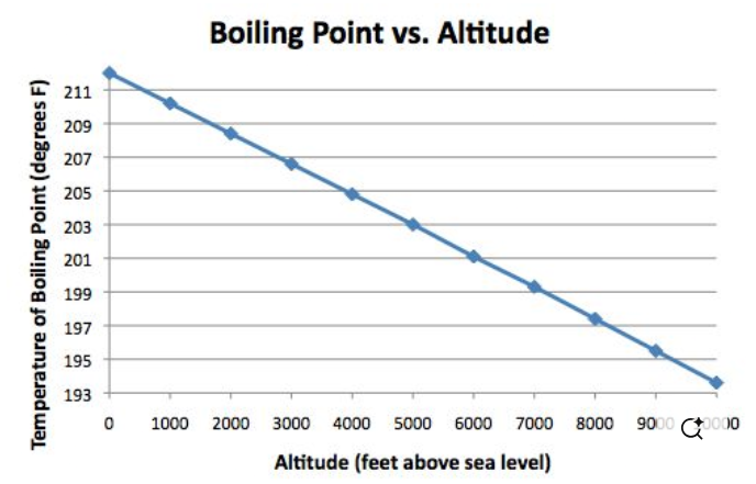

Pick your boiling point based on altitude
For Boiling point in an unpressurized system
At sea level a 50% solution raised the boiling point 14°F. At 4000ft the boiling point is 205°F so raising it 14°F would need just a 33% solution.
So at higher altitudes, where air pressure is lower, the boiling point of water and coolant mixtures can be lower. Then you don't need to use as much antifreeze to achieve the same boiling point elevation as you would at sea level BUT the higher you go the colder the winters are so you need a higher ratio to prtect from freezing like 50/50 :lol:
