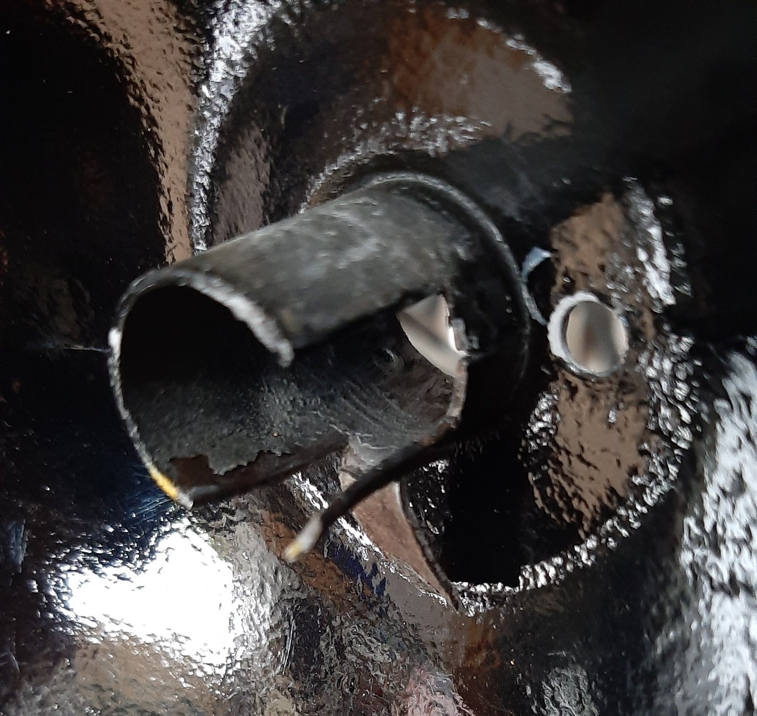

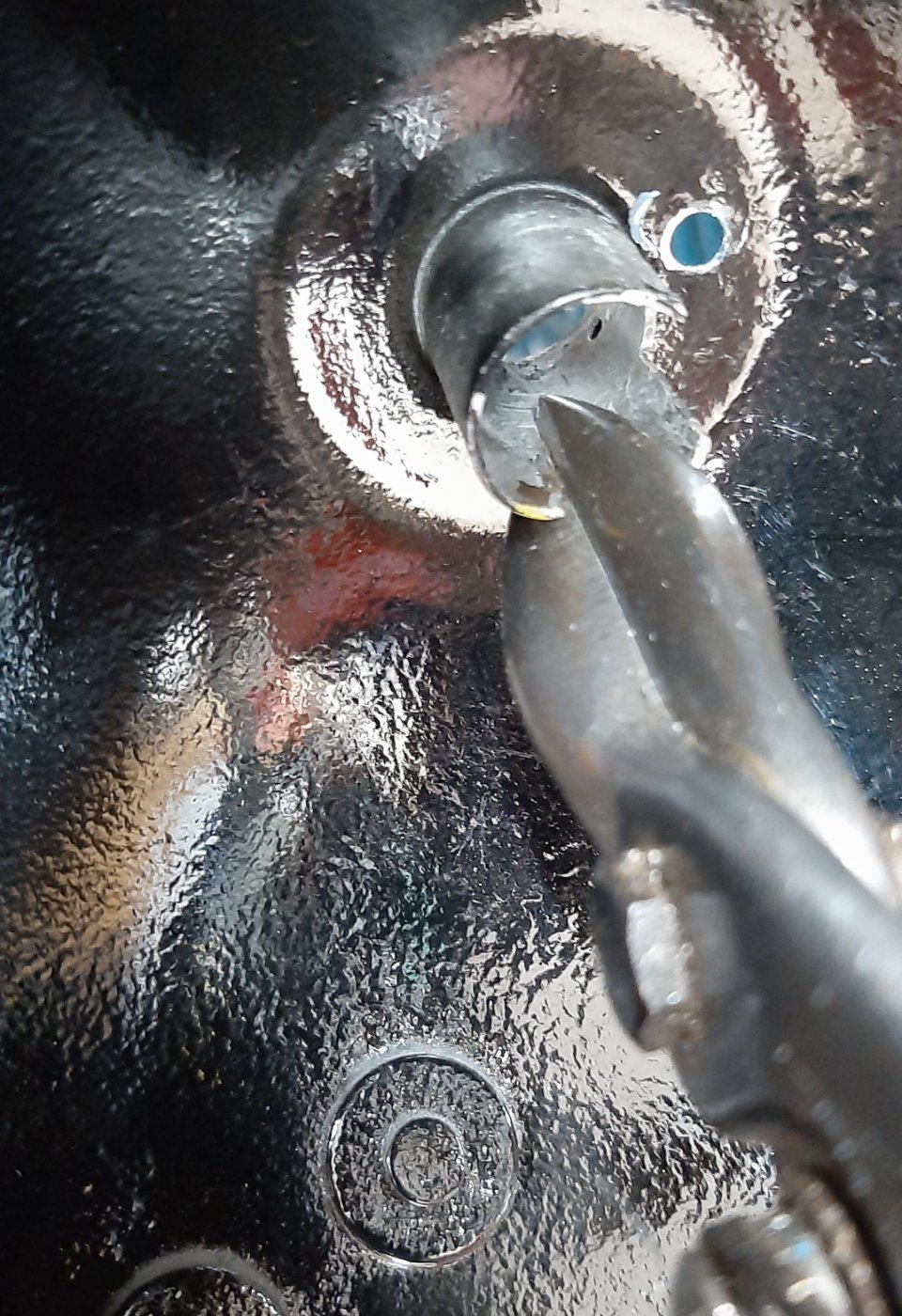

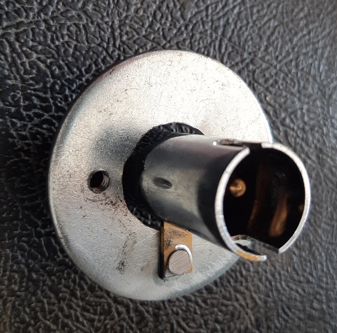

The way to get the lights to project up and down is to turn the socket holder 90 degrees in the headlight bucket. I wasn’t willing (or able - I did try) to turn the socket holders in my nicely painted headlight buckets. So I came up with another plan.

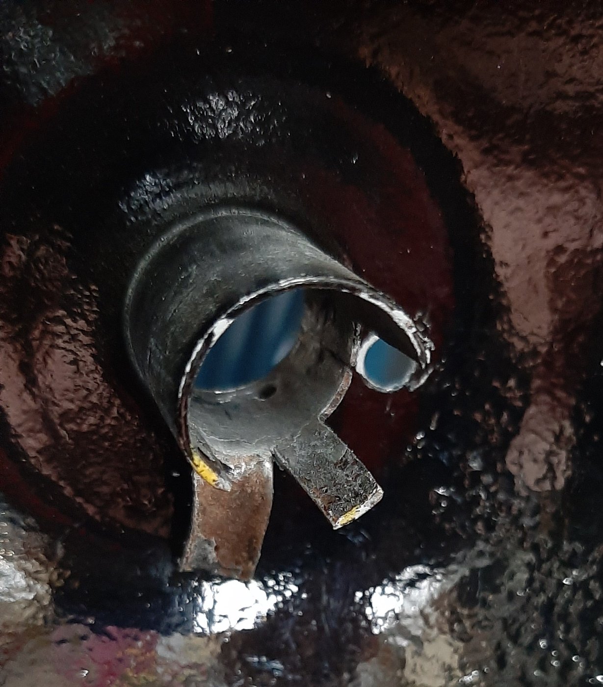

I took a pair of tin snips to the socket holder and cut a new slot at 6 o'clock for the bulb socket tab to slide into, and just bent the cut material downward without even cutting it. Just as a reference, the original slot is at 3 o'clock when viewing the headlight from the front. The rear area of the socket holder gives plenty of support, so even after cutting out the new slot, there is still plenty of surface area.

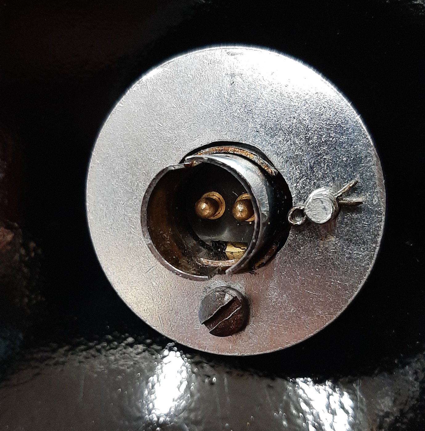

I wanted to maintain the adjusting screws in their original positions. I took a large washer with the hole adjusted to fit over the socket holder, drilled a hole aligned with the adjusting tab threaded hole and screwed the washer tightly up against the adjusting tab, using some thread lock for good measure. The screw was ground down so as not to interfere with the socket sliding adjustment for focussing purposes.

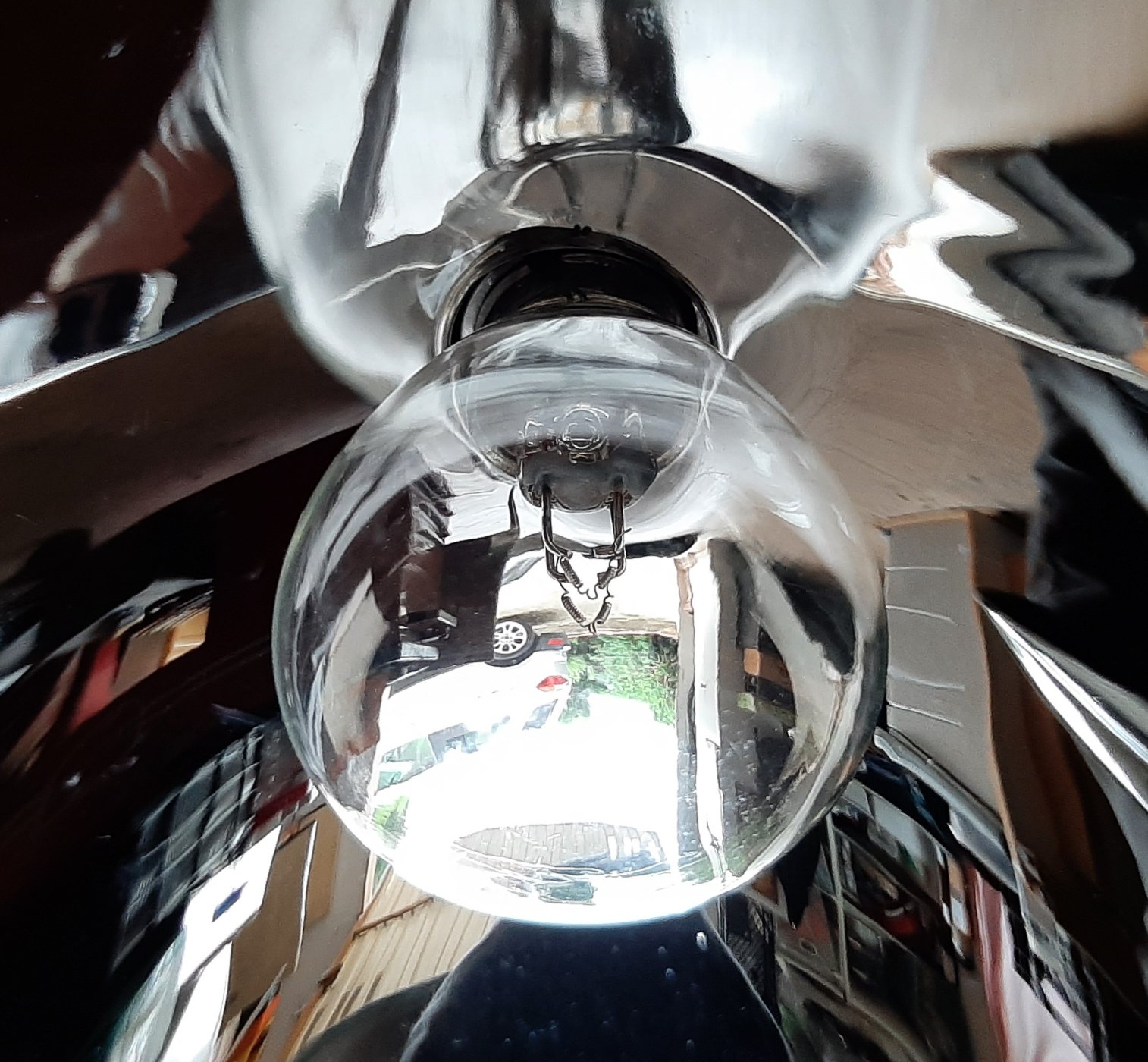

From the outside, the headlight is just as original, but the socket now has the bulb tabs oriented vertically, so the modern bulbs have their filaments one over the other. My lights now have true Lo & Hi beams that move vertically.

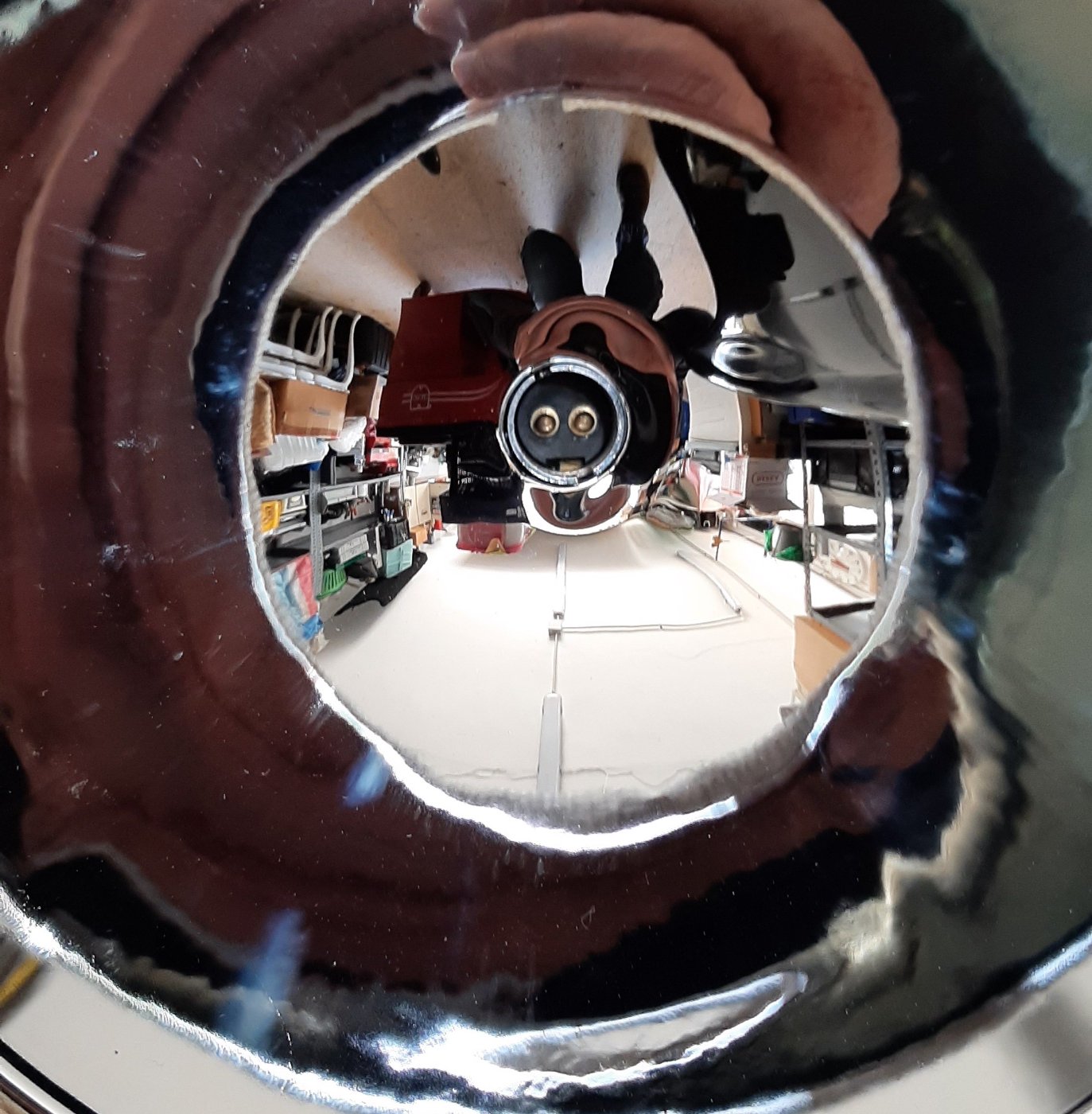

New horizontal orientation of the bulb contacts.
New vertical orientation of the filaments.

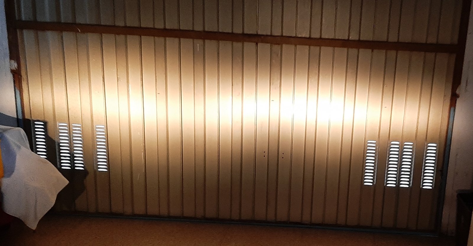

Using 50/32 CP incandescent bulbs:
Low beam
High beam
