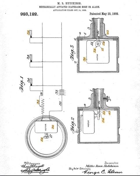

Have the Klaxon #3 on the '23, is the top push version, bracket mounts to the arm rest wood. The return was limp, so added a coil spring under for boost...very loud Ahooga
And here are the patents (filed in1906 and granted 1909) of Miller Reese Hutchison, for the elec. version.

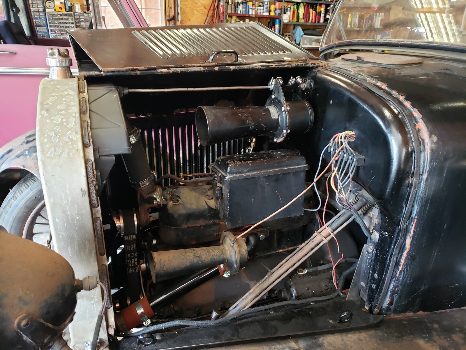

I mounted mine on the radiator to firewall rod on my 26 Touring as far back as possible. I kept the original sick goose horn as well. I ran a 2 pole switch with a bracket that clamps to the lower lip of the dash. No holes drilled. I can now switch to whichever I want.
Using the bracket that came with the horn, I used small stainless shelf L brackets and cable clamps to adapt to the rod.

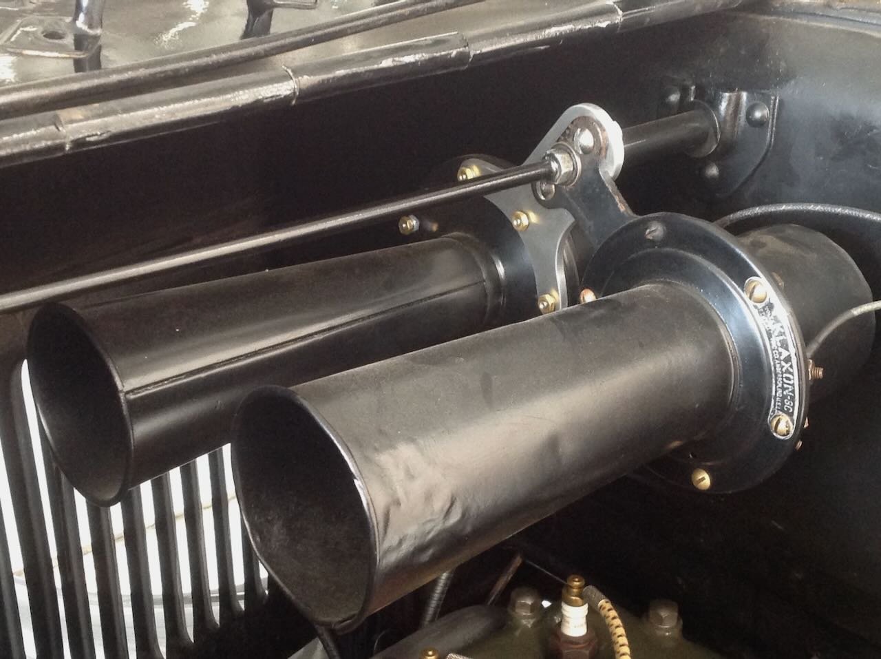

This was my dual horn setup on the '26 runabout. Used two T horn buttons on steering column for choice of horn.
Ford horn bracket fabricated from 3/16" aluminum flat stock.
