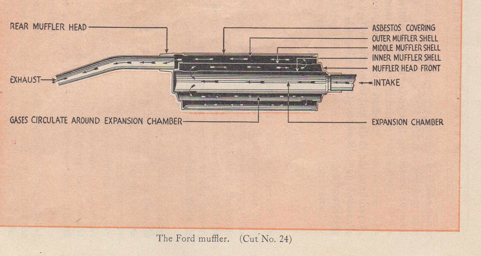

The earlier mufflers up until some point in the very late '10s had a shorter head-pipe and just slid inside the front of the assembled muffler mounted by two bolts to the rear of the frame rail. This arrangement tends to rattle quite a bit, and some people use a variety of copper wire or brass shim gimmicks to reduce the rattling.
Later mufflers, the majority of production from somewhere around 1919 onward, had longer head-pipes which the muffler was assembled onto the head-pipe itself. They bolted with one bolt at the rear of the frame rail as the longer head-pipe provided the front support to the muffler.
The muffler shown in the diagram posted by Kerry is an early style. Later styles did NOT have the tail pipe on the back end as shown in the diagram.

Post by Kerry » Sat Jun 29, 2019 5:37 am
Found it in the parts books, the longer pipe in 1921, now I have to say I would and don't have any faith in clamping the muffler on a short engine pipe and relying on just a rear piece of tin bracket to hold it all up.
Reason for saying that is I had such a configuration on one of my T's and on a run it broke also taking out the brass flange nut as well. Wired it all up and tried for home, some miles later the fire wall was glowing. it made a good story for our club mag, someone with a little imagination had said I pis#ed on it to put it out but it was realy a can of degreaser (water based)

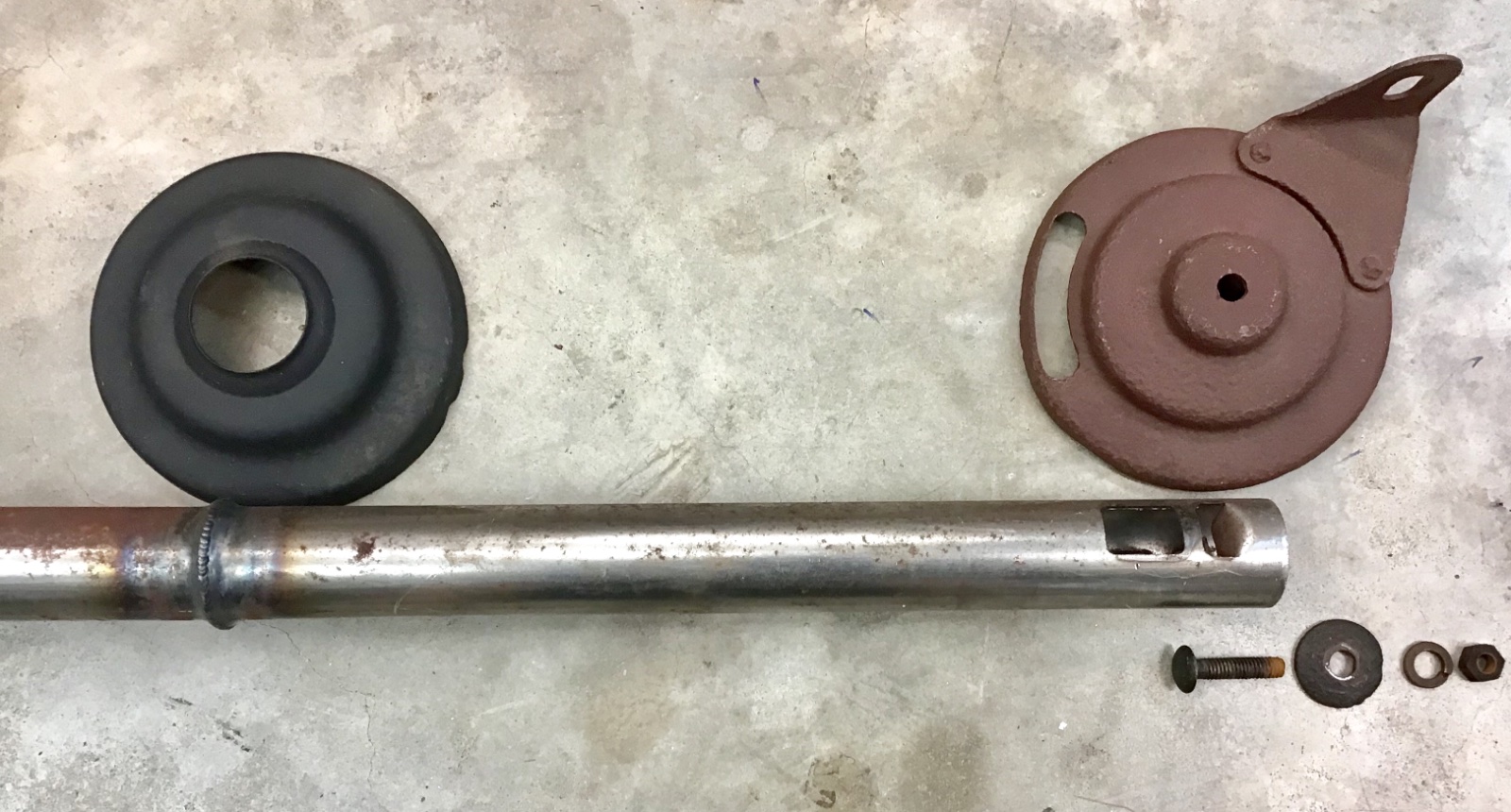

Fordfarm
Posts: 23
Joined: Sun Jan 06, 2019 11:07 am
First Name: Phil
Last Name: Mino
Location: near Porterville
Re: Muffler mounting.
Post by Fordfarm » Sat Jun 29, 2019 8:15 am
Posts: 4109
Post by DanTreace » Sat Jun 29, 2019 9:05 am
Phil
Nice tooling!
Makes a real good roll just like original ‘21-‘27 exhaust pipes.
Here’s Orininal Smith’s first rendering I have with a welded ring for a stop. Your work is amazingly good.
Just needing the muffler shells to complete the exhaust system.

Post by Original Smith » Sat Jun 29, 2019 9:27 am
I had 50 of those made a few years ago. They all sold in a week! It's too bad someone with some bucks can't make them again. They used them from 1921 on. If Ford could do it, it can still be done. I have a NOS exhaust pipe, and it has the Ford script every 18".

Post by Original Smith » Sat Jun 29, 2019 9:36 am
One thing I just noticed, Dan didn't post the bar that goes through the last two slots that the carriage bolt goes through. The part number is 4032. Ford made two styles of these. The early ones were a channel, and the late ones were a simple bar. Bob Bergstadt used to have these, and probably still might?

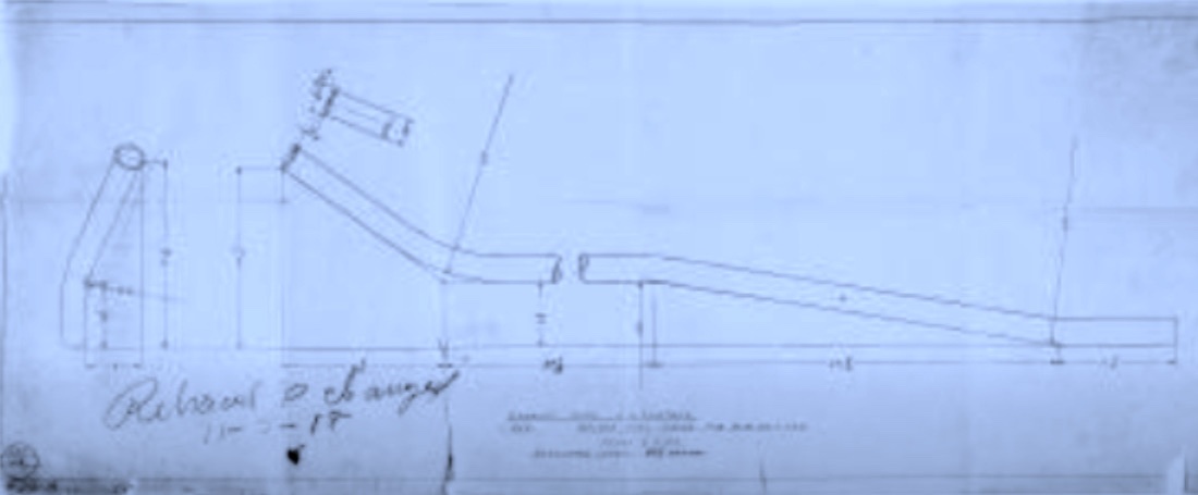

Factory print
