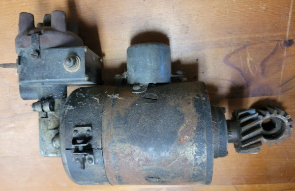

Does anyone know about this setup? I just won it on eBay. Not a lot of info in the listing.

Interesting find! The mid 20’s Chebby had a dizzy on the back of the genny similar to that. Don’t recall the funny shape dizzy housing tho. Be careful with the drive housing as many are pot metal, so possibly very delicate

For the distributor to time correctly there must be some gear reduction built in. There are less teeth on the generator than the crank gear, making the generator turn faster than crank speed.
EZ check. Watch the rotor as you turn the gear. it should turn less than 1 revolution to one revolution of the gear if my math is correct.
You could have something special here or an experiment that didnt work out.

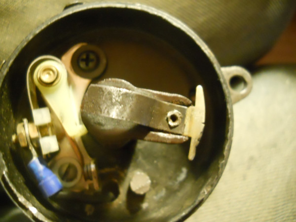

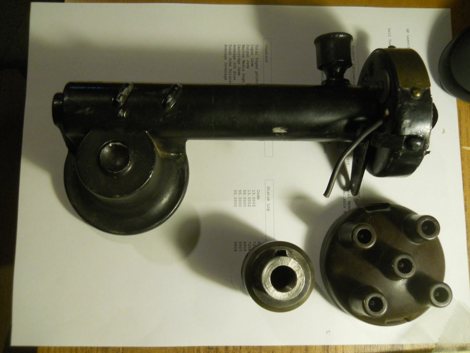

I have had one of the Ignitor distributor for years. It was missing the part the cam gear fits onto the camshaft and holds it in place. I will have to go look now and compare caps, but offhand I think it might be smaller.
Dan thank you very much for posting those.
Here is the one I have. The cap looks really good and rotor not too bad, hope they are the same. Someone replaced the points with modern ones. I had made the part that holds the driving gear, which is threaded and still needed a keyway cut and hole for pin to lock on the camshaft but don't know how well I got everything centered, was one of my early lathe projects.

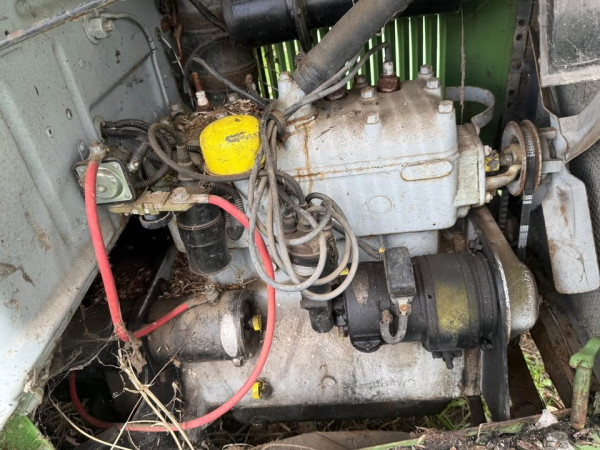

That is a really cool find!! As mentioned above, this was a common arrangement on several makes of the era. 1925 Chevy had this setup plus the oil pump added onto the rear.

Same arrangement on my 29 buick

Post by Mark Gregush » Sun Jun 29, 2025 11:11 am
Got it on Saturday. Looks really good inside even the distributor gears had good grease in the housing. The gear on the gen. shaft is 4 tooth and the one on the distributor is 12 so 3:1, with the generator gear being the same count as stock.
I put it on the KRW test stand and out of the box was charging as about 7-8ish amps.
The cap from my other distributor fits as does the rotor. The only difference in the two rotors, the end that sweeps past the terminal is a little wider on one then the other.
Going to remove the brush end cap, give a good clean and figure how the 3rd brush moves and check on the growler, paint and install. :)

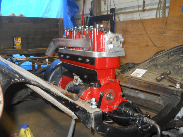

To save it at this point will need to get a new gear made and am going to modify a Ford Model A distributor to fit. The machined part is just a little smaller in diameter, but the length is pretty close.
Love the coils and all that, but with the coil box mounted on the head like 26/27 no room with the Chevrolet overhead and can't mount on the firewall. For now, see my post in what have you done in July about the Bosch 600 I mounted.
