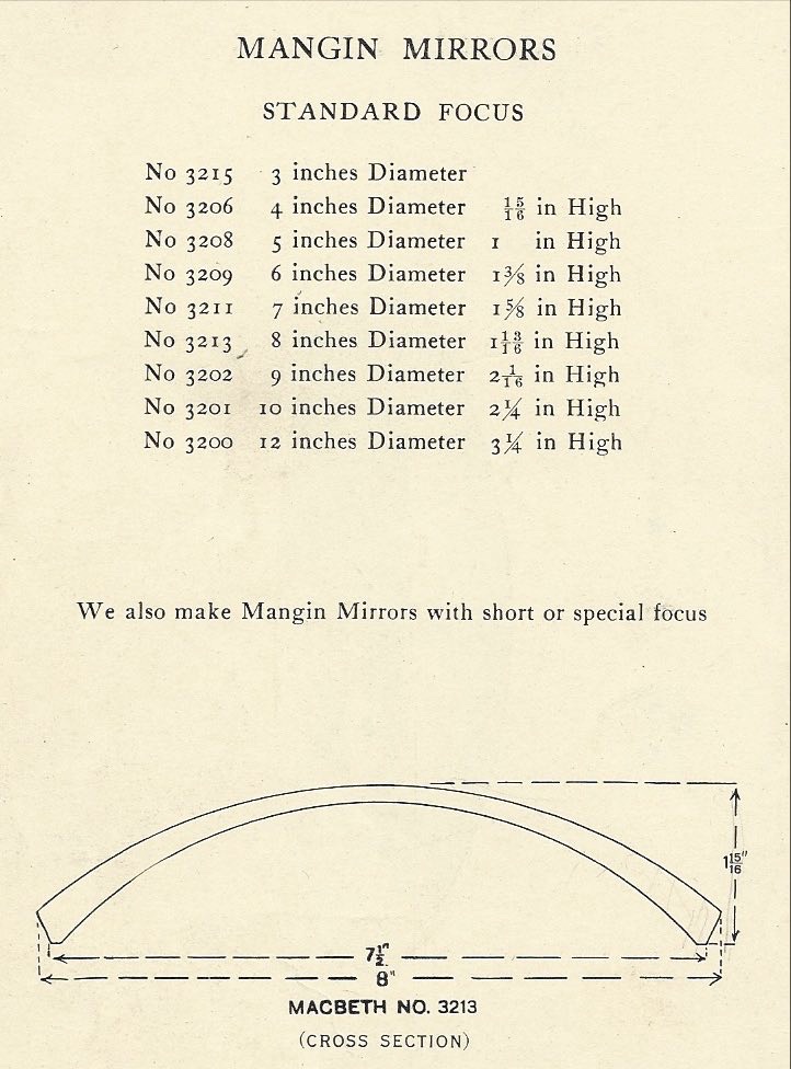

Here’s something interesting I ran across. It’s from Flivver Fanciers, November 1959 HCCA Omaha club newsletter.

I believe that all Model T gas lamps used 6" reflectors, just different focal length ( different glass curvature).
There are 5 1/2" reflectors but they did not come on Ts.
