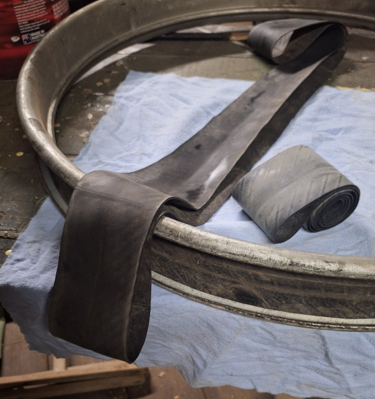

Just yesterday I picked up three used 13" inner tubes at my local tyre shop. Three re-usable snap fit rim liners for FREE!
No fitting hassles
No bulk weight added
No chance of them moving .
No beautiful tariff to be paid.

Allan has the right idea for liners.
Flaps? If your rims are good enough, why waste the money?

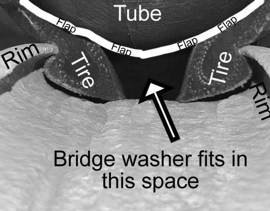

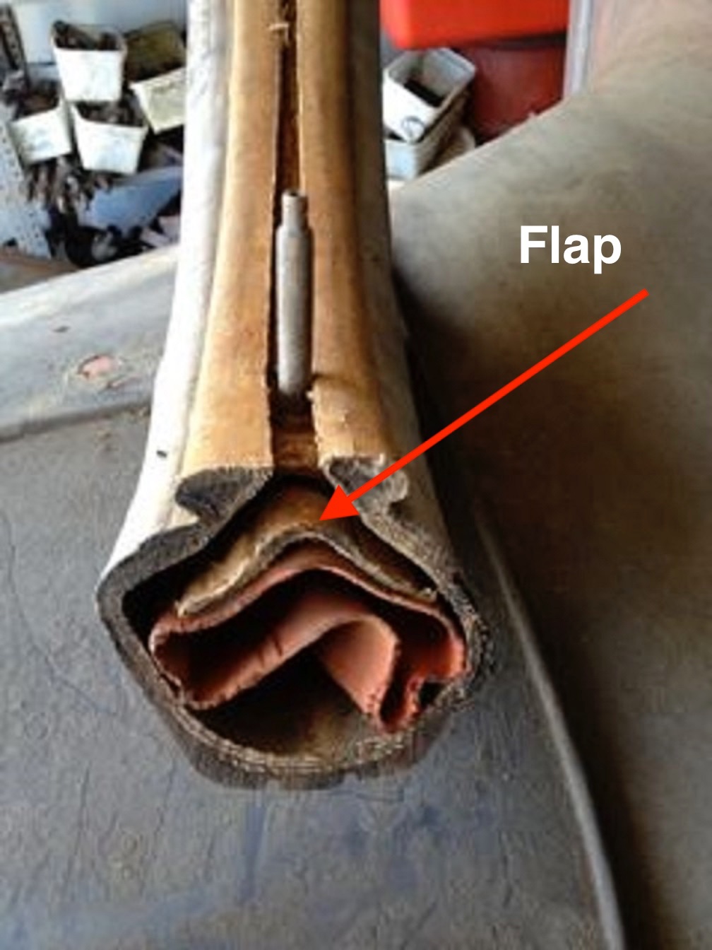

I like flaps... my current rims are a little rough on the inside which seems pretty normal. I ordered the latest flaps for a pair of brand-new rims along with new T-Drivers, Blockley tubes and balance beads......The new rims, tubes, flaps and tires will replace a set whose tires still have some tread (@12000 miles) which I will keep as spares.
I recently replaced my rear tires after 11000 miles, 8-9000 of those miles on Blockley tubes. After inspection the tubes were in near-perfect condition so I felt confident re-using them. My take on flaps is not only do they protect the tubes in general, but they keep them from bulging down between the bead edges of the tires. Running at 60-65 psi, I would think the tube would otherwise try to push in between the beads (see illustration) which it would have to do in order to contact the rim. Tubes rubbing against the bead edge is probably not a good idea either. I also prefer to use a bridge washer, thinking it cheap insurance. I may be all wet in my assessment but like many hypotheses put forward on this forum my conclusion is not backed by rigid research, only my suspicion of how things would work. FWIW - in 12000 miles the only flat I've had was from a roofing nail.

Every flap or tube only tire I have removed had that flap or tube down between the bead gap onto the rim. A flap wont bridge between the beads when aired up as your illustration shows.

The illustration from drobnock shows what I believe is a rim liner, which is much thinner material and fitted tightly against the rim. The flaps I've used are pretty thick and don't extend much into the gap between the beads. Regardless, the tubes show no wear marks after thousands of miles. Hey, to each his own :)

Tim's illustration is just that, an illustration. If you believe that the bead on the tyre is not driven hard into the bead on the rim under 60 psi pressure, I have a bridge I can sell you. If you believe a a rubber flap is not driven hard down onto the rim under that same pressure, I can supply an aircraft carrier to sail under the bridge. I have no idea if either the bridge or aircraft carrier would attract a beautiful tariff.

Last week I changed a tube with a flap & saw just that. Again. Both, the tube & flap contoured down between the beads.

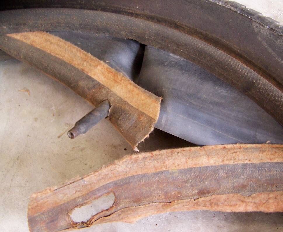

The old time flaps for clincher rims were either very thin more like liners, or more robust ones and thicker.
What is today a clincher flap is rather more thick, stiffer, and bit wider. IMO they are ok to use, only time had a struggle was with a 30x3 size, the 24" flap and tube fit, little more tire tool work though.. (BTW, a flap was std. Ford issue for 21" split rims, as the split and lock fitting rivets have to be covered with a flap to protect the tube.)

Post by Allan » Mon Jul 07, 2025 8:08 pm
Dan's photo of the old time flap is revealing. Even this tough old fibre reinforced flap and the tube, have clearly been driven down to the rim base. It also shows that it is unnecessary to notch the bead to fit the valve stem.
