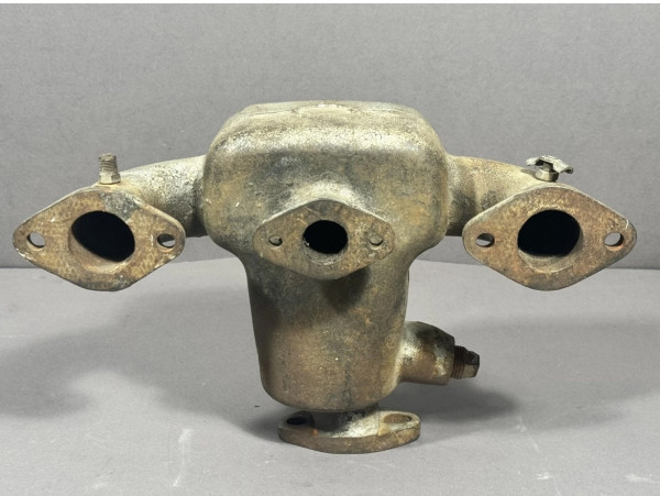

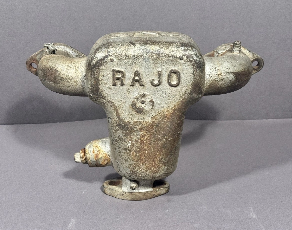

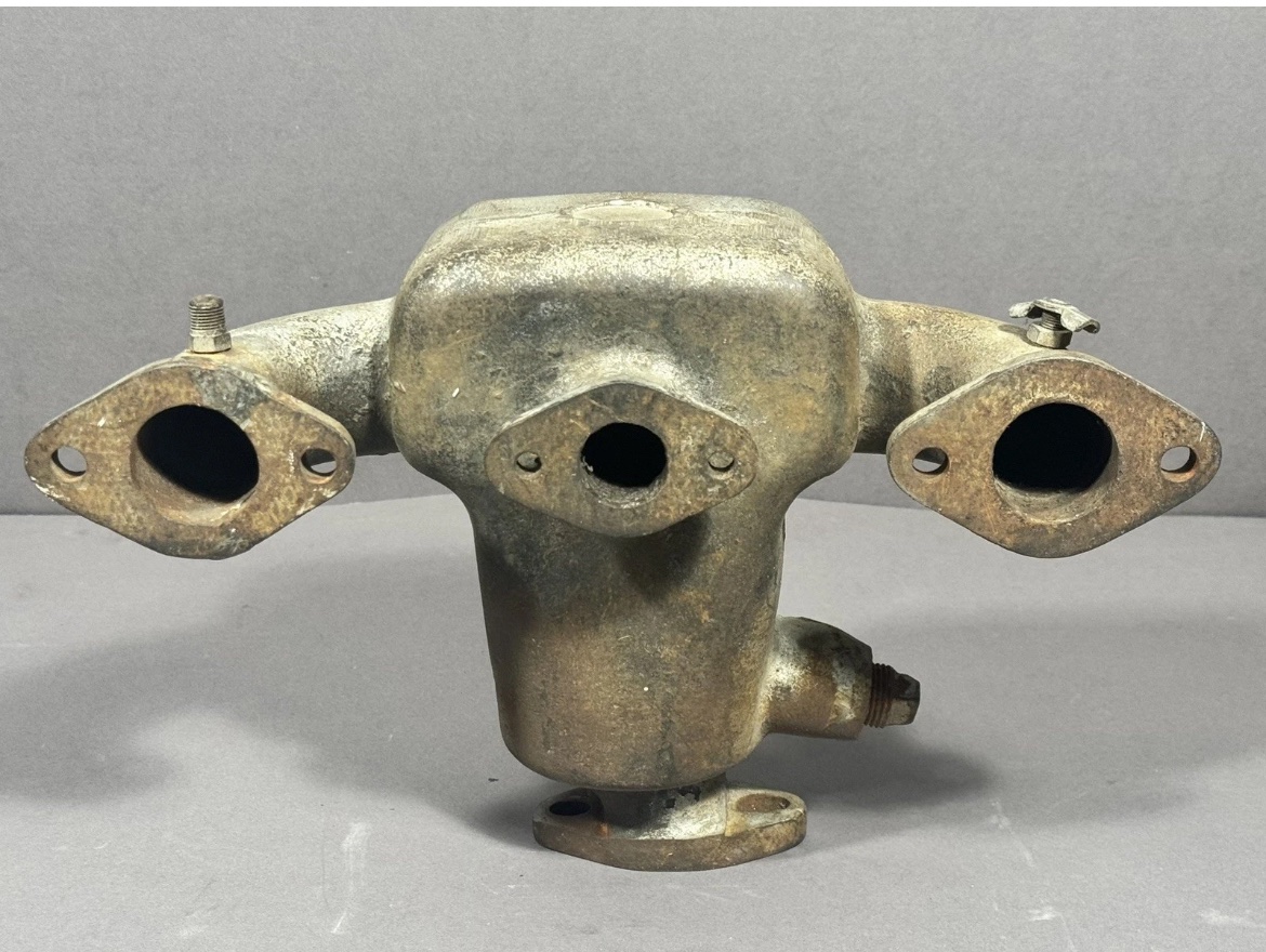

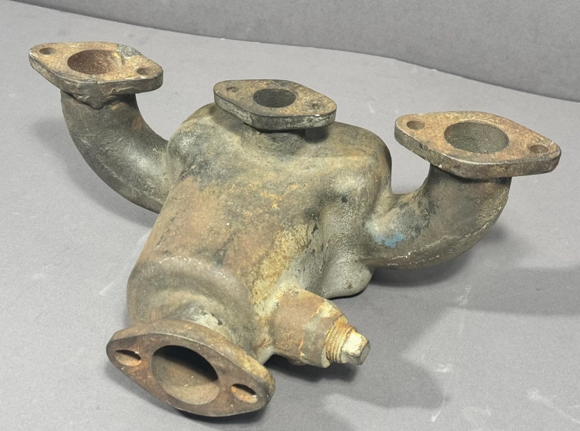

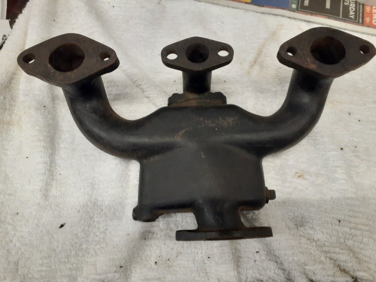

For you Rajo guys, saw this on Tbay would this really fit a T?
Posts: 1967
Last Name: Tannehill
Location: Hot Coffee, MS
Board Member Since: 2002
Post by JTT3 » Sat Jul 05, 2025 11:39 pm
I have no connection to the part or seller but was curious about the number of intake ports & wondered how this would adapt to a T. Did Rajo have a 3 port head assembly for a T? Best John
https://ebay.us/m/UveM2n
Kevin Pharis
Posts: 1656
First Name: Kevin
Last Name: Pharis
Location: Sacramento CA
Re: For you Rajo guys, saw this on Tbay would this really fit a T?
Post by Kevin Pharis » Sun Jul 06, 2025 12:11 am

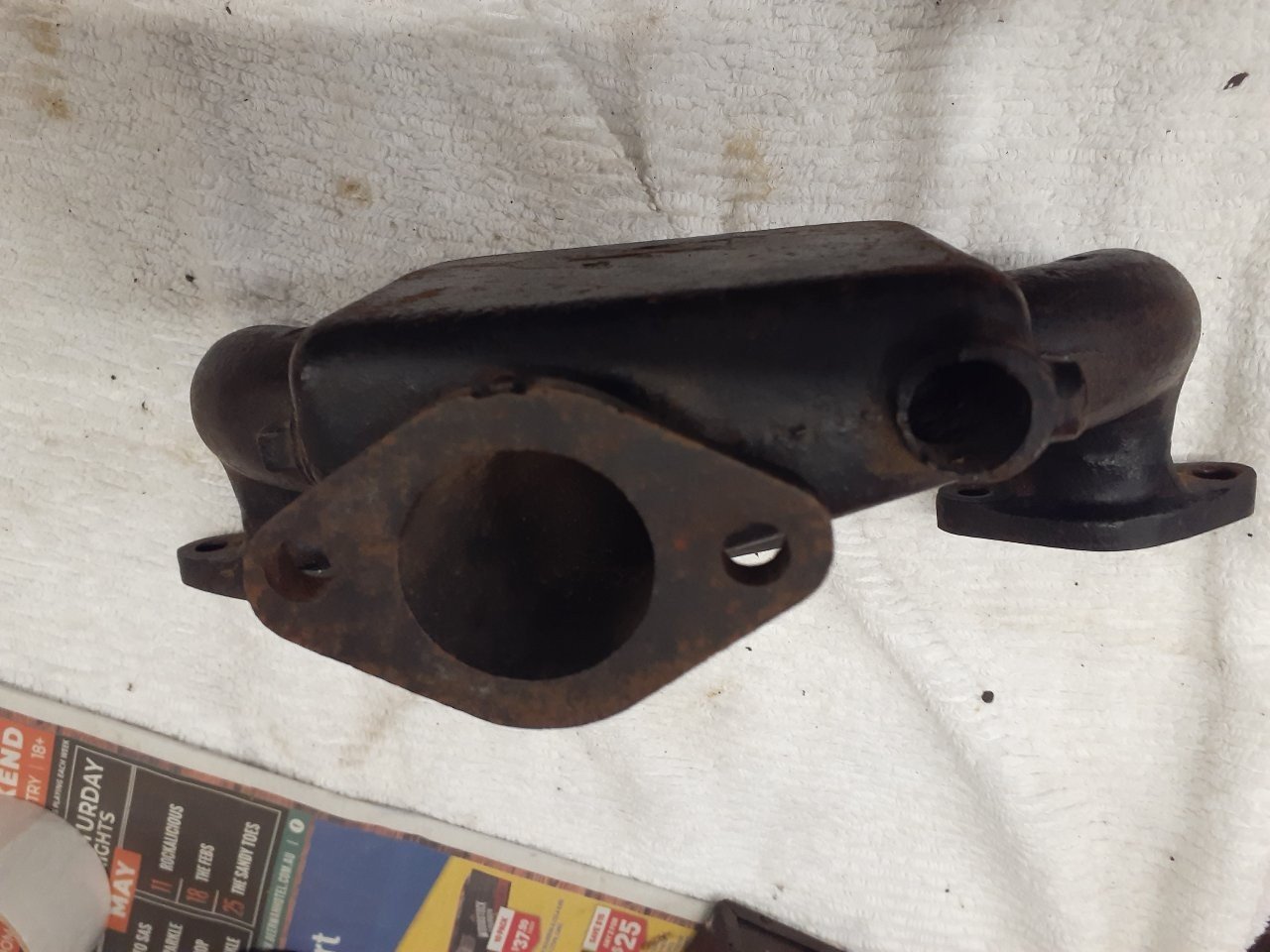

The center port is open to exhaust gasses to pre-heat the manifold
Posts: 4472
Post by Jerry VanOoteghem » Sun Jul 06, 2025 6:55 am
Are you certain it's exhaust gasses and not coolant? The pipe thread port at the bottom makes me wonder if it's a coolant return port.
Posts: 5591
Post by RajoRacer » Sun Jul 06, 2025 11:17 am
I run a BB - it's an exhaust port !
Posts: 4472
Post by Jerry VanOoteghem » Sun Jul 06, 2025 1:26 pm
Okay ! Thanks !
