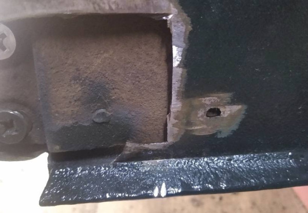

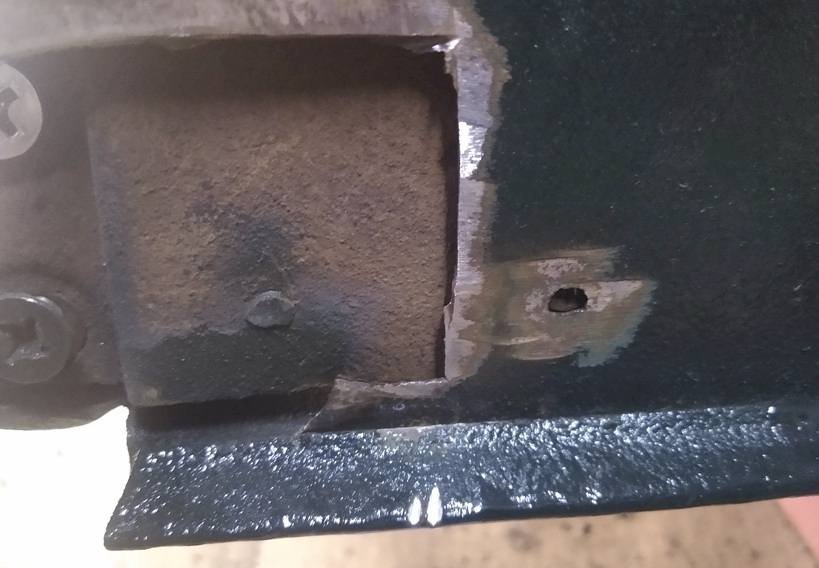

Upon repairing the Coupe passenger door, i noticed what looks like two spot welds.
The outer green skin had two round holes which I figured were just rust holes but when I removed the really bad part, I found that the inner structure had separated from the skin. So, I was wondering, "Did Henry start using spot welds late in T production?" Then I remembered that the driver door came from a Model T donor but the passenger door came from a Model A truck. Perhaps someone else knows.

I have looked over my late '27 T quite carefully, and the only weld in the car that I could find was on the battery rack. I had done the welding as a repair to it.

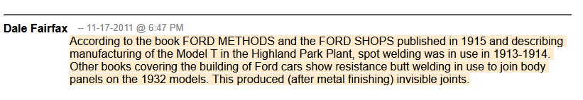

Yes. Ford was electric spot welding since at least 1913.
Mostly fenders then, but when body builds were in house, lots of spot welds were used.
Ford Methods and the Ford Shops
The Ford Industries booklet

Oh yeah, lots of spot welds on my 26 Coupe body. Cowl to firewall, trunk lid skin, etc. etc.

Thanks for the responses. I fixed it with three plug welds.

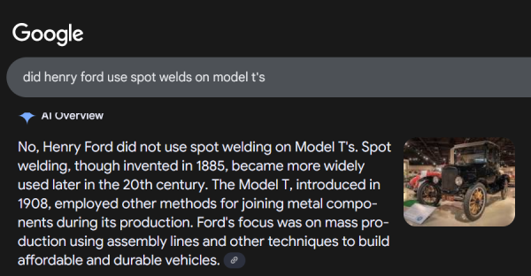

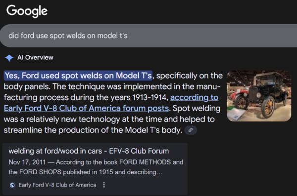

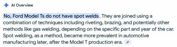

But you're gonna luv what A.I. has to say:

"AI" equals automated incompetence or automated idiocy. Google was always questionable in its quick answers, however, in the past year they have become laughably unreliable.
Yeah, Henry used electrical spot welding going way back.
