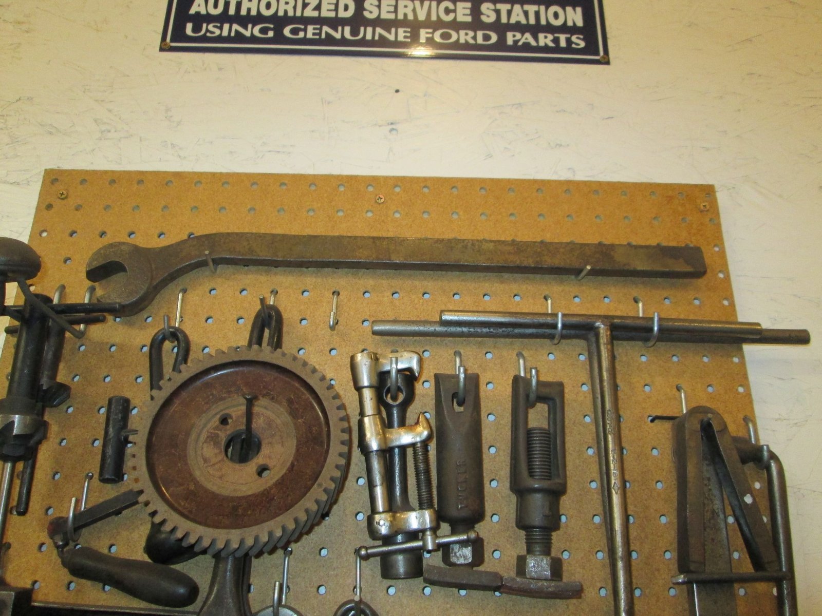

Didn't Ford offer dealers a special axle nut wrench about 2 feet long? I'd guess that would translate to about 100 ft lbs.
Posts: 5469
Re: axle torque
Post by RajoRacer » Tue Jul 29, 2025 12:27 pm
Yes, they did - I can post a photo later today - mine was nickel plated as are some of my other "factory" wrenches.

For your viewing pleasure - it's approx. 20" in length.

Steve, I like your display. Some day when I move back north I'm hoping to have a larger garage and I want to set up a board like yours with all my specialized Ford tools. Thank again everyone for your help.

20" wrench, 165 lb mechanic....

I'm surprised that the rear axle nut "Z" wrench is open-end.
My father has a TT rear axle nut Z wrench and it is box-end. It also has a round handle which is easier on the hands.
Posts: 5469
Re: axle torque
Post by RajoRacer » Wed Jul 30, 2025 10:37 am
Thanks Erik - I'll go check the numbers - that could be the rear perch nut - I have more !
