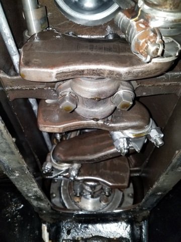

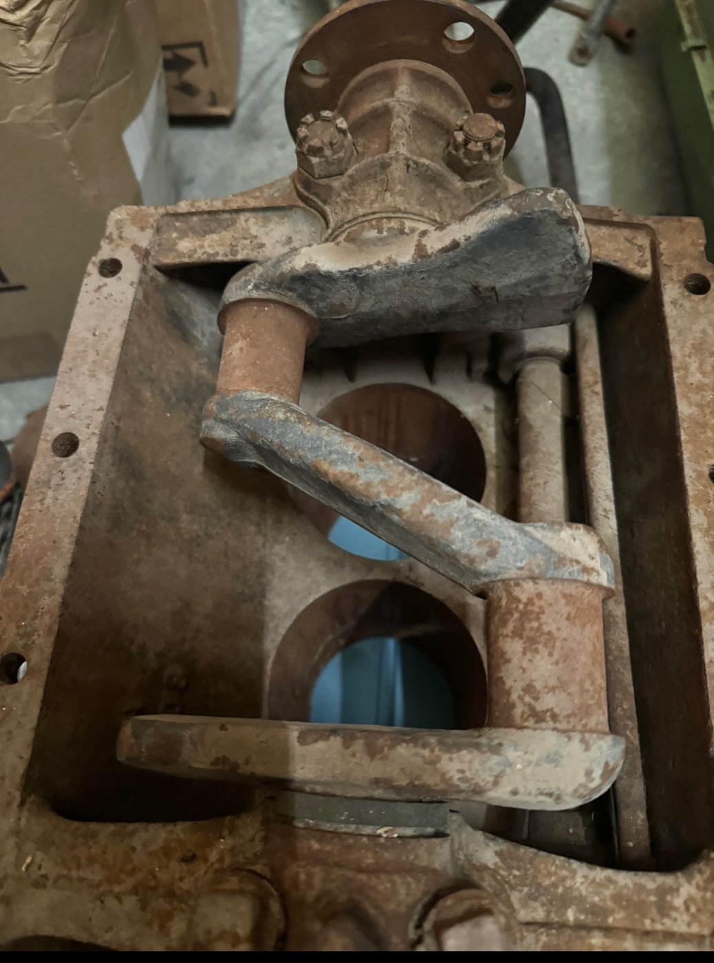

Can anyone identify this crankshaft
Post by 26-Roadster/pu » Thu Aug 07, 2025 4:27 am
This crankshaft is in a 1927 block I want to rebuild. 14,719,XXX
I have an EE crankshaft I was going to use. But I’m curious if the crankshaft currently in the block would be a good choice to use?
Can anyone ID it. Thanks for any information you might have on it.

Re: Can anyone identify this crankshaft
Post by Dodge » Thu Aug 07, 2025 5:19 am
Looks like a Sure Mike. (spelling ?)
Post by speedytinc » Thu Aug 07, 2025 8:08 am
Yes, that's a "sure break" crank.
I had a mint STD/STD in a motor I bought. Rebuilt the motor. Didn't make 100 miles.
My story is not unique.

Last Name: Gulbankian
Location: Massachusetts
Post by J and M Machine » Thu Aug 07, 2025 9:15 am

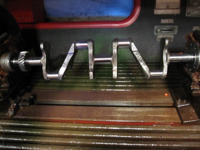

Shure-Mike:
I have to wonder if the cranks got a bad reputation because People just slapped them into engines with bent pans, bad clearance etc.
We have reused these crankshafts and they're still running today.
We have the ability to crack detect and straighten and remachine them properly .
Maybe this is why ours survive?
There was a couple that came from Eastern NY and the oil pan wouldn't even fit on our straightening table and their crank broke.
He said "Grandpa" didn't believe in straightening oil pans. This is what caused the crank to break.
Either do it right or do it twice.

I would have the crankshaft in the OP cleaned, dye penetrant tested, and magnafluxed before I would put it into an engine.

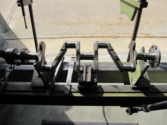

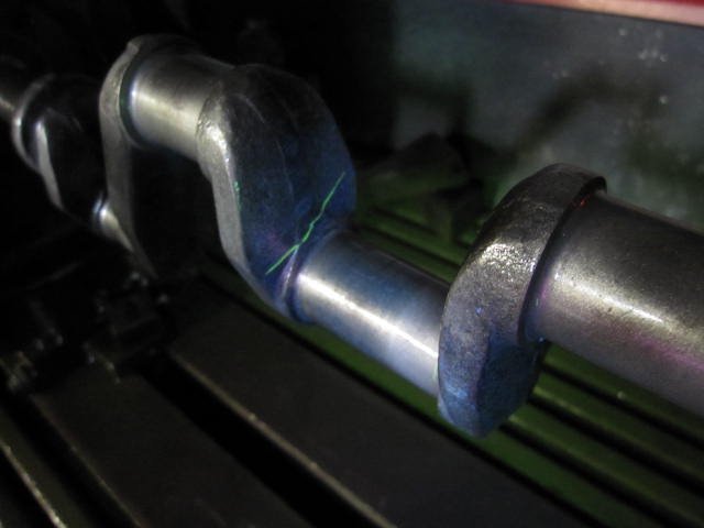

There's no need to have the crank "dye penetrant tested" if you are to have the crankshaft wet magnafluxed.
Wet magnaflux as I have shown in bottom picture will work better than the dye penetrant and is faster more reliable.

John, I will agree with you on the reasons for bad reputation, plus being a counterbalanced crank, possibly some "young bucks" who expected more speed out of a smoother running engine, pushed motors with Sure Mikes, too hard.

Standing in front of my magnaflux machine with the local T club present on tour of our facility, explaining what the magnaflux machine does.
I asked the club members how they check their cranks prior to rebuild as the other machine shop rebuilder was present .
They chimed in unison; "We hit it with a hammer and it'll ring" !
I did the same procedure with hammer in hand and our crank also rang like a bell. I placed it in the magnaflux machine and their mouths hit the floor as in this picture is what they saw. !
Just because it's an ABC, DB or even EE crank they all need to be magnafluxed. Just because it's EE doesn't make it unbreakable.

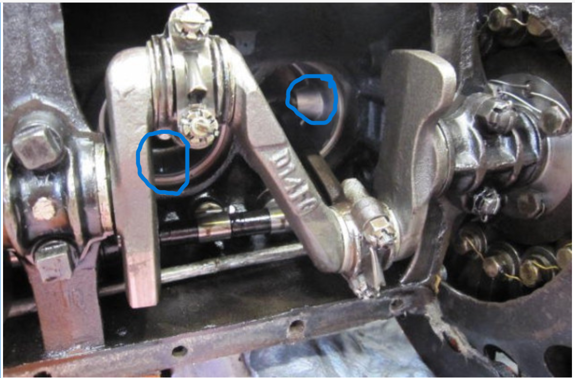

Post by Kerry » Thu Aug 07, 2025 7:05 pm

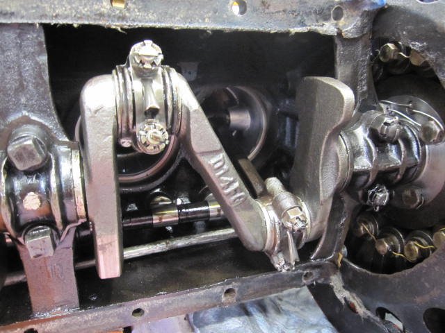

Ooops!! someone needs to pull the pistons on that block, split skirt is facing the thrust side of the bore and needs oil holes drilled for the wrist pins.

I think there are 2 different counter balanced crank made in the day. Sure Mike's have a bad reputation, the other 1 is very durable. I don't know how to tell the difference, but I have 1 that was on a originally on a overhead stick, that I now have on a OHV. It has suffered much abuse from me, and previous owners.
Steve, there have been many forum posts on Sure Mike crankshafts over the years. One of them I read, said that there were two different series of Sure Mikes, made: Sure Break and May Break (just kidding). Maybe Sure Mike realized they had a problem with the early cranks and, later in production, changed the metallurgy of their cranks to be more durable.

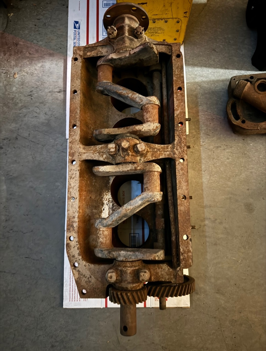

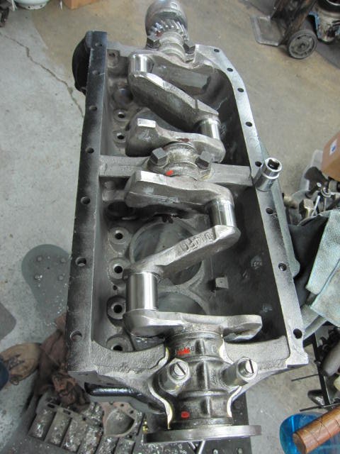

Posts: 4464
Post by Jerry VanOoteghem » Fri Aug 08, 2025 2:36 pm
ModelTWoods wrote:
Thu Aug 07, 2025 10:53 pm
got10carz wrote:
Thu Aug 07, 2025 8:13 pm
Of those two styles, I believe one appears to be heavier and more robust. One of each is shown in the various pictures, above.

Post by J and M Machine » Fri Aug 08, 2025 7:06 pm
Ooops!! someone needs to pull the pistons on that block, split skirt is facing the thrust side of the bore and needs oil holes drilled for the wrist pins.Screenshot (227).png
Yup this is how it came to us. fresh re-rebuild.
