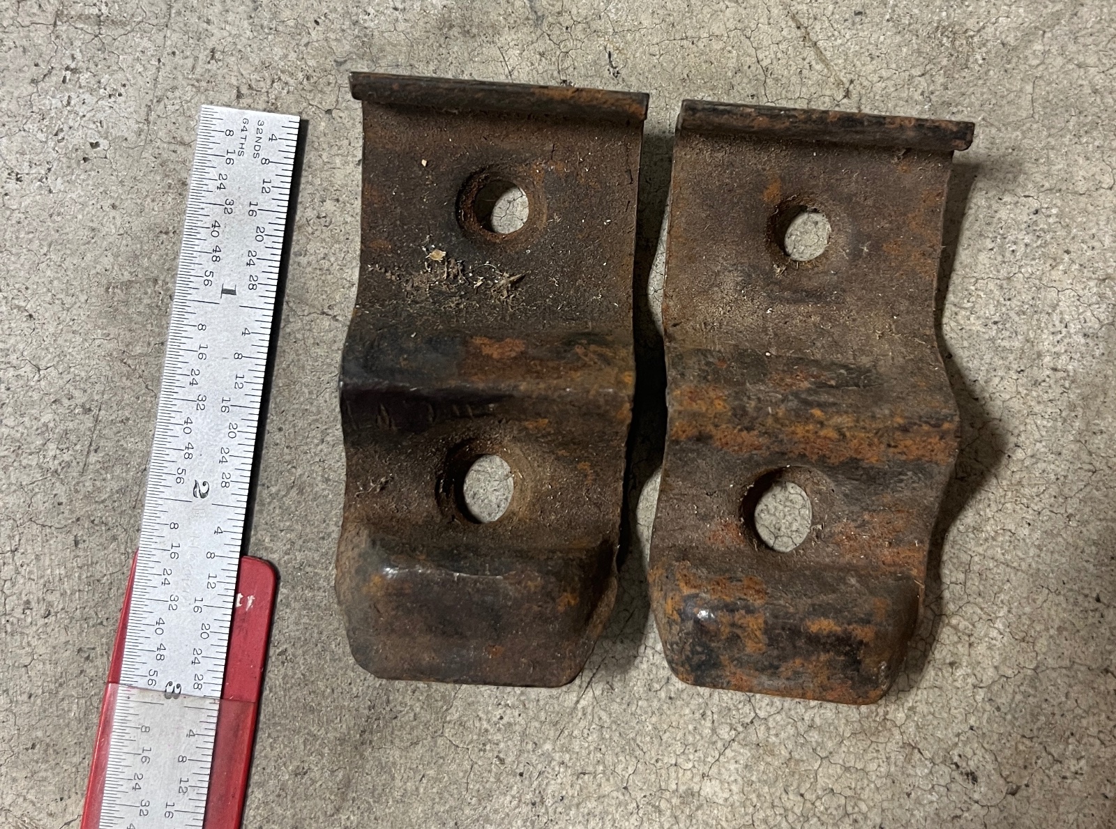

Hey guys I need help, I’m trying to figure out where these brackets go on a 1925 coupe. I have attached a photo, thanks.

Any ideas on this guys?

I have a 24 and don’t recall seeing this kind. Your car probably has steel doors so maybe they have something to do with that?? Others may know.

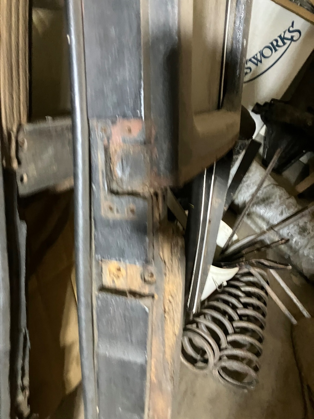

They are door strikers. They are mounted on the B-pillars for the door latches.
The area with four screw holes above the striker is for a dovetail.
