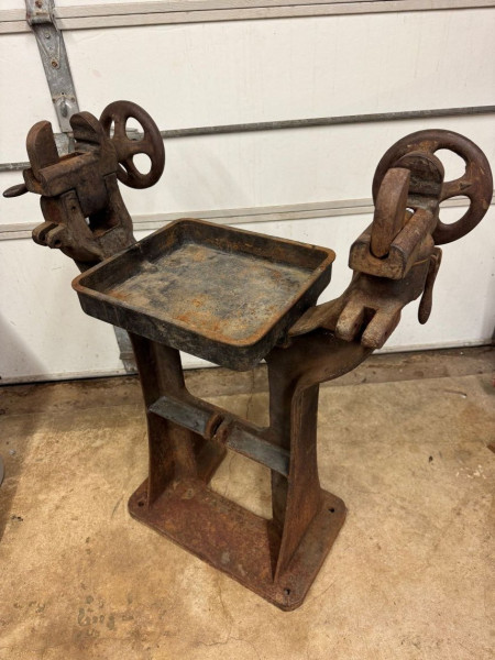

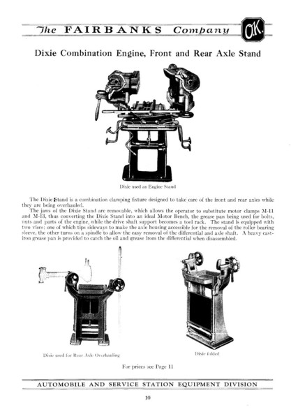

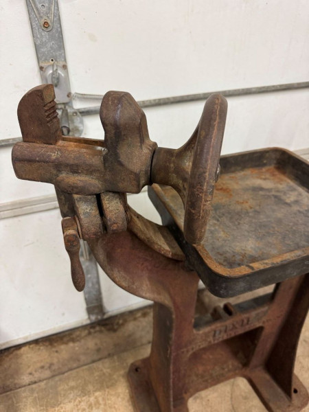

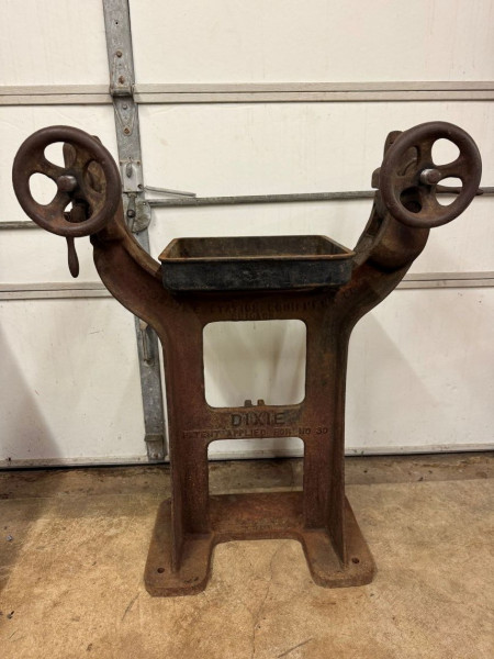

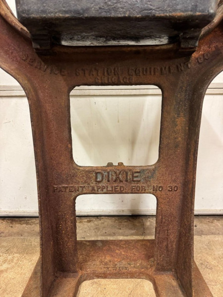

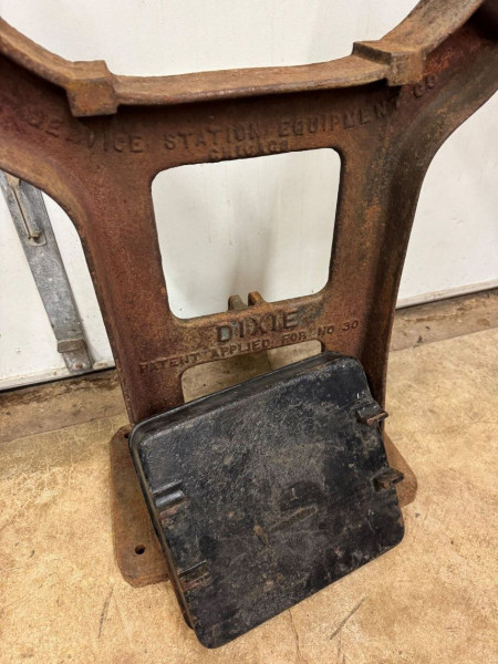

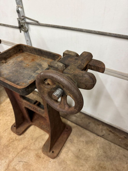

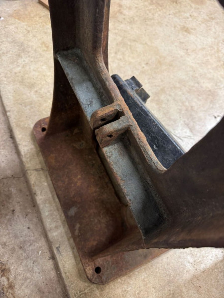

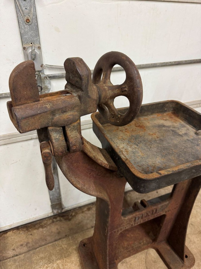

I recently purchased a Dixie model axle rebuild stand made by Service Station Equipment Company (SSECO). It is missing the foldable extension that supports the torque tube and holds the tool tray. Does anyone have one of this style that they'd be willing to take a bunch of detailed photos and measurements of? I can get close with the advertising images and some images I found of another stand, but I'd like to get it as close as I can.
I believe that is was likely black or dark gray, as evidenced by the faded paint in the letters of "Dixie" and the faded paint on the casting rib below the drip pan. The drip pan is also black, although it is so black that it may have been repainted at some point.

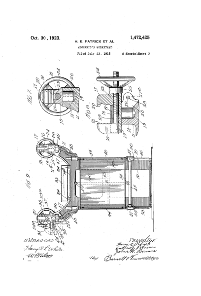

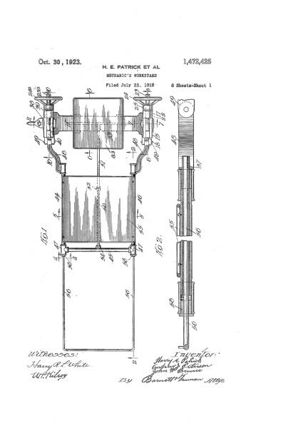

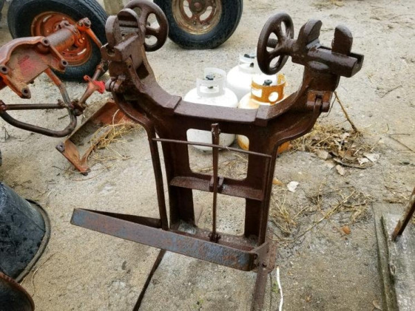

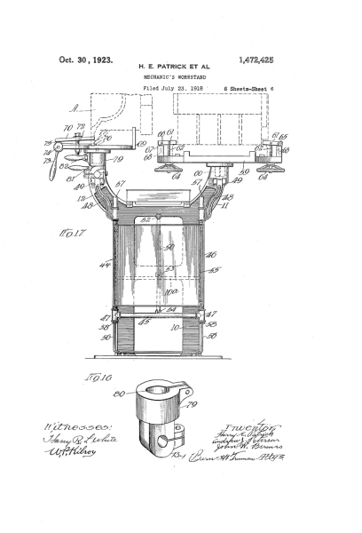

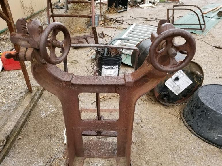

This is a different one that I found online. I suspect mine had this style of folding attachment, as the style shown in the patent was only shown in advertising for a short period of time.

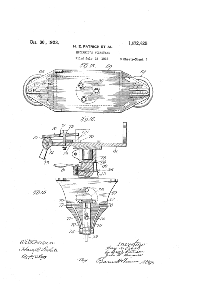

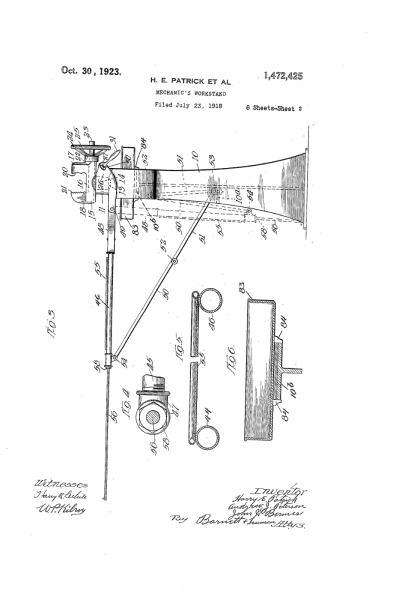

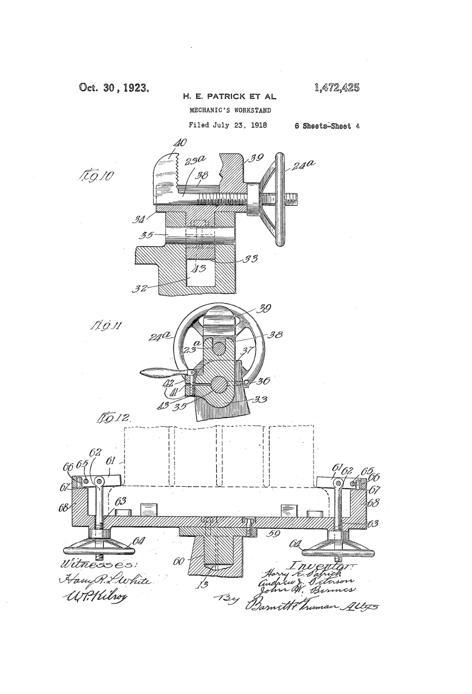

Here is the patent. https://patents.google.com/patent/US147 ... y:19100101
