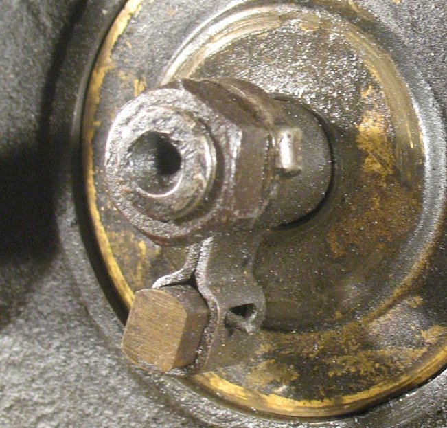

I hope this answers the initial question "I don't know which way to put the brush on the camshaft."
