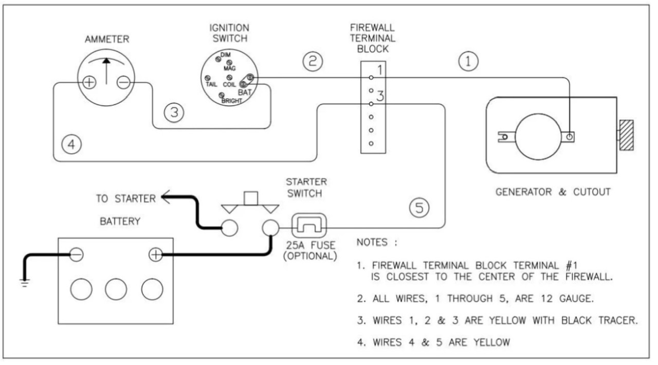

For best safety, add a fuse to the yellow wire from the switch 6v hot terminal, mounted in line near the switch, but mounted in line near the terminal block is easy access, for disconnecting 6v hot to the chassis when working on dash, lamps, or other 6v items on the T. The fuse will save the T from rare but can happen shorts to the wiring, which will smoke wires and start fires.

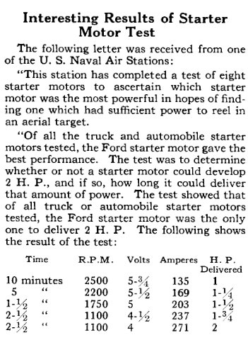

Starter draw should be 200 amps or less. Electric starters typically have a duty cycle of 10 to 15 seconds. Don't grind the starter for more than 10 seconds. Less is better. If the engine won't start in under 10 seconds of cranking, stop cranking and find out why. The starter should rest for a minute or two between consecutive starting attempts. A well charged battery of adequate size is essential to good starter performance and long starter life.

Re: Location for a cutoff switch and starter draw
Post by JohnH » Sat Oct 04, 2025 5:22 pm
Posts: 8631
Post by TXGOAT2 » Sat Oct 04, 2025 6:07 pm
Not clear what the test consisted of.

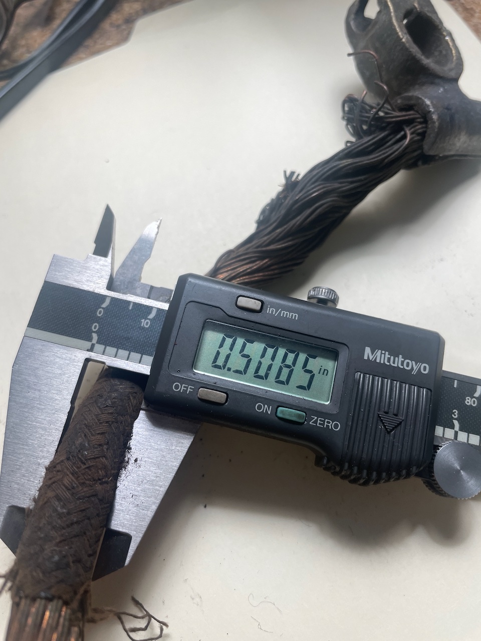

I checked an old Ford battery negative ground cable, Part # 5049B, Factory No. T-1890B that I pulled off a '23 chassis. This cable was used from 1919 to 1923, then Ford went to a ground solid flat strap (woven can be used too)..... This cable is 9 15/16" long, and I measure the OD as .500". The inside wires ID measure .0419".
For ref, modern 1/0 is called to as .035"-.038" ID, and OD of 0.500"

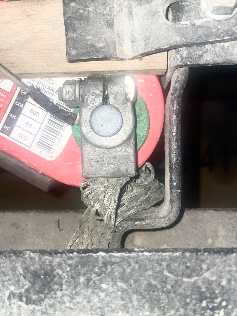

The picture of the red Optima 6 volt battery shows the positive cable connection to the positive terminal of the battery... What is the problem with having a insulated 1/0 or 2/0 size negative cable?.... It's the size of the cable that counts!
I agree!! In fact that Optima is in the running board battery box, cables exit the box, so for the negative ground, used the same size 0 cable. Works ok in this install as that cable had to reach under and up to the frame.
On other installs that Optima is angled in the Ford battery bracket so positive stays away from any body or frame parts. The ground distance from frame to negative post is short, flexible woven strap was my choice.
