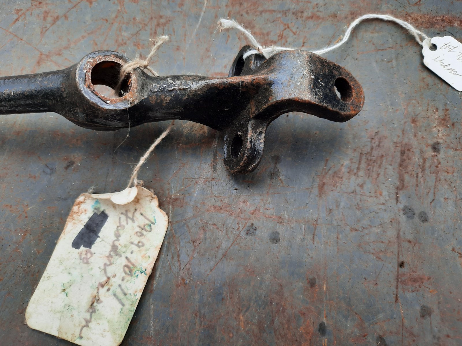

for sale: set of fender irons $50 plus postage

Are you sure they are 9-11 if they are I’d like them. If not I’ll pass.

Looks like 14-17 V groove to me…

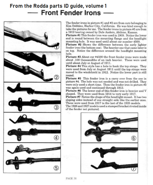

Post by TRDxB2 » Mon Oct 06, 2025 9:09 am
front fender irons 2.png (240.23 KiB) Viewed 874 times

That's a 17 to 25 fender iron

sorry that is what was on the tag

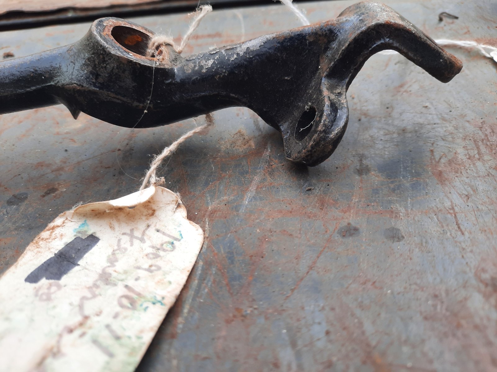

Michael is correct for at least one of them. Square notch for head light in close up photo makes it 14 to 17, Rodda guide #6. 17 to 25 had two 45 degree notches.

Can you post a picture showing the entire pair of fender irons. I'm looking for a pair of irons.
