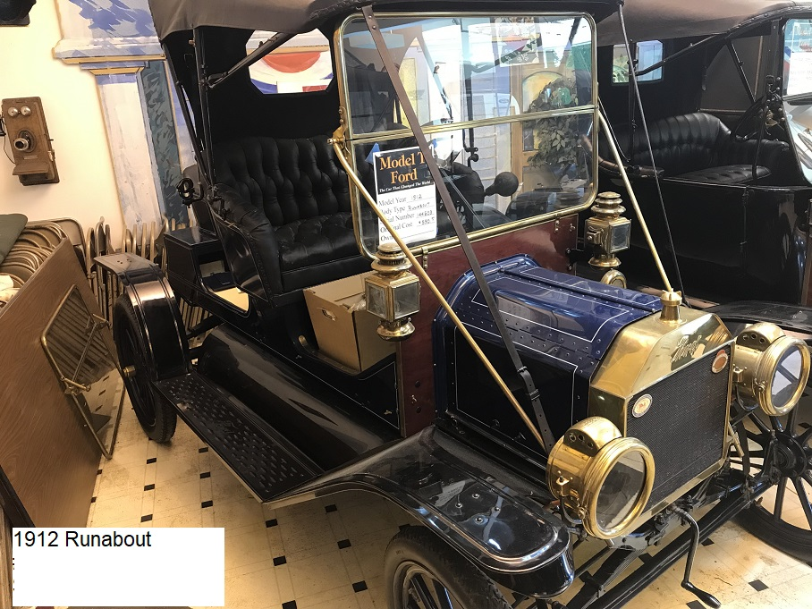

There is also a 1912 Torpedo at the auction tomorrow, here is the link and a photo:
https://rmsothebys.com/auctions/hf25/lo ... -runabout/
Screenshot 2025-10-08 at 22-46-00 1912 Ford Model T Torpedo Runabout Hershey 2025 RM Sotheby's.png

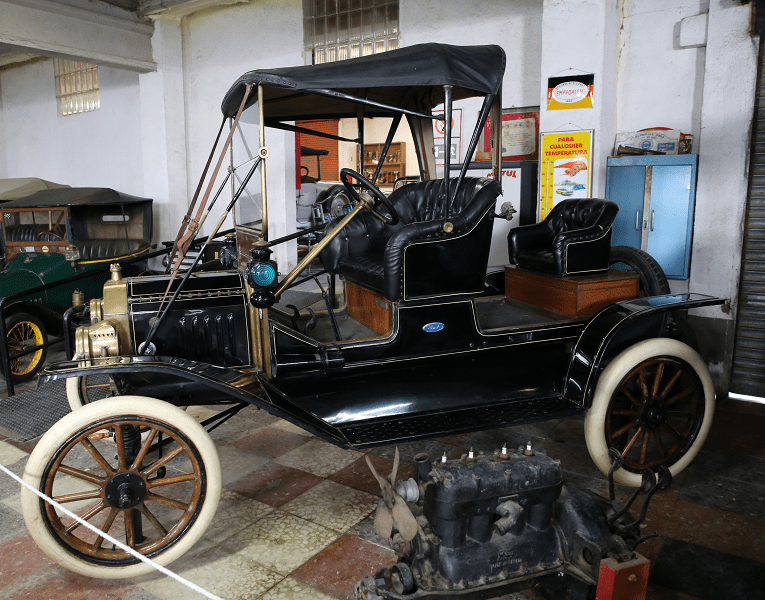

Award winner... belongs to a friend

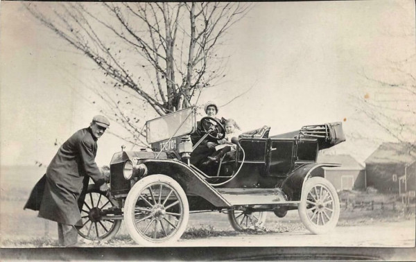

A few more pinstripe pics of '12 commercial roadster:
It looks like the only pinstripe is on the seat back, mother-in-law seat back, and on the hood.

Post by Jones in Aiken SC » Fri Oct 10, 2025 9:41 pm
I haven't seen this photo before. It is one of the best original photos I have seen. I tweaked it a bit in photoshop.
I have it figured out so my striper knows what to do.

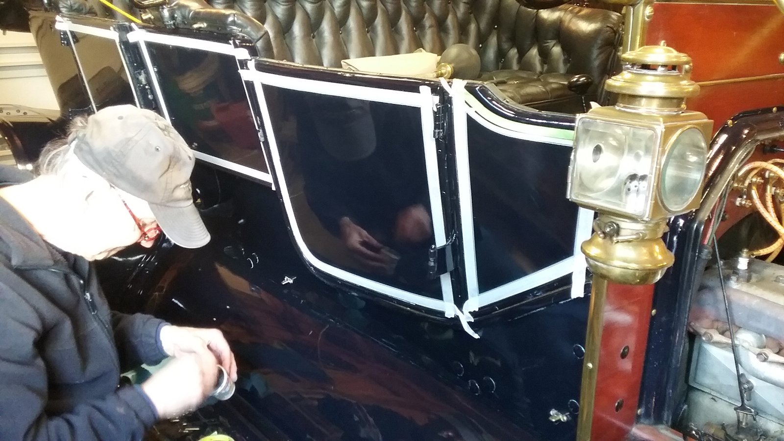

If a pinstriper needs masking to make a guide I would be wary of his abilities.
There is a reason why it is called pin striping rather than 6" nail striping. There is no way using tape will give the same quality as hand striping done by a true craftsman.

The presence of tape in the above photo doesn’t mean the stripe will be taped off. Many stripers use tape as a visual guide only. Are they poor craftsmen ? Perhaps not as able as the guy who can do a credible job entirely “free hand”, but they are few and far between.

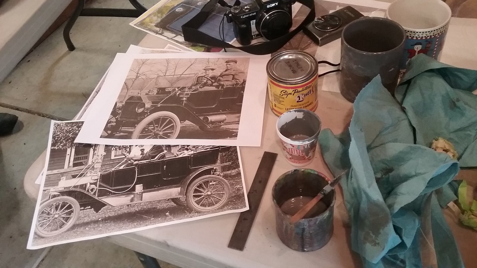

Allen, when I first saw the tape I had the same initial thought. Then he explained that is was for a guide only, as Rich pointed out. The stripe was not "taped off". He mixed the French Grey by eye and he did all the striping free hand with an itty bitty brush. He was a true craftsman and didn't charge me enough. He was facing some physical limitations and told me my car was the last one he'd do.
Here is how the magic happened...

Thank you Keith. That makes perfect sense. It would seem he has recognised his changing abilities and found a way to work around them. My motor trimmer is facing the same decline due to a failing right eye. He no longer does tops because he is not able to keep stitching seams in a perfectly straight lines which were a hallmark of his work.
I once watched an 80 year old gent hand striping bicycle frames. He had the shakes, but as soon as his fingers rested on the frame tubes, that went away and down the tube went his hand and the paint laden brush, with a distinctive flourish at the end of each stroke. Magic stuff to watch.

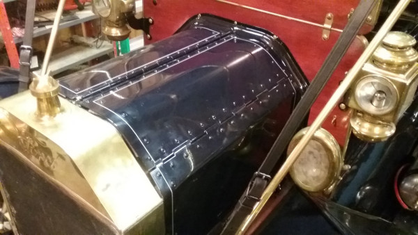

Post by Jones in Aiken SC » Wed Oct 15, 2025 4:54 pm
My pinstriper worked his magic on my 1912 Roadster and sent me some pictures. They are iPhone pictures and not the best, but I am so excited I had to share them! All done by hand. He is doing the wheels tonight and tomorrow.

Post by KWTownsend » Wed Oct 15, 2025 5:37 pm
OUTSTANDING!!!
You are now an expert!

By the way, those brass screws holding the hood former on were originals taken from an old firewall. Larry Smith would approve.

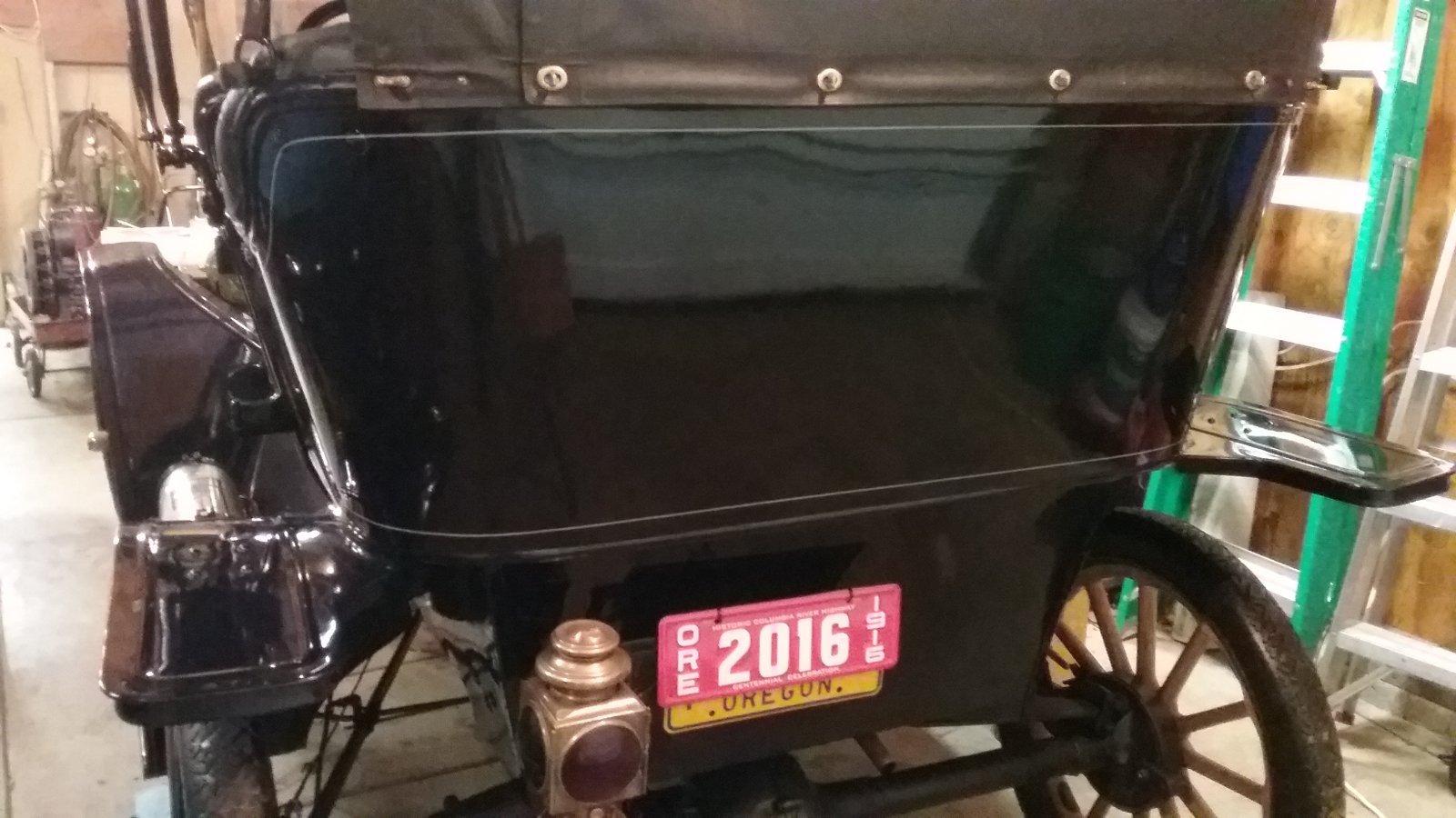

For those who are not tired yet of me blathering on about pinstriping, here is a picture of one of the wheels the striper finished today. I can't wait to get the whole car back and into good light to take some more pictures. Some might think the stripe is too dark, but it is French Gray as Ford defined it.It does look lighter in better light.

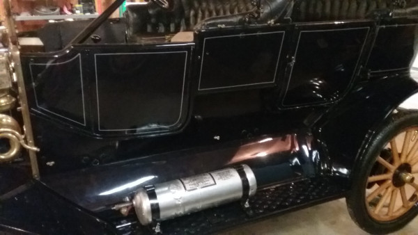

Some have noted the stripe looks blue, which I agree it does in some of the photos. I think it looks that way due to the light the pictures were taken in. The stripe is indeed gray. The algorithm in the iPhone camera probably gave it a blue cast. Anyway, for inquiring minds!
