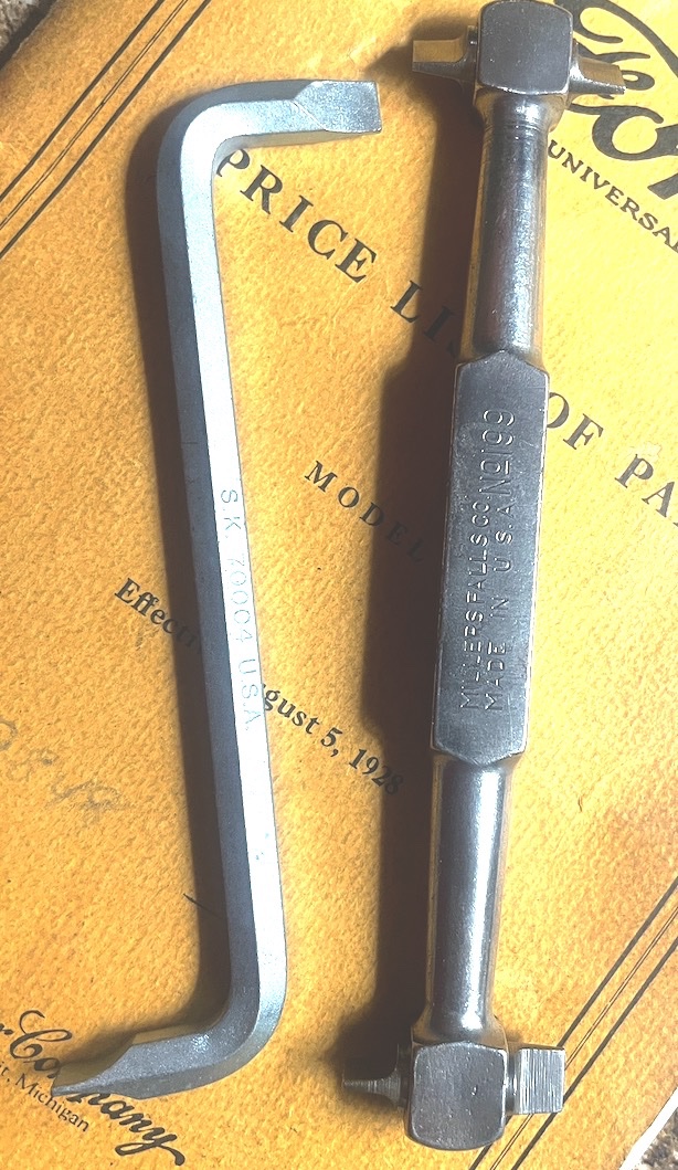

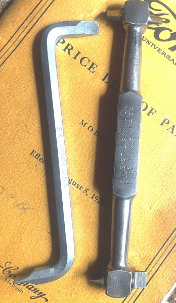

These types of screwdrivers, right angle help do that job inside the transmission inspection cover, as the clutch spring is engaged doing so and a nice lever like tool gives best leverage to easily half turn the screws.
