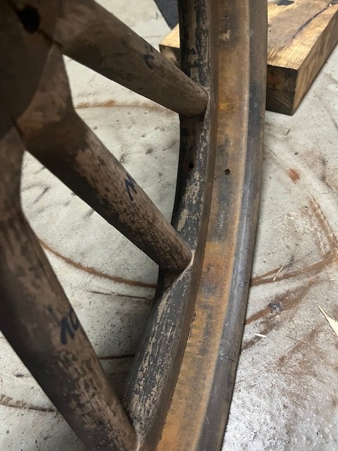

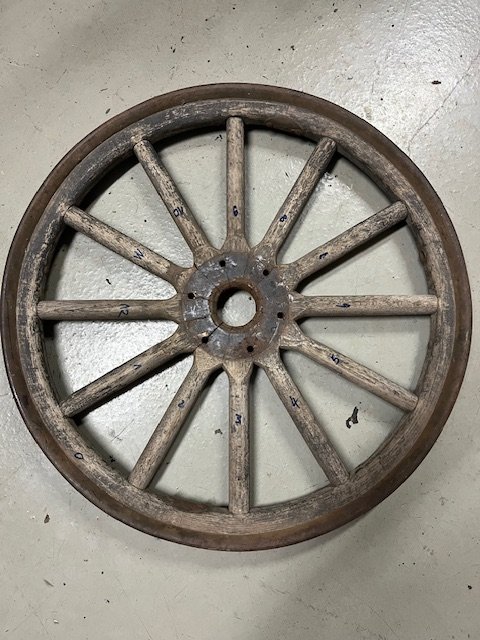

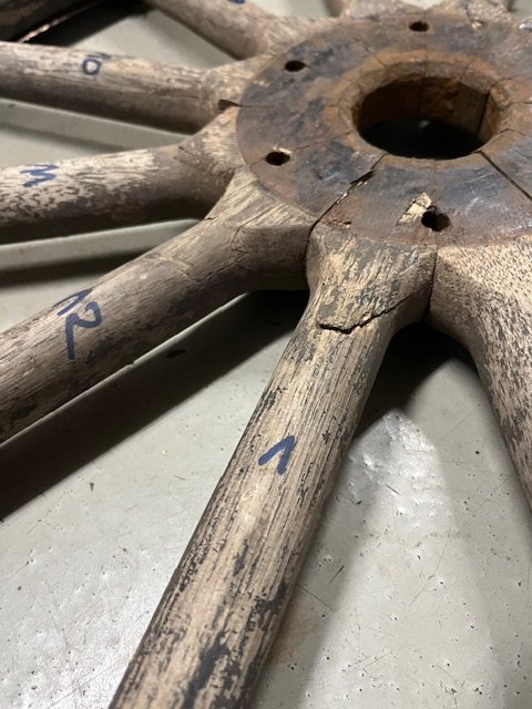

Hi,
I bought a spare tire for my Roadster. One spoke looks bad, 3 others do not look good.
Therefore I want to remove these 4 spokes, to see, if I could fix them with glue.
Could you please give a hint how I could remove the first spoke without destroying it.
I think if the first spoke is removed, to remove the others should not be a challenge.
To reinstall the repaired or new spokes I will use the Reagon tool, which I will build soon.
Could this be used for wood felloes or do I need another special tool for wood felloes?
Because of the high shipping costs I won’t send the wheel to Stutzman or another specialist in the USA.
I am located in Germany.
Thanks for your advices.

But If you take a closer look at the photos, you could see that spoke number 1 has a crack (which is clearly visible) and spokes 10, 11 and 12 also might have small cracks.
As there is/was no play or movement of the spokes and re-spoking a wood felloe wheel is a big challenge, gluing might be worth a try - for a spare wheel, which I hopefully never need to use.

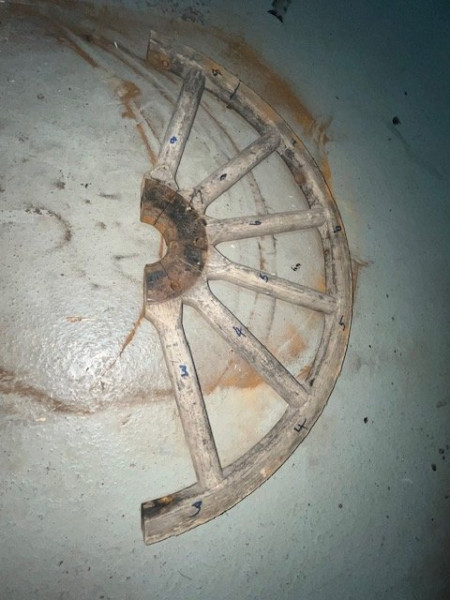

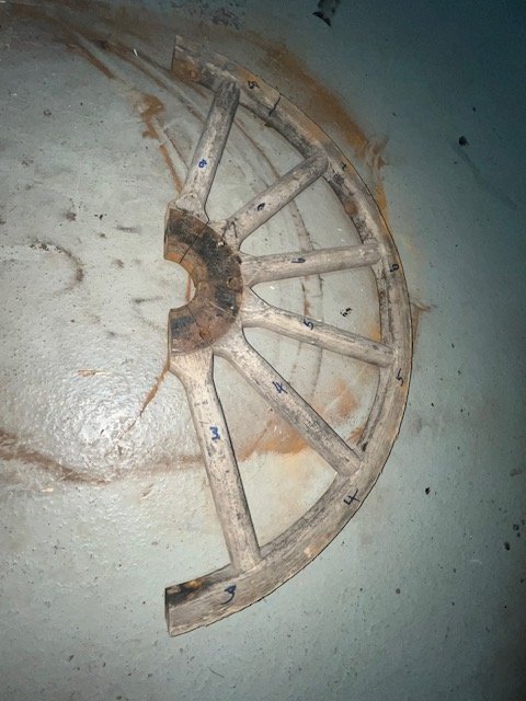

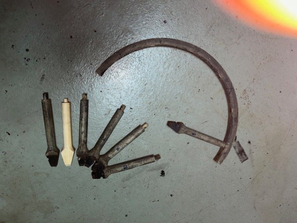

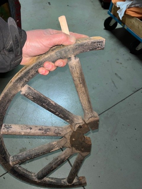

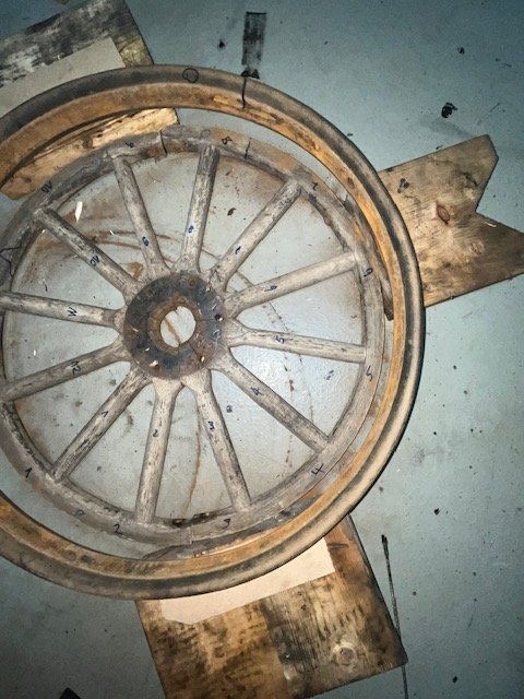

Therefore I removed the 6 rivets and then the felloe with spokes from the rim and also removed the spoke with the big crack and 3 with smaller cracks.
Those need to be exchanged against new spokes, the other seem to be okay and I plan not to touch the half felloe with 6 not cracked spokes.
I have spare new wooden spokes, which I planned to use, but they are too short, too thick and their tendons are not long enough.
Hope to find the right one from Langs or Snyders.
Please find enclosed some photos
Regards, Bernd

The first spoke is removed and all 4 spokes which have smaller and larger cracks.
Therefore I close the here now.

The loose rust dust on the rims indicate to me that the fellows were loose.
Those fellows will need material added to make for a correct tight fit. The fellows are held onto the rim by press/shrink fit, not the 4 rivets alone.
I believe the spokes available are for demount-able fellows.
You will probably need to contact a wheelwright to make you a few spokes.
There are more issues than you realize to get this wheel safely serviceable.
- Posts: 7267
Re: How to remove the first spoke out of a wood felloe
When making new wooden felloe halves the stock used should be a foot longer. The ends of the curves will never be bent in a circle, so they need your be trimmed off/back so the half piece is part of a true circle. This is not quite so important if making laminated felloes, as the thin lamunates will hold the curve bette.
Allan from down under.r
