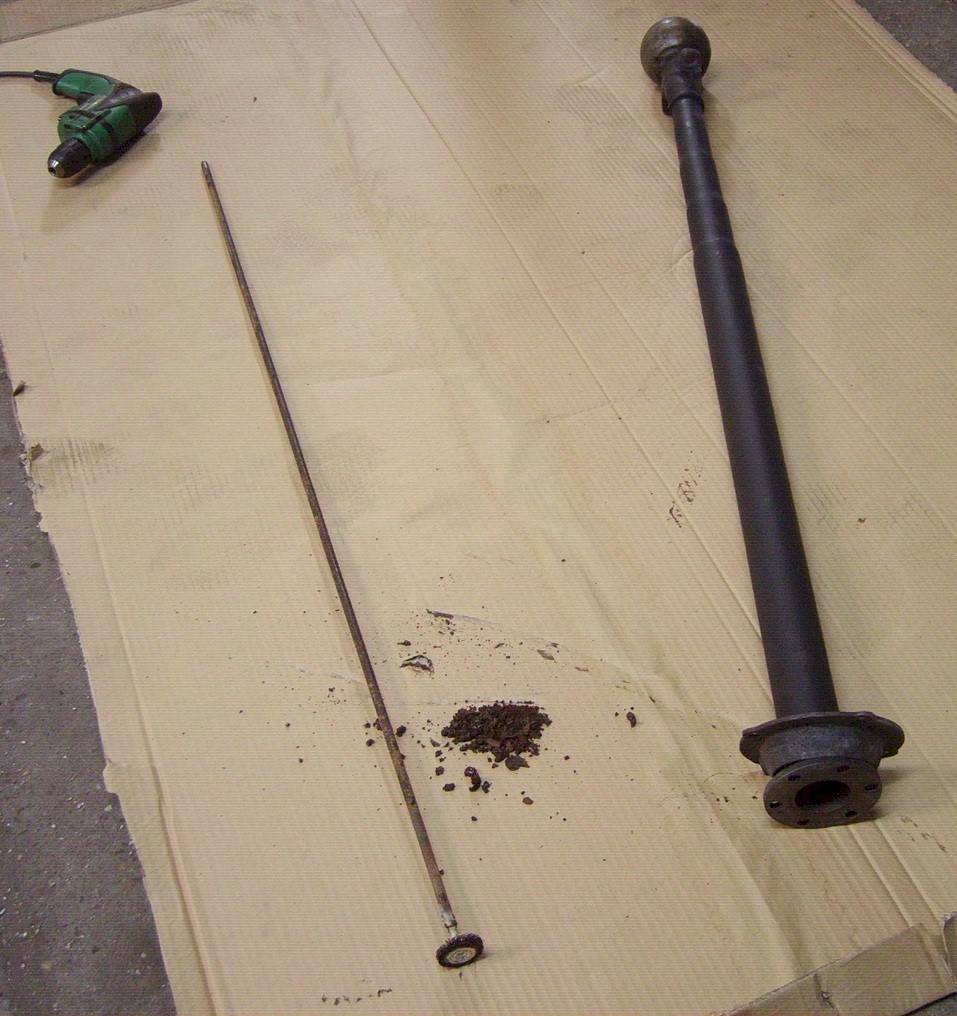

I am getting to the point (at incredibly long last) where I am actually going to be assembling the rolling chassis for my 26 speedster. A while back I fitted all the parts for the rear axle, but there were some things still to do to the drop brackets that had to be completed before I could assemble everything. I will be posting some more details as things go together so folks can see the pretty unique setup I made to drop the axle and mount the Rocky Mountan brakes.
Anyway, the one thing still to do was clear the old oil and crud out of the axle tubes. To do this I soaked the inside of the tubes with WD40 then scrubbed them using a cut off bottle brush that I melted onto the end of a 1/4 inch steel rod then stuck into a drill. After scrubbing the inside of the tube, I put rags over the brush and used the drill to run them up and down the tube. This did a great job of cleaning out all the gunk and old oil. There was also a lot of metal flakes, which is not surprising. I plan to keep washing things down with WD and wiping the tube out till I stop getting flakes out. It would be a shame to leave them in and install all new parts.

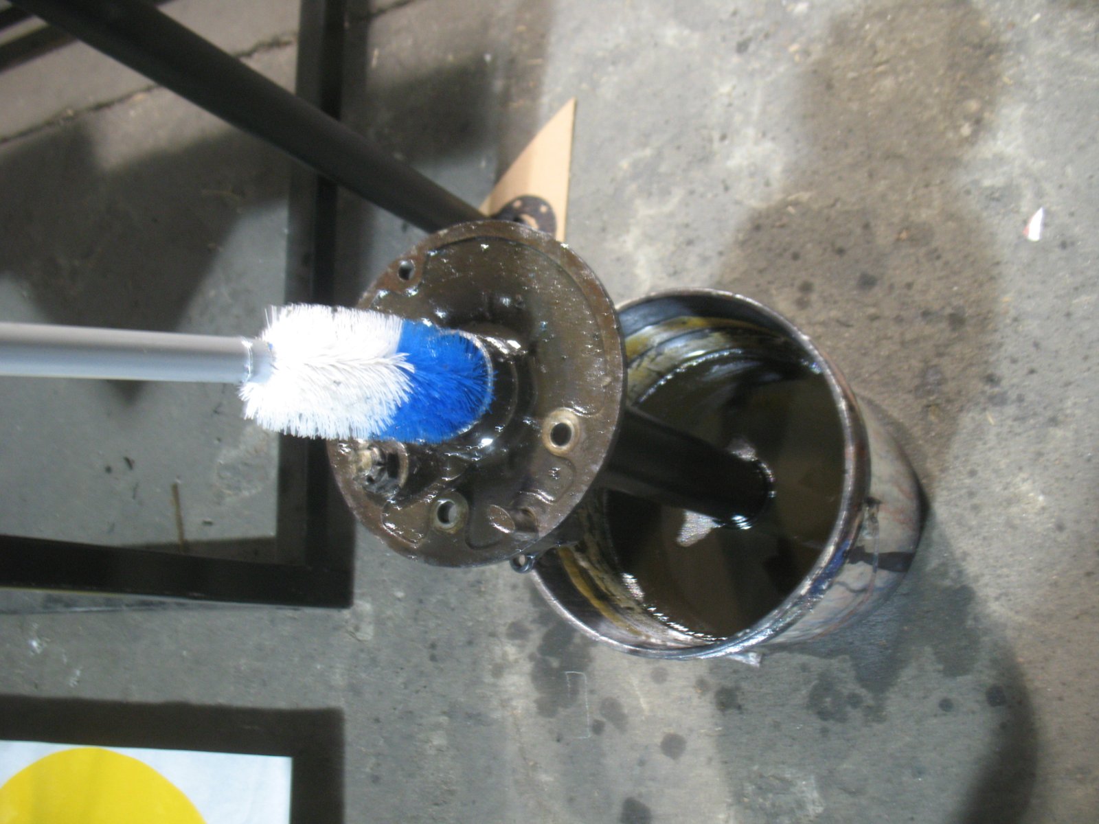

Use any solvent for oil-based residue in an axle tube or d.s. tube (kerosene, paint thinner, Stoddard solvent, etc.). Put a couple of gallons in a pail. Attach a toilet brush to a long handle. Scrub out the gunk.

As others have said, a toilet brush attached to a broomstick works well for scrubbing.
I also tried Mike’s method of plugging one end and letting solvent sit inside.
What seemed to work best for me was Simple Green and water.

They tubes are very clean now but I am planning on finishing up with some soap and hot water to get the last of the metal flakes out. I would do it outside with a hose from the tap, but it’s about 10 degrees f at the moment. Since they are not greasy, maybe I could take them to the car wash and spray out the inside of the tube with the wand.

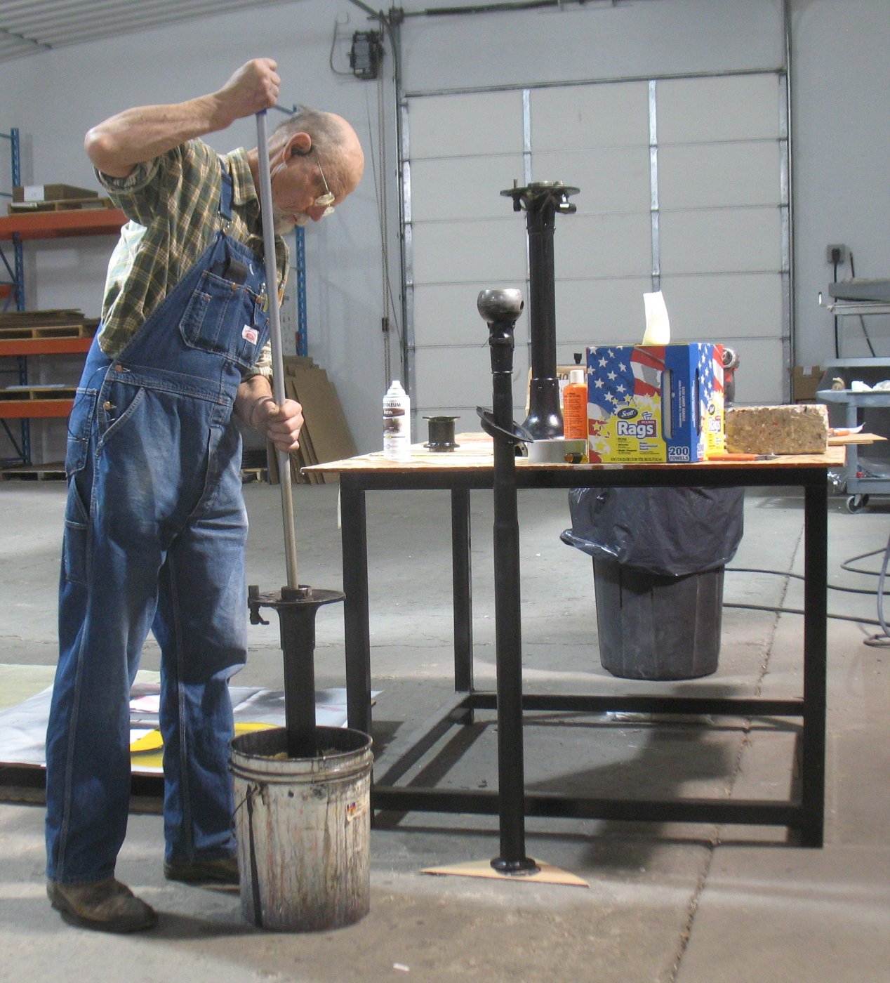

Re: Cleaning out my axle tubes
Steve and I do about the same thing.
Home Depot bucket with about 6 inches of kerosene. Put housing in bucket.
Attach a brush to a pole and pretend I am making butter in a butter churn.
Final rinse with some clean kerosene.
