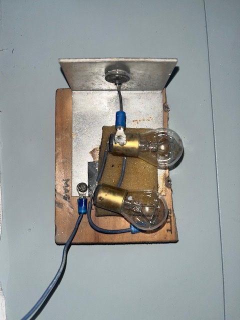

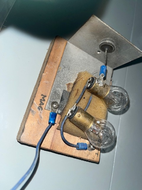

I found this device in my 1909 Roadster and I do not know how it works. Mag cable comes from magnetoposg.
Could someone please explain?

Could be a battery charger.

It appears to me that power from the magneto goes to the diode, thru the bulbs and is available as DC at the terminal marked 'Batt' partially hidden under the bulb. Magneto powered battery charger.

Half wave rectifier with(?) 2 12 volt bulbs in parallel to serve as a thermo-resitive regulator. The4 device allows limited battery charging from the Ford magneto. The magneto can deliver up to about 30 volts alternating current, depending on the engine speed, which is not suitable for charging a battery. The solid state rectifier allows only DC current flow, and the bulbs serve to keep voltage delivered to the battery within a tolerable range. The rectifier also prevents the battery from discharging through the magneto winding when the engine is running very slow or stopped.

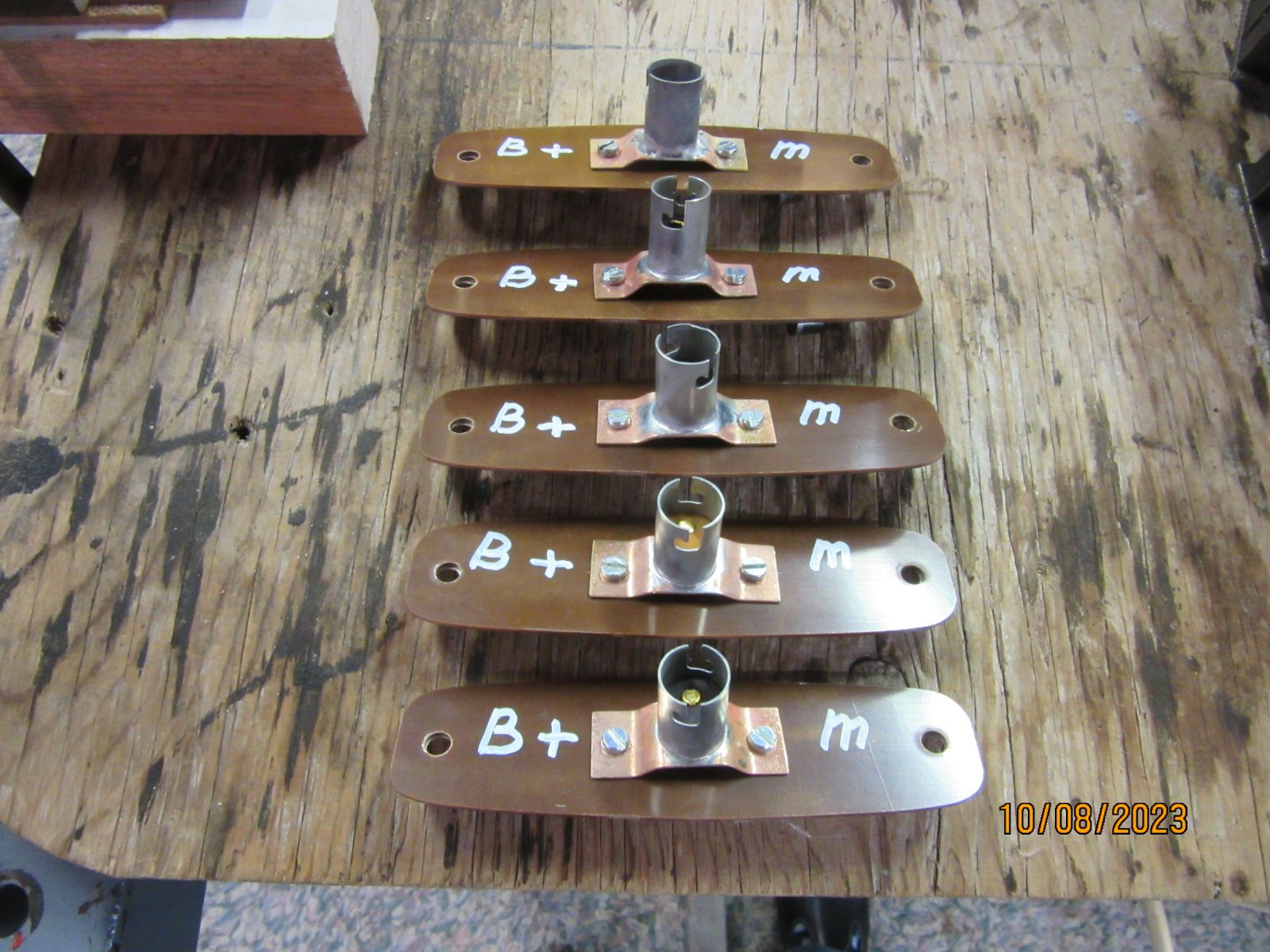

I made nearly the same parts to charge the Battery of our 1912 .
And that works fine !! Greeting from Holland

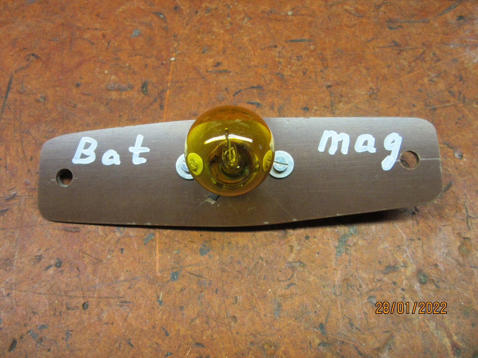

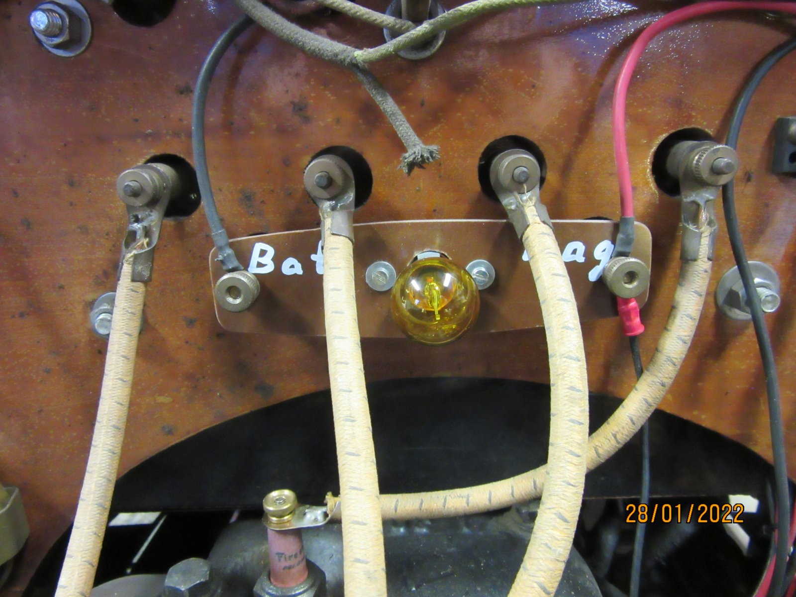

Toon,
That's a pretty clever mounting. No wires, and an under-the-hood utility light!

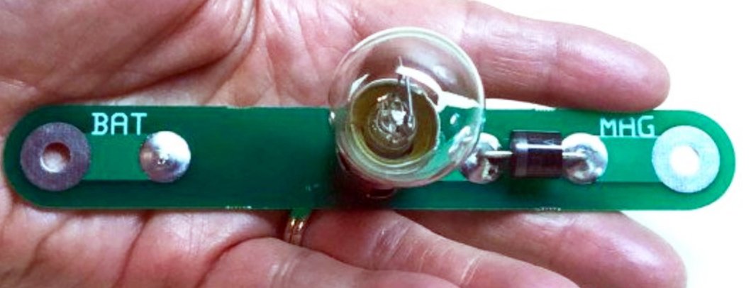

John Regan used to sell a neat little unit. It does a good job of keeping a battery charged as long as you don't run your lights all the time. It keeps the Odyssey battery in my '17 charged all season. If the diode shorts the bulb blows and protects the magneto. I had a diode short and it worked as advertised.

I've been considering making a few of these for our own use since they're apparently not available to be purchased anymore? Before I reinvent the wheel, has anyone ever made a PCB file available publicly to get these made? The John Regan version is such a neat solution.
