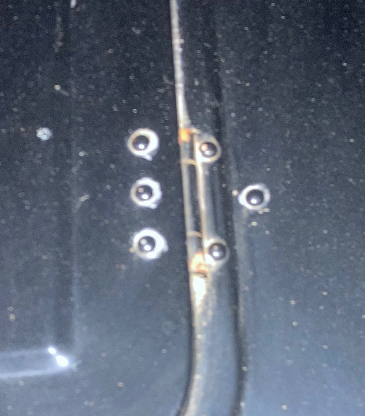

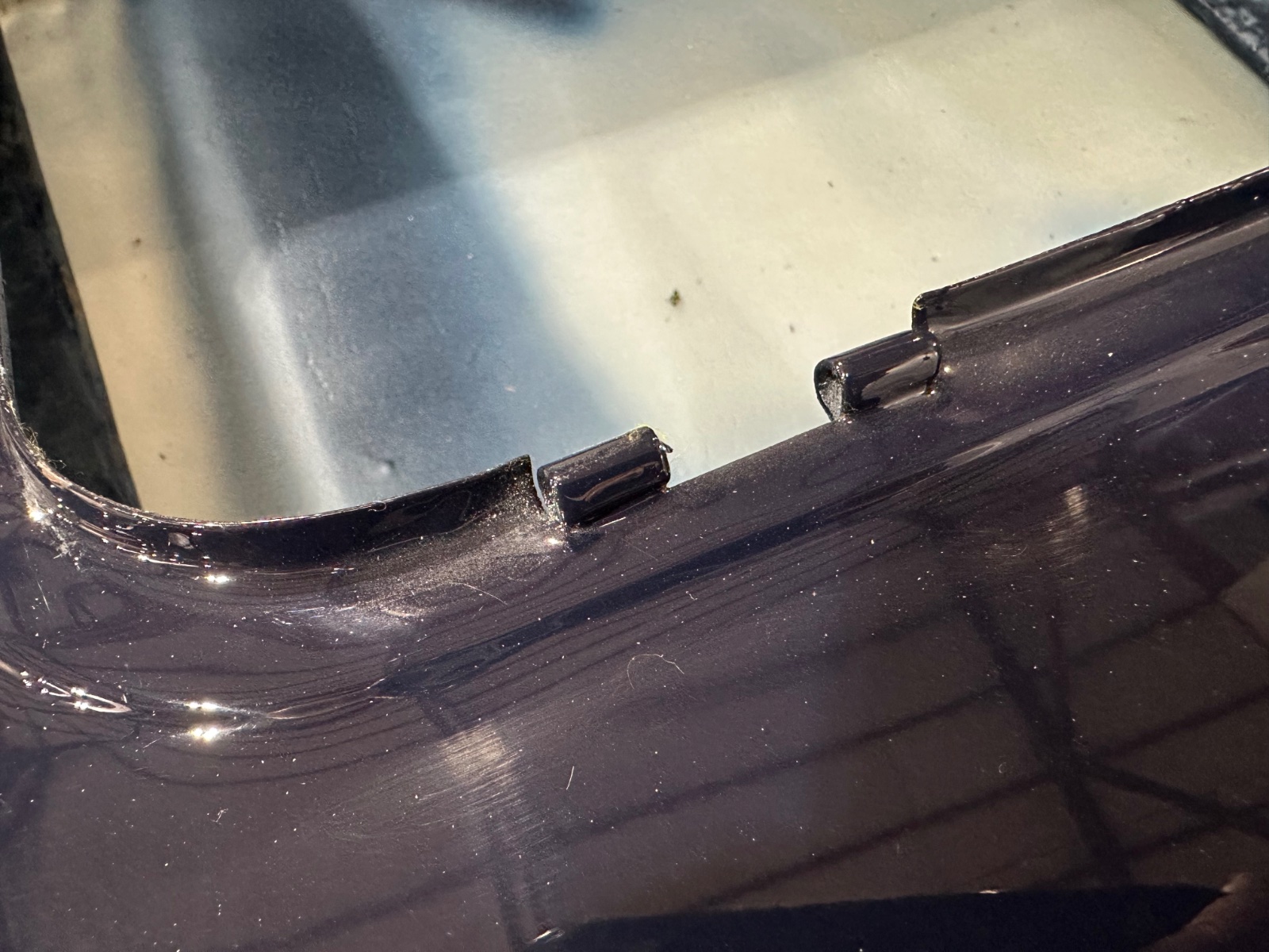

What pins are used for a 1914 turtle deck lid hinge? Is it a clevis or just a roll pin?
Posts: 4391
Re: 1914 turtle lid pins
Post by Jerry VanOoteghem » Thu Nov 20, 2025 6:50 am
It basically looks like a long rivet, or a typical hinge pin.
Posts: 2990
Last Name: House
Post by George House » Thu Nov 20, 2025 8:17 am
Here you are Art. Like Jerry said. The elongated ‘rivet’ appears about 1/8” from both sides of the hinge - with the pin evidently being inserted from the left and right side.

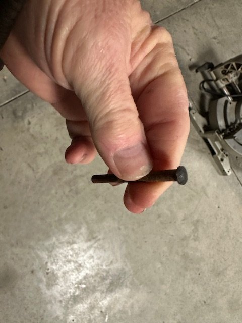

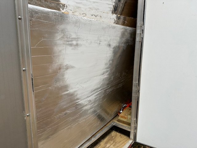

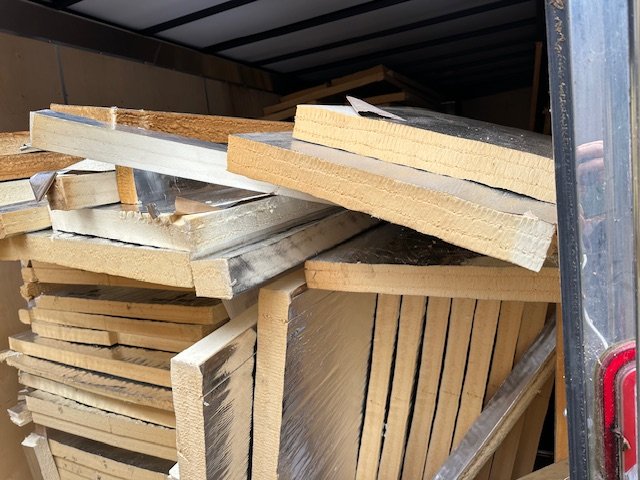

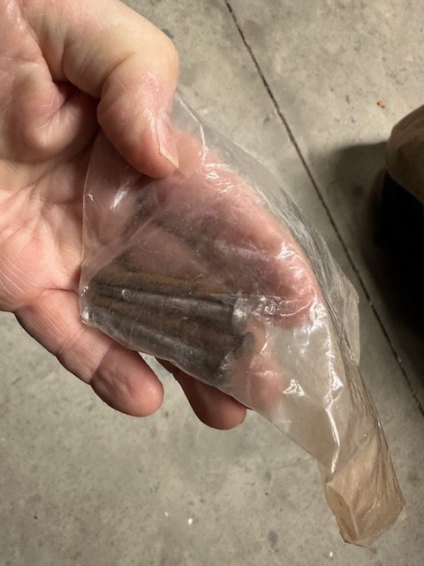

The only place I had not looked for the pins was in a box I knew was in the front V section of my enclosed trailer where the body had once been stored. The trailer has been loaded all summer with insulation for my polebarn preventing access. I guess it was time to empty the trailer anyway. TA DA!! I found them in a bag along with the door hinge pins right where I had left them. In case anyone wants to know the pins are 13/64 X 2" wIth a slightly domed head. Thanks for the responses. Art
