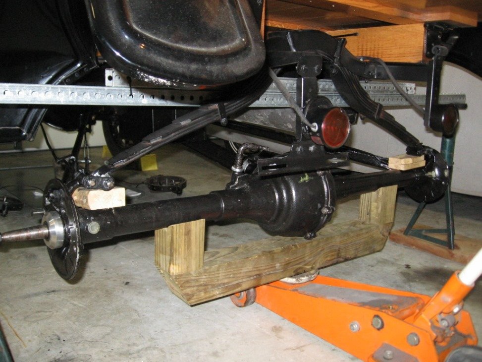

You don't need a spreader on a model T. Actually makes the job harder.
Using jacks & 2x4's under the leaf ends & Lifting against the body's weight will lengthen the spring to install the shackles.
My preferred method is to attach the perches first. Guide the perch stud into the backing plates. Pull home with the big castle nuts.

Use one jack on each side. (2 jacks) Or.......LittleTimmy52 wrote: ↑Mon Dec 01, 2025 1:32 pmWood might do it but I tried before and had no luck, though I think the blocks I used were too short. Side question, is that not bad for the axle all that weight?
I have A cradle I made that goes into my floor jack. Arms extend to either side to lift the axle by the end backing plate castings @ the same time.
Do not lift by the center pumpkin only.
Not that it wont work, but you will develop a gear lube leak & possibly bend the tubes.

With the rear wheels off, loosen the perch nuts enough to relax the shackles. You should be able to leave the loose perches in the backing plates. There should be no need for blocks or a spreader.

Here's how I did it when I installed my Ruckstell. Loosened the nuts on the spring perches, then used wood blocks to guide the spring eyes close enough to the perches to allow the shackles to slide in. Once the shackles were in, I re-tightened the spring perches.

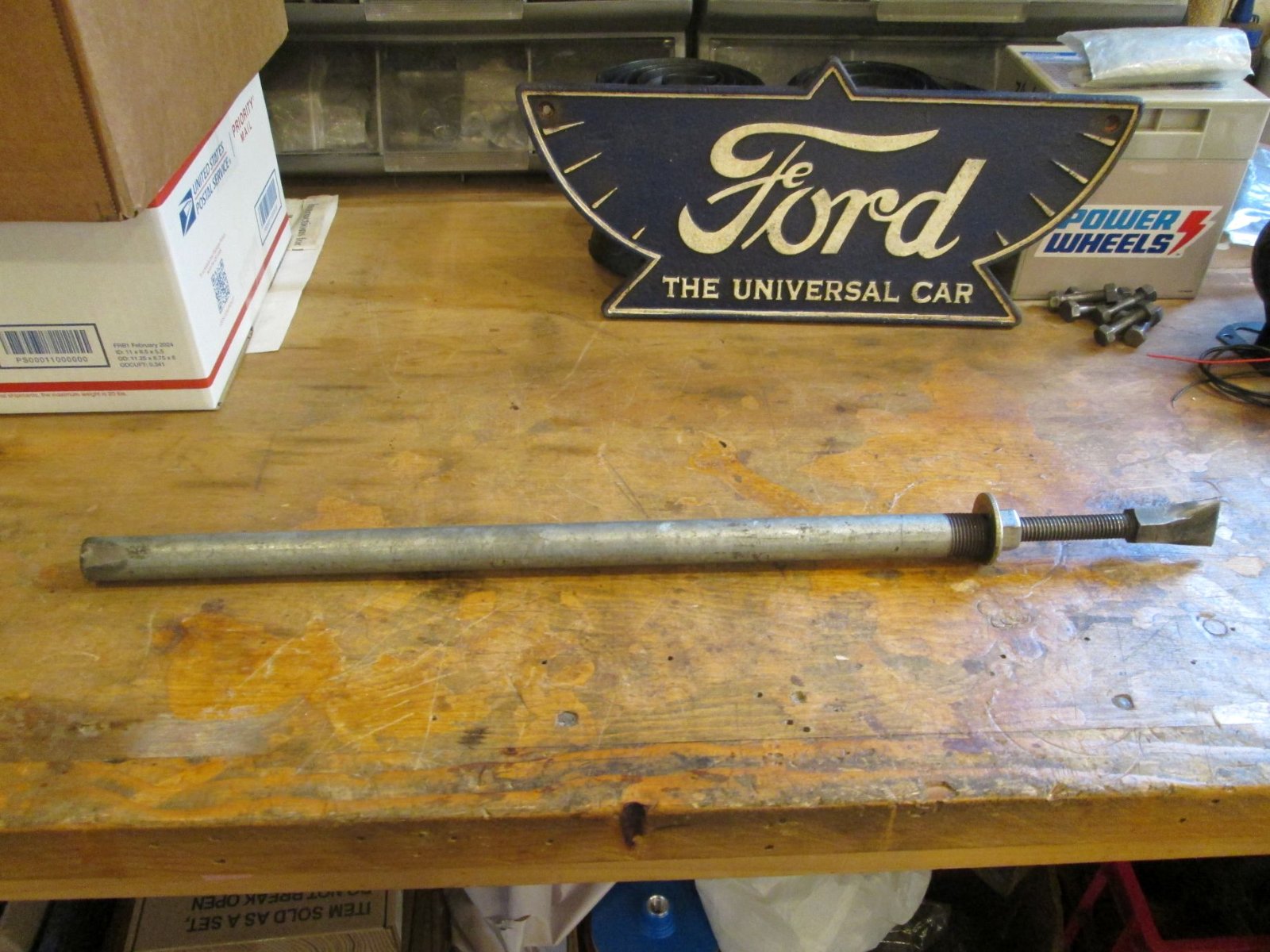

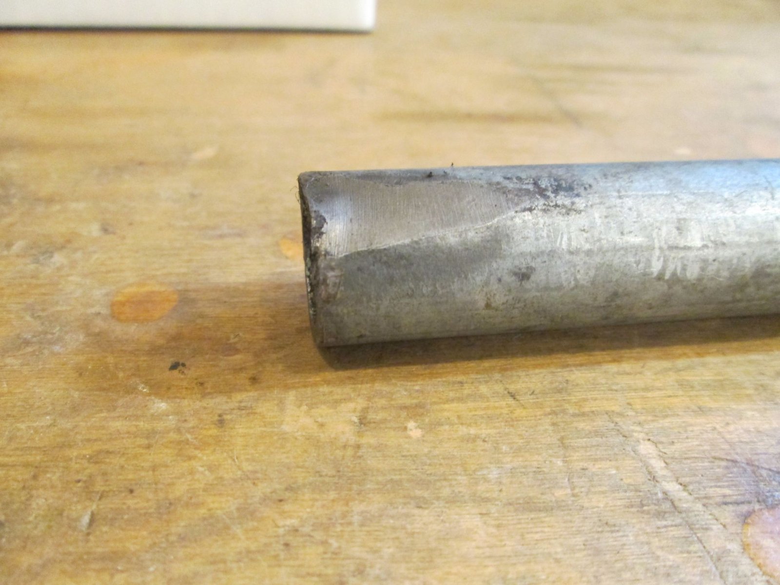

I made one out of a 16" piece of 1/2" iron pipe, a 6" piece of 1/2" all thread, a couple 1/2" nuts & flat washers & a 1/2" coupler - grind down one end of the pipe just enough to go over one of the punkin bolts, heat up and flatten one end of the 1/2" coupler, insert the flattened coupler under the spring eye, insert all thread into the pipe, thread out the nuts until snug then wrench away to the desired length to insert the opposite shackle - I attach one shackle first then use the tool for the other side - I'll take a photo later.

"CudaMan's" set-up is "spot-on". It can sometimes be slightly ticklish to find the sweet spot, where the spring is neither pushing nor pulling on the shackles to where you can slip the shackles in/out.

But years ago got a custom made spreader from a retired guy who made some very nice Model T tools and replacement parts, spreader has sliding tubing over a large threaded rod to expand and contract the tubing on each end. Welded hump portion to clear the pumpkin and alignment stays, works so well it's the go to tool.
