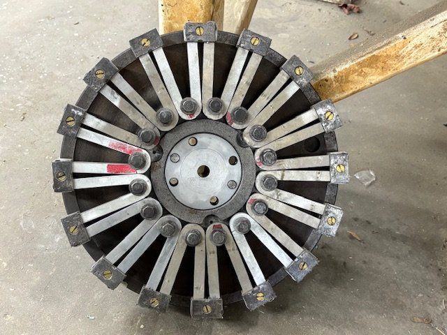

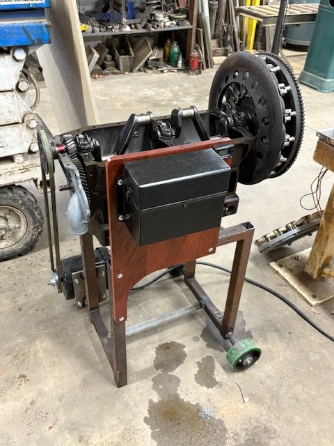

I'm still having fun playing with rare earth magnet replacements for model t magnetos, just for giggles. They work well but it is hard to quantify outputs and I'm not crazy enough to build another engine every time I make a modification. I hit on the idea of using a defective engine block/crank/cam and driving it with a variable speed motor. Kevin Prus made one available to me and I set about modifying the front of the crank to accept a belt pulley and modifying the rear by drilling and tapping for a 7/8" stud for quick attachment of the flywheel. I built a stand and inverted the engine block and bolted it upside down on the stand and drilled the main caps for oil cups. I mounted a three phase motor and drive it with a VFD which is easily adjusted with a ten turn potentiometer. Speed is indicated by a magnetic pickup tachometer with the magnet glued to one of the rod throws and the pickup attached through a hole drilled in the side of the engine block. By installing the cam I am able to fix a timer to the front cover and I have installed a coil box to the contraption so I can operate four coils and spark plugs along with monitoring voltage. Now to add a spark plug attachment that will allow me to pressurize the plugs and vary the regulator to see where they fail while watching through a window. I'm looking for a suitable AC voltmeter in the 0-50 volt range that has an antique look to it - any ideas appreciated. It is still in a rudimentary stage but I have already been intrigued by what it has revealed. Some guards are in order as the crank whizzing around at 1500 rpm is rather intimidating as is the open v-belt. Best toy I've gotten for Christmas for over sixty years!

My plan is to wire two 1156 sockets in series so I can select one or two with a double throw switch to vary the load and check at speed or bypass them to operate the coils and plugs. Parts on order - will advise.

The lower setting on my VFD is 10 cps which nets 240 rpm. Below that the motor torque sort of disappears. What would you think cranking speed would be?

Surprisingly’. I have found that with a freshly recharged stock flywheel adjusted to .030 clearance the volts per revolution per minute is very constant at about .025 volts/rpm which would equate to 1.5 volts at 60 rpm. There is some degradation as the speed increases but very little in contrast to the neodymium magnets which seem to improve as speed increases, as much as 15% at 1500 rpm - no idea why.

The voltage I observed is almost perfectly in line with the Ford repair manual. There is some degradation as the speed increases from .025 volts/rpm at 200 rpm down to .0218 give or take at 1200. I left my notebook at home this morning but will confirm what I found soon. I can reprogram the minimum speed of the VFD and assume that if I start the motor at higher rpm I will be able to reduce the speed without stalling the thing. I also did a speed by speed comparison with one of my neodymium flywheels set at .060 to .070 clearance and had the same 5 volts at 200 rpm but it increased to about 30 volts at 1200 rpm if my poor old tired memory is correct. again, will confirm.

I had my guys help me reprogram the VFD today and checked the voltage with the stock magneto/flywheel arrangement and it yielded 1.0 volts @ 40 RPM and 1.5 volts @60 RPM still maintaining the .025 volts per RPM.

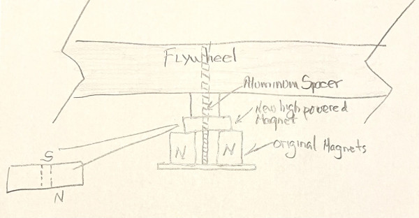

Here is what I did with mine as I didn’t have time to experiment before putting my engine together. I bought 1/4” thick magnets, and 1/2” thick spacers to make the total distance match stock. My goal was not to reduce weight but to create a mag that wouldn’t lose its charge over time. Works well.
I also used shims to adjust the gap as the new magnets are brittle and can break. Ray

I also had the whole assembly dynamically balanced when I was done. It was about 38 grams out. Ray

Aren't you concerned that they'll do exactly that, and trash your engine/trans, as well as allow your original magnets to come loose?

How does adding brittle little magnets keep the magnets from loosing their charge?
Magnets don't loose their charge over time unless DC voltage is introduced. Am I missing something?
In trying to re-invent the wheel, you have added serious potential failures. :( IMHO
A better understanding of the system would be preferred to blind experimentation.

Jerry, All the new high strength magnets are brittle when struck. It’s the materials they are made from. Using the normal method of striking to adjust the height risks cracking / breaking the magnet. That’s why I used shims instead of striking. They won’t break/crack unless struck and are extremely strong unless hit. Appreciate the comment. Ray

Since the vast majority of donut rare earth magnets are axially magnetized (and not diametrically magnetized), it appears that Ray's creation works in spite of the improvements rather than due to them and is a testament to the robustness of the original design. If diametrically magnetized magnets were in fact purchased, then my hat is off to him for his ability to get those suckers to stay in alignment while tightening them.
FWIW, the coil is going to fire on the waveform when it reaches 1.3A (or wherever you set your coils). 3V hand cranking, 28V at road speed, 75V with rare earth magnets, or lightening from the Lord Almighty. It's simply a science project and if you bought your T to advance the cause of science, by all means, have fun, and it sounds like you guys are, so good for you, but I suspect that Elon's not losing sleep over it nor interested in buying it. I just don't view it as an improvement, because the other 15,000,000 Model Ts all ran fine as produced. Personally, it is my desire to simply experience automobiling as it was in 1920. But that's just me and there seem to be damn few people these days like me who are satisfied with JUST an antique car if this Forum is any indication. People like myself will be gone in due time and there will be no one left to pee in anyone's cornflakes over this sort of stuff, so be patient.

When I went to engineering school I learned and understood Faraday's principle.
I have studied and writtten about the magnet and pole relationships of the Model T magneto and how it relates coil power and subsedquent ignition timing
I understand rare earth magnets and Curie temperature, but rare earth magnets come in all sorts of sizes and shapes.
Can someone show me a diagram depicting the magnetic North/South pole orientation with the respect to the physical shapes of the magnets shown in the above implementations?
Ron Patterson

Ron, I have always appreciated your posts and articles. Thanks! The magnets I used are poled on the flat sides. When I inserted them next to the original magnets I put then n to n and s to s. That way they enhance the magnetic strength of the pole. The other advantage is they don’t loose strength over time like the originals do. They will also prevent the old magnets from losing strength. My idea for this design is to build a mag that doesn’t loose magnetic strength over time but keeps the same power without a ton of added expense. Let’s all do what we enjoy and have fun doing it. Ray

For Ron
