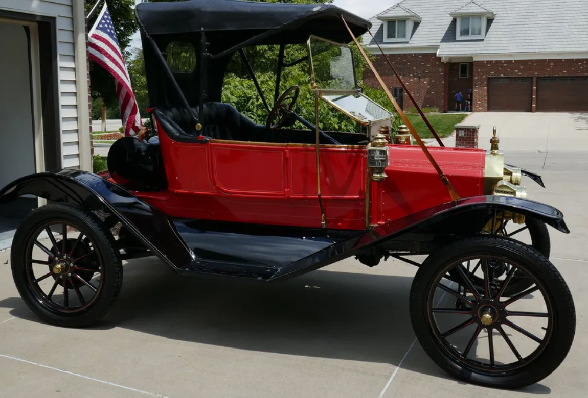

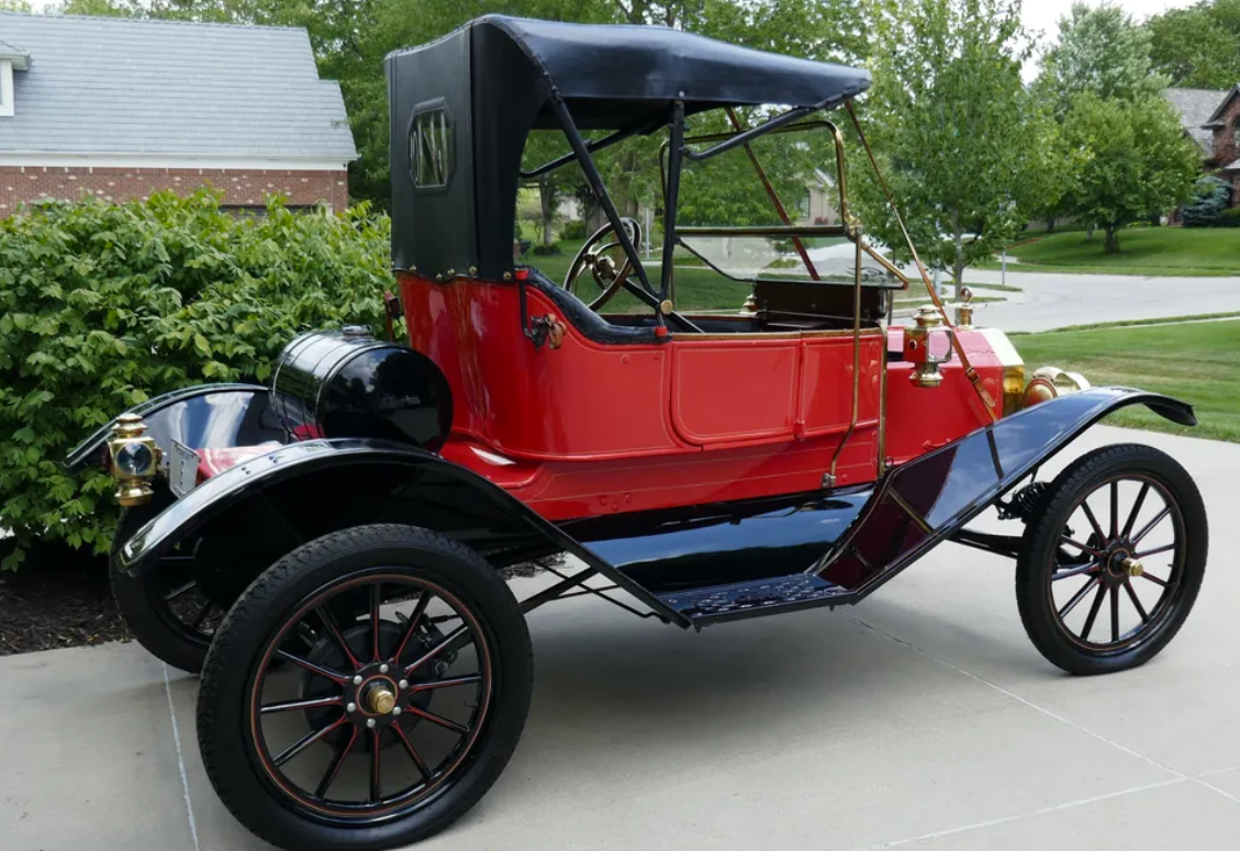

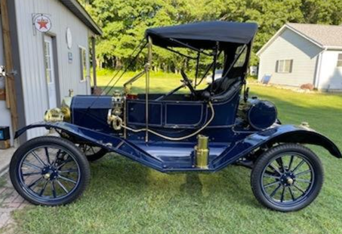

The owner of the red Torpedo shown below sent me a batch of photos. I am giving serious consideration of buying it and I know it needs TLC. I am wondering about what to do about the large gap between the top and the top of the windshield. I am comparing it to the blue Torpedo, which many of you have seen before.
I have not seen the car in person yet, although two of my friends got it running and gave me intel. What should I be looking at or measuring to asses fit issues? Is the windshield wrong or the windshield support rods? Any input from Torpedo experts is appreciated. This car has been in the same local family since the early 1950's and displayed in a museum for decades. So, it needs work to make it road worthy. I'm prepared for that but that top issue bugs me. Thank you Mark

Not an expert, but having had one a while back that I sold, the lower windshield on the red car looks to be "flatter" than the blue one? Could be an optical delusion tho. But yeh, sumpin aint right? Isn't this the same car that's been on Hemmings for like ever, starting out at around $40K? If so, man have prices tanked!

That gap is pretty big. I'm not a Torpedo owner, but I'd measure the length of the front bow from the pivot to the leading edge on both (or more) cars. It might be the bow was not seated inti the top socket far enough.

The windshield on the blue one looks like the way the windshield is fitted on mine. I have always considered mine to be correct because of the research that I have done. There should be a long brass cover to keep the rain from leaking through the crack dividing the upper and lower sections of the windshield. It is needed because of the way the windshield zig zags. The rain could fall through and land on your knees or the coilbox.

Mark, I think there are two things wrong which are the bulk of the gap:
1. The top is very square in back and flat across the top...if the back raked back a little, the center bow would be the tallest, and then if the front bow was dropped down and the top material extended forward (perhaps 4-5") then the front bow would be in place correctly (a shame because that was a well done top but to the wrong profile)
2. The support rods from windshield frame to the body are clearly too short; the angled windshield is well below the top of the steering wheel and should be above the wheel. Extending these rods will bring the top pane to be perpendicular to the road lift the top of the lower pane to be above the steering wheel and less "flat", and then be tall enough to engage just behind the corrected top
All easy fixes with some $$ so that in my opinion would affect the price just a little bit.

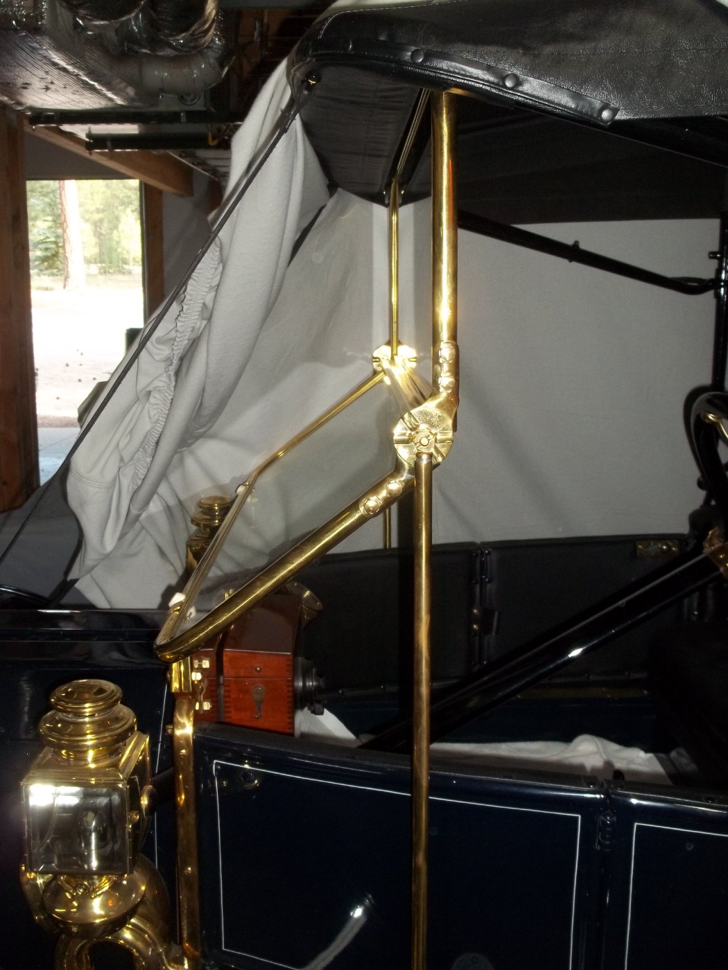

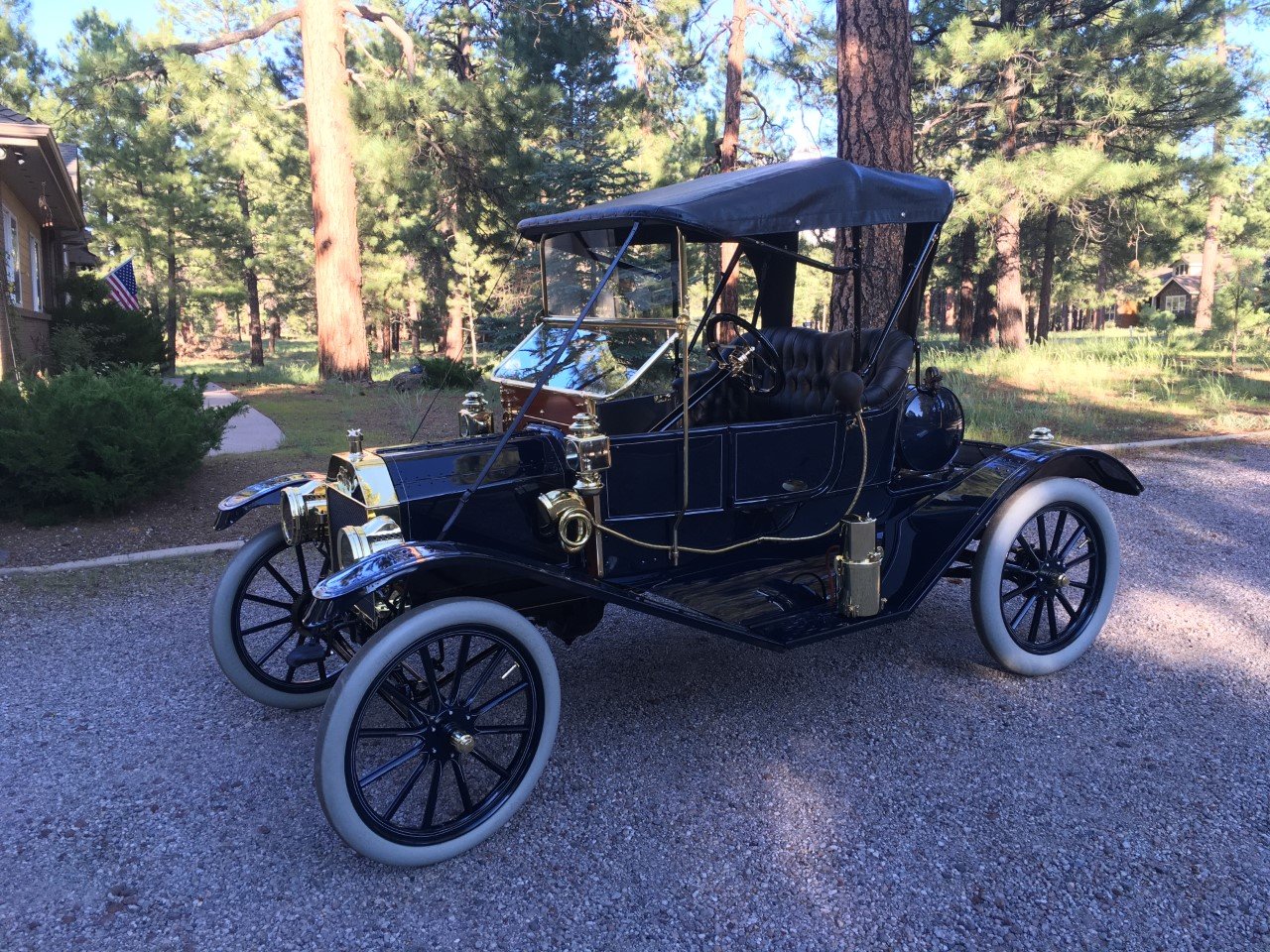

I own the blue one. Mine was a little too tight in that picture because the windshield was too far forward. I since have adjusted it. I have seen that gap all over the place in 11 Torpedoes. Contact me through this site if you have any questions. I have restored three of these in the past 30 years. I would be more than happy to talk Torpedoes with you. Mark E.

My Torpedo has a wind deflector attached to the top. The top half of the windshield sits vertically and the wind deflector touches the windshield.
