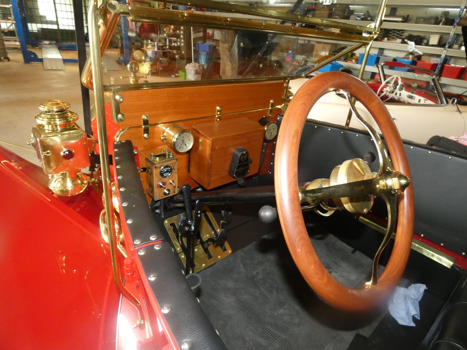

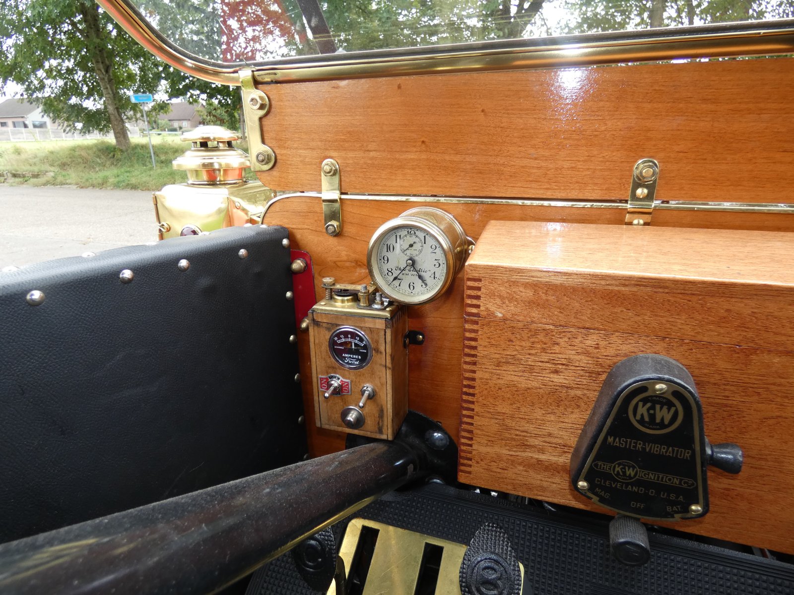

John is so right about the ampmeter.
I build mine in an empty coil.
Photos are from a 1912 Torpedo runabout.

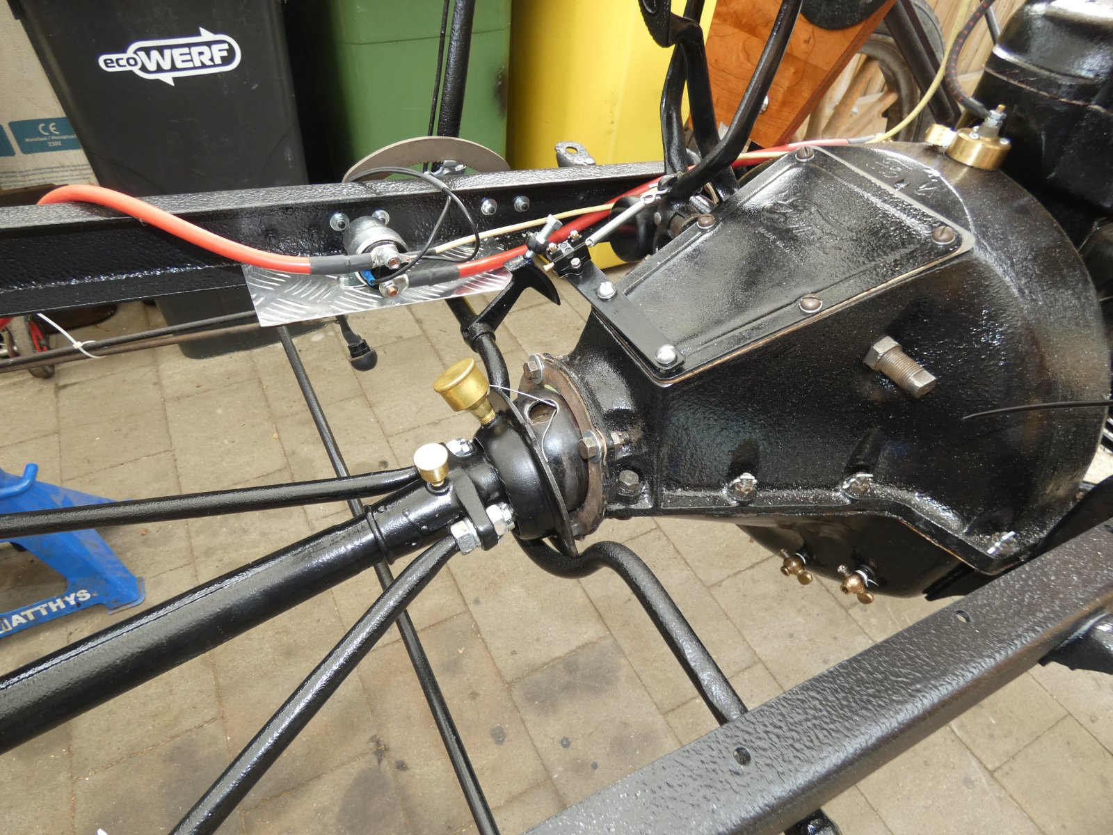

The on-off-on switch is for the flasher, the push button is for the starter( I installed a starter relais to command the starter) the other switch is for the lights.
I use a 30Amp to secure the electrics.
