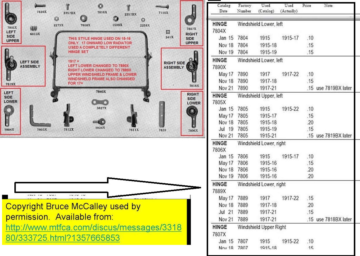

One would expect the right side running boards to be lower from stepping in & out. Since its a 1915/16 you bought, it may have a mix of parts (tilted windshield?) and tha's causing a problem. Some photo's would help. Wish I was a bit closer to take a look.
Picture from https://www.mtfca.com/discus/messages/5 ... 1426184252

Does the cowl lean with the windshield?
Posts: 6611
Re: leaning left
Post by TRDxB2 » Thu Jan 29, 2026 3:49 pm
TXGOAT2 wrote:
Thu Jan 29, 2026 2:40 pm
Good question! Not sure what Martin meant by "tilted" though. Like you suggest or leaning back like a later model vs upright on a 1915.
Pictures are worth a 1000 words, we can only speculate.
