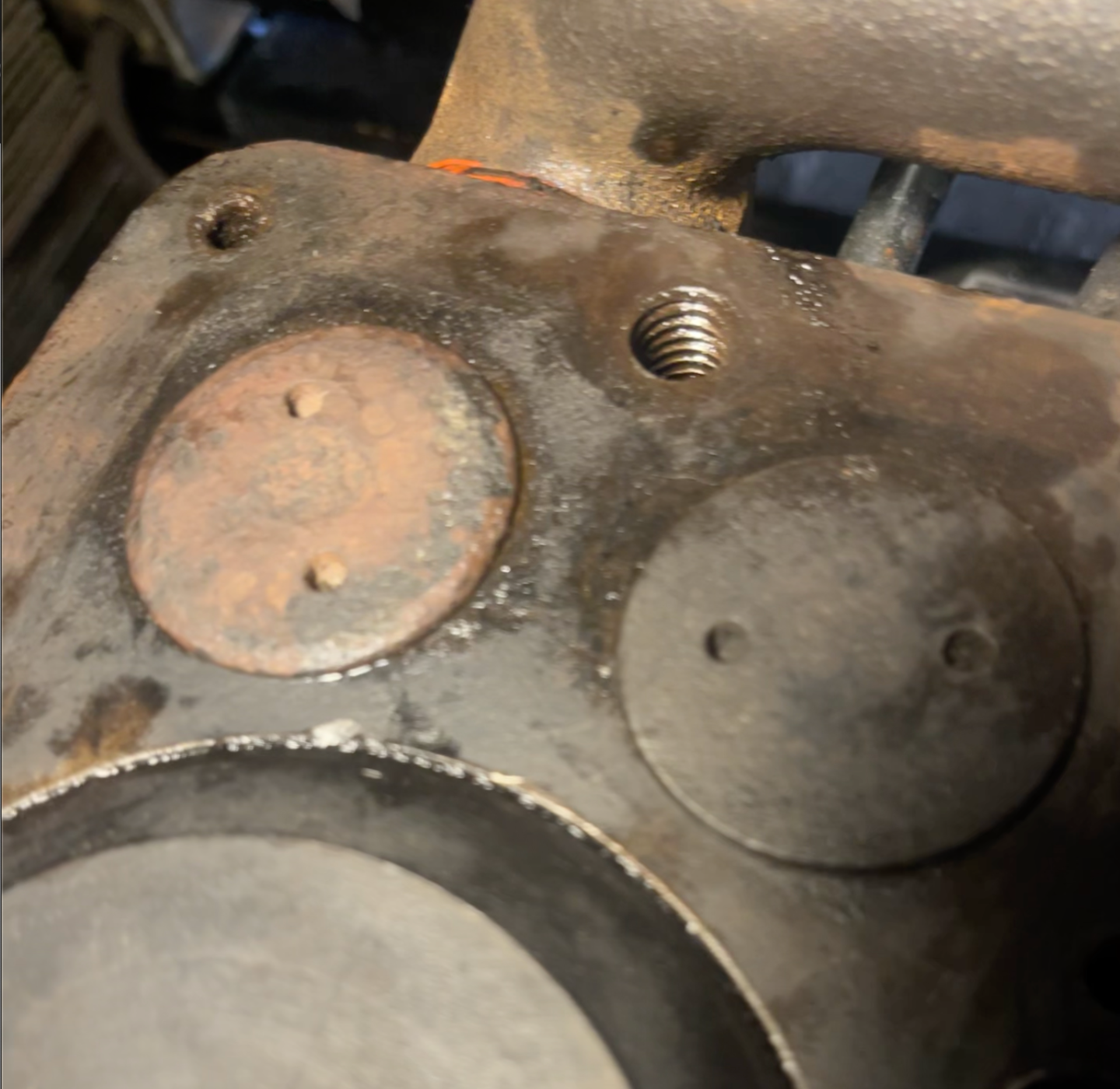

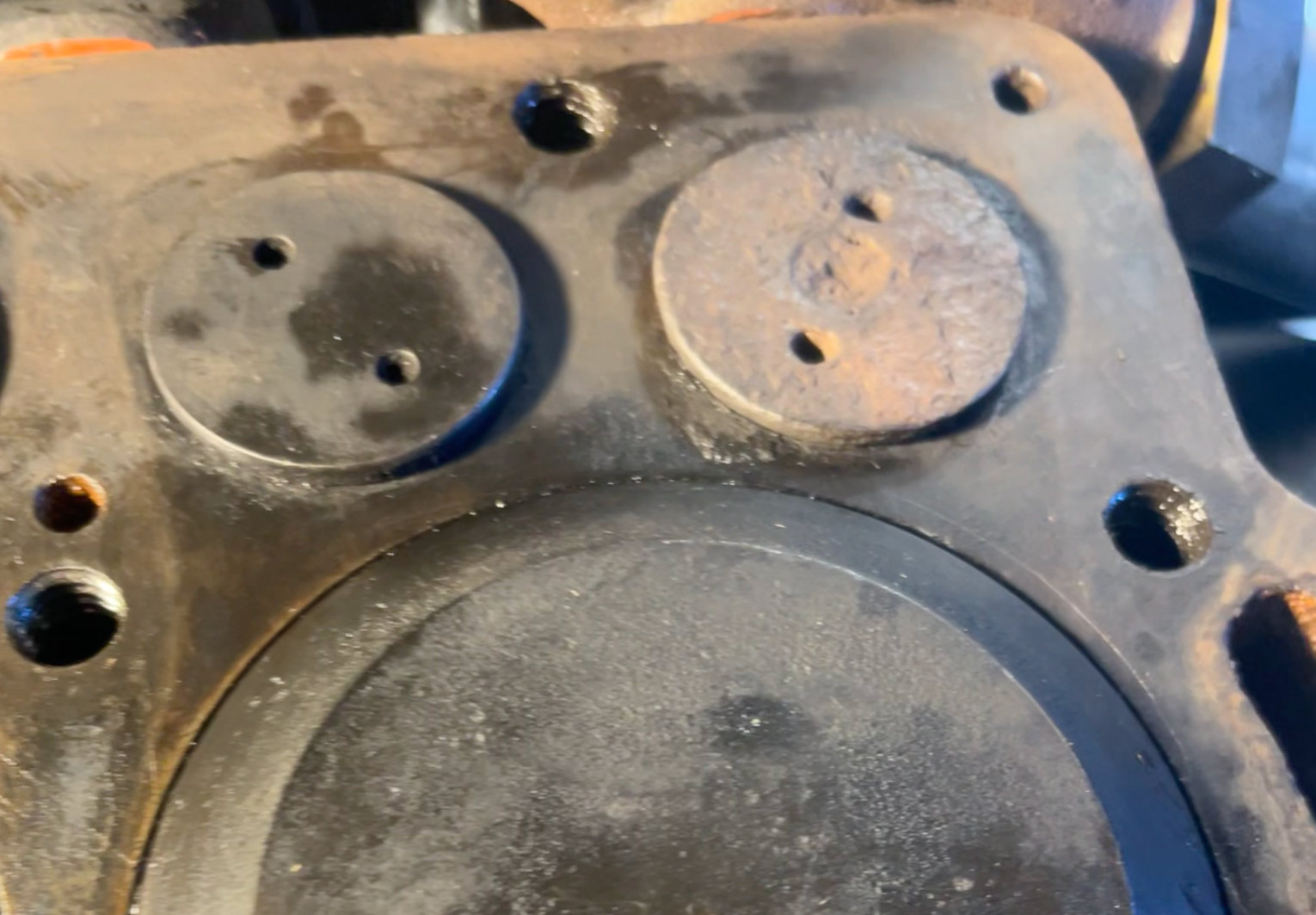

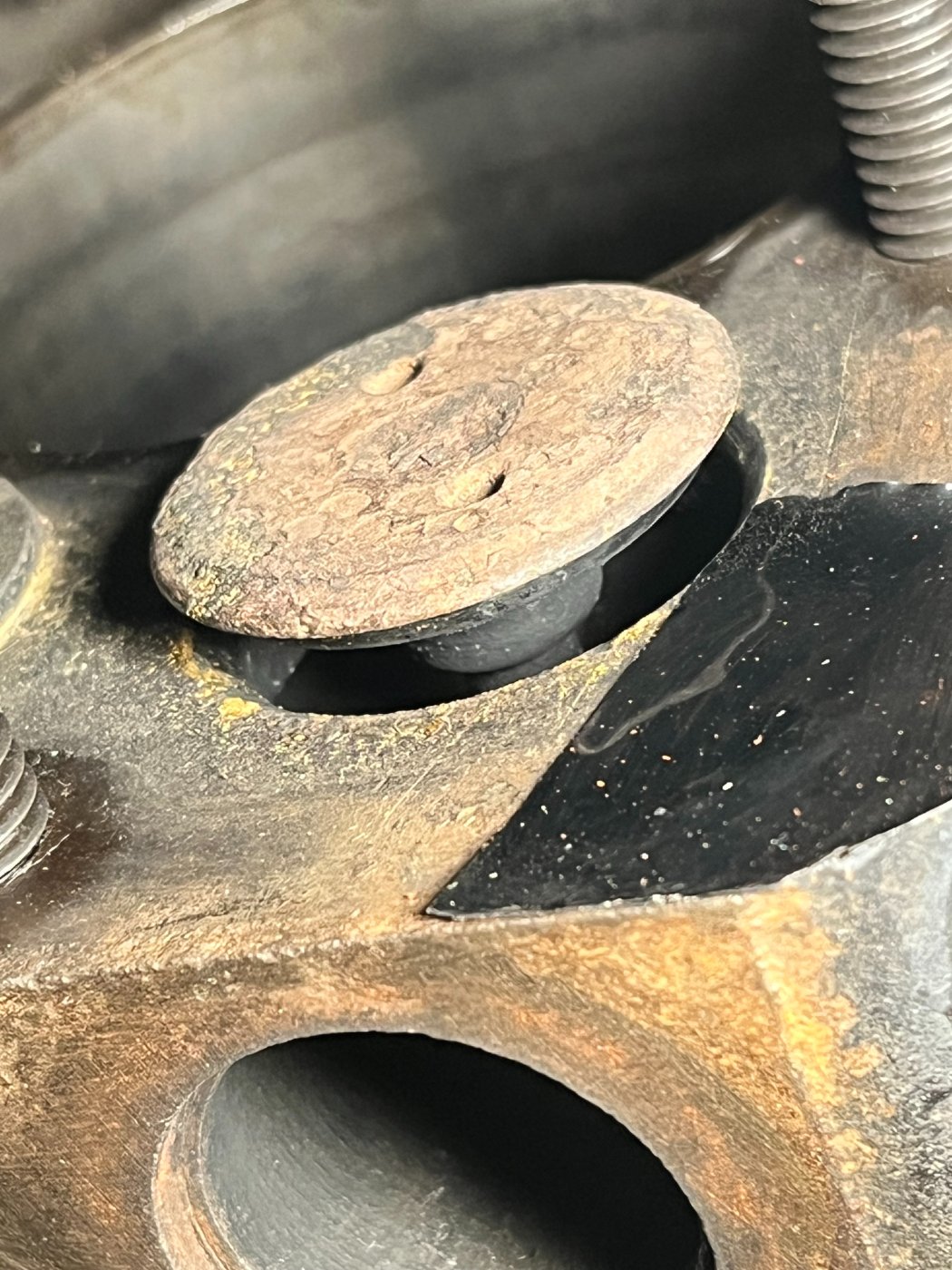

Was looking for some pictures (and guidance) of other's T's showing valves properly seated and without head installed.
On the last start up, I noticed coolant bubbling out from the rear head and knew I needed to replace the head gasket.
Today I got the head removed, spent an hour drilling/tapping a broken head bolt then cleaned up the pistons/valve deck and head.

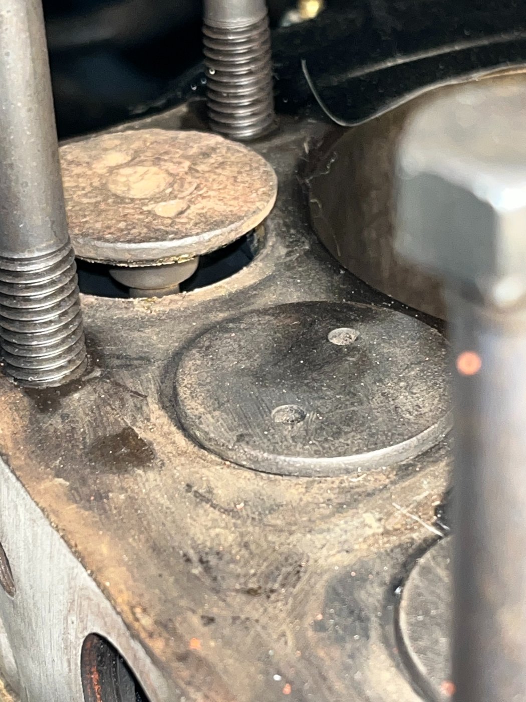

Noticed the valves on the front and rear are really pitted/worn compared to the others.

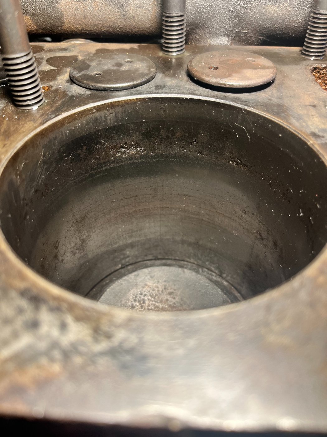

Also noticed the cylinder walls have some bad pits, so might evenually need to have the block sleeved.
Wanted to get some inputs from the forum on what to do with that valves.
(Keep in mind, I am not trying to get crazy on performance).
  • How do you know when you need to replace valves?
  • Do most of you replace with standard "T" valves?
  • What dictates (to what degree of play/wobble/looseness) the need to use an oversized 15 or 30 over valve stem?
  • Is there a budget friendly way to do this type of job without needing to pull the block and visit a machine shop?
  • If yes to last question....Can valves / springs / lifters just be replaced with a cleanup/brushing to the block?
This is my first Model T, so learning as I go with this... trying not to mix my past knowledge with V-8s here.
So far I have done a basic cleanup of the block and head (scraped the gunk + wire brushed) then chased and cleaned up all the head bolt holes.
Inserted the new head bolts and taped up the coolant holes/jackets to keep anything from getting in.
Would love to know what you guys think....
Really not wanting to pull the block.

The engine in your pictures would definitely benefit from a complete overhaul. Dark spots, especially at tje top of the cylinder bores, indicate a lot of wear. The valves appear to be the original two piece style. Please understand that this engine doesn't exhibit the typical ridge at the top of the cylinder that other engines show, since the rings are designed to travel to the top of the bore.

The cylinder in the first picture appears to have severe pitting, perhaps from sitting with water in it for a long period of time. That cylinder cannot function as it should in that condition. Most of the valves look OK, by what little you can tell by looking. The ratty looking exhaust valves are pretty well shot. Replacing all the valves and springs, and grinding each new valve to its seat, is do-able, assuming no seats are cracked or ground too deep into the block. How well did the engine run? I'd be more concerned about the pitted cylinder than the valves. Hot gases blowing past the rings will continue to erode the pitted cylinder wall and may lead to broken rings or a scored piston, besides lost power, rough running, excessive oil leaks, and oil burning. Assuming no cracks in critical areas, it may be that the cylinders could be bored to a standard oversize, or the worst one may need sleeved and the rest bored. Is the engine the correct year for the vehicle? If not, obtaining another engine and overhauling it might be an economical route to a reliable, good-running engine.

I agree with Ed on all issues. #1 The bottom side of each valve is not shown, however the two holes in the top of each valve shown, appear to indicate original two piece valves. Two piece valves are known to 'loose their head' from the stem: not good. If they are original two piece valves they should be replaced. #2 Are the present valves, standard stem. Mic them to find out. If they are standard, do they 'wobble in the guide? If they do, you probably need to go to .015 o.s. stem valves. Valves should not bind and should drop easy into their seat without 'wobble'. As for cylinder bores, if I'm seeing an actual picture, each cylinder may not 'clean up' without sleeving. I have a 27 block that wasn't pitted, but had been a stationary motor and had over .080 wear and I had no choice but to sleeve. If you have the proper valve seat cutter, you might could true up the seats and install new valves, however if the engine requires oversize stem valves, reaming the block for oversize stems is best done out of the car in a machine shop when the cylinders are being taken care of. I know you don't want to pull the motor for a tear down, but attempting to solve your problems with short cuts is just putting a "Bandaid" on your motor.

Looks to me that one cly needs a sleeve, maybe the others will too?

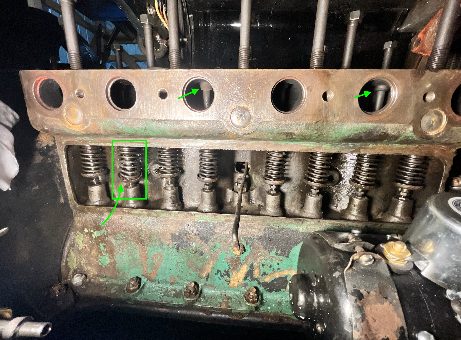

Got into the valve plate yesterday evening to check things out..... very glad I did.
  • I noticed was the failing/deteriorating cork gasket. There was small pieces all over the place, so would have been a matter of time before that clogged up an oil port and starved the lower end.
  • Then noticed was a valve seat that is falling off a retainer pin, unsure how long it has been like that!?
  • I also see the valves are the original 2-piece and I do have adjustable lifters. The valve stems have some wear on them so I should get those replaced.
Forgot to check to see if there is any significant play in the guides, so will check on that.
Here is a video going through each valve... (Wish we could post embedded youtube videos on here).
https://youtube.com/shorts/5CDrdT4PBrg?feature=share
Showing the 2-piece and bad spring retainer
Close up the the end valves (the worst condition ones)

Here is some information on your spring retainer.
https://www.mtfca.com/discus/messages/5 ... 1450555390

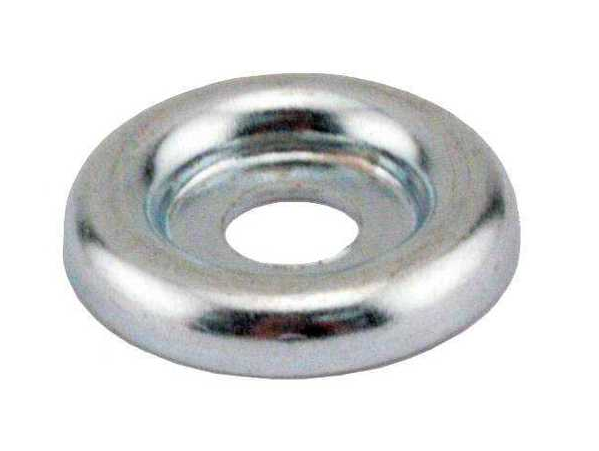

I read that a few days ago... staying away from the retainer with a slot.
I will compress the spring and insert the pin, the retainers I am looking at are solid without the slot
This
Screenshot 2026-02-16 at 1.09.09 PM.png (223.14 KiB) Viewed 547 times

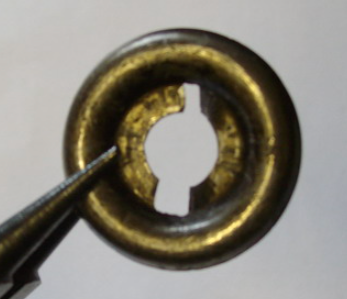

You don't understand, the slot is the worn thru part of the retainer. Thus: failure.
You are looking for evidence the pin is wearing thru your retainers.
As warned, original retainers were tougher/thicker than past thin replacements..
Posts: 5514
Last Name: Hatch
Location: Alabama
Re: Valve replacement - 26-27 block
Post by Dan Hatch » Mon Feb 16, 2026 3:46 pm
You missed the point. They NEVER made a retainer with a slot. The pin wears a slot in the retainer cause the reproduction retainer aren’t worth a s!!!. Pin is harder than the retainer.
Go to a modern valve from a 390. That is all I install in customer engines.

And watch out for worn pins also.
They do wear, especially if someone replaced them with nails years ago.
If I am deep enough to replace valves I use modern angled keeper type for reliability.
I make up a set from various parts and sources.
Mike

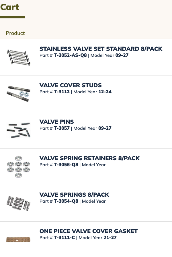

Post by fireheadman » Tue Feb 17, 2026 1:19 pm
Here's what I am looking at for this:
I will look a little more of the thicker or modern retainers as some of you have mentioned, otherwise I'll go with these...
Also from what I am reading, since I am not oversizing the valves (this time around), I can simply use a bottle brush and some carb spray to clean up the guides. No need for a reamer unless it ends up being clogged up with corrosion a bottle brush can't remove.
Let me know your throughts on all this.
Member: Mile High Pedal Pushers - Denver, Colorado Chapter
https://www.youtube.com/watch?v=e5FPWnxG_9w
Posts: 6778
Post by Scott_Conger » Tue Feb 17, 2026 1:45 pm
You are now committing to a full valve job, which includes cutting new valve seats. Cutting new seats means fixturing a cutter to the old worn valve guides and cutting a 3 angle seat.
A set of Neway cutters and tools will set you back around $300-350. Don't just go to eBay and buy a set...call Neway and tell them what you're working on and they will build you a set specifically for a Model T. Plenty of folks will suggest you grab a drill and some old crummy valve grinding stones and whale away on the valve seats. If you do, that will give the engine builder just something more to charge you to repair when that inevitable day comes.
If you chose to just pop in some new valves without reworking the seats, do not be surprised if the car runs worse than it did before you started this work because the odds favor that outcome.
If I were you, I would forget about any new parts at all...ask the Forum for a couple (as needed) original valve retainers and matching original pins, all the while keeping the original valves at this point. If you want to drive the car twice a year to take the grandkids for ice cream, the repro parts are fine. If you want to drive the car any more than that, then you want original parts here.
The above advice is predicated on the fact that I believe you said the car ran pretty well before all of this - and now you know the engine pretty much needs a full rebuild. Just putzing around on this thing at this point will spend maybe up to $750 in parts and cutters and you will still have an engine that is in need of a total rebuild...I would save that $750 for that day when it comes.
FWIW - your engine already has adjustable lifters, so the cam was out and lifters were replaced at one point, and valve keepers were replaced with repro parts at one time, as well. They weren't worried about those valves and neither should you. It's the first time I've ever advised keeping original valves, but with the condition that one cylinder is in and the general condition of things you have very little to lose in keeping them. Save your $$, drive the car easily, rebuild when you're ready. Anything else is simply spending money with little return on the investment.
Finally, it looks as though the valve seats have never been reworked, or if done, were barely kissed. This at least bodes well for the block in that the valves are not sunk down in like many tired engines are.

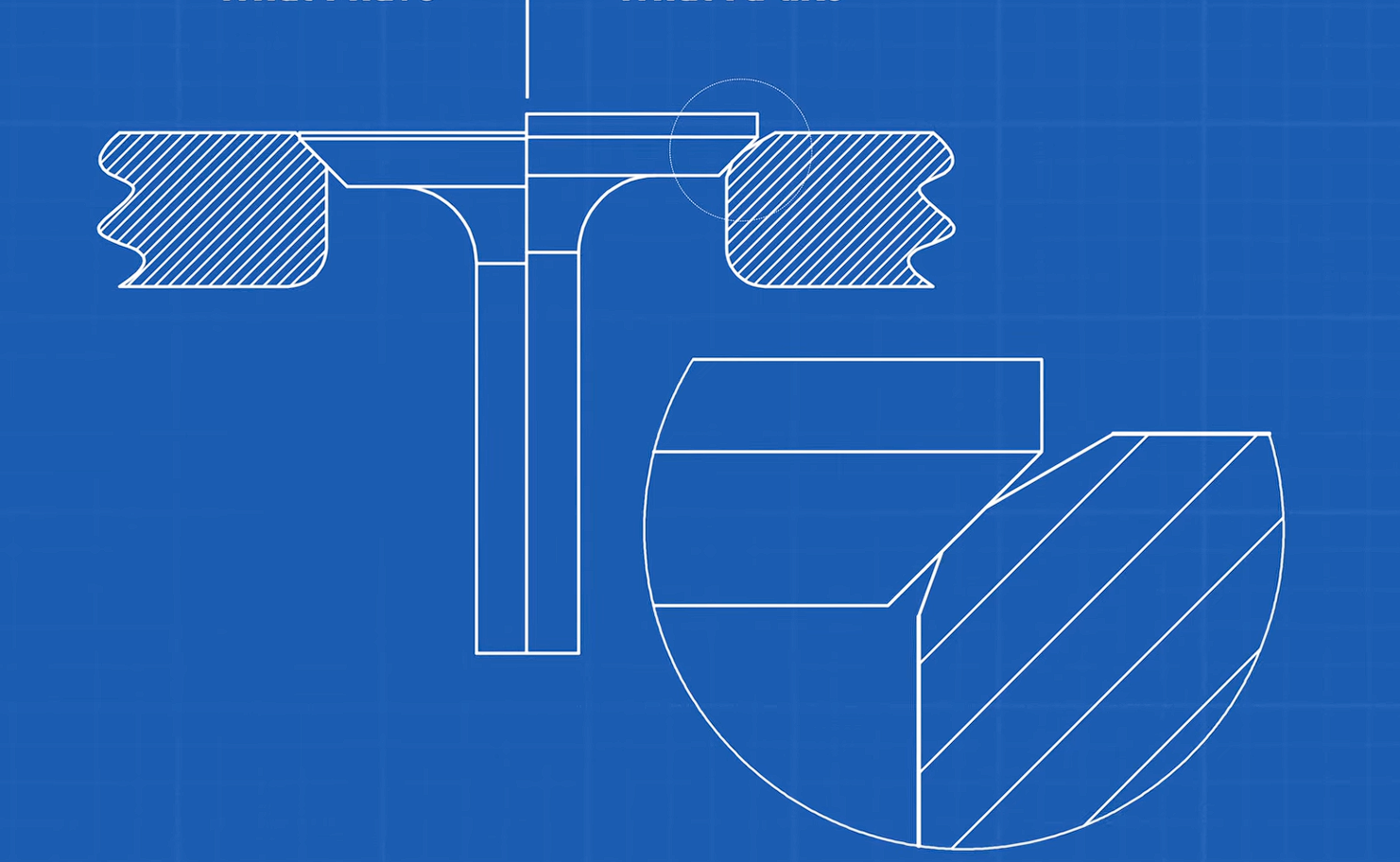

3-angle seat.... found a diagram of this vs a conical seat (single angle)
Posts: 8605
Post by TXGOAT2 » Wed Feb 18, 2026 1:57 pm
Another issue with lapping valves against their seats is the possibility of creating a slight groove in the portion of the valve face that contacts the seat. When the engine is started, the valves heat up and expand, which moves the grooved portion of the valve face out of register with the seat contact they were lapped to.
