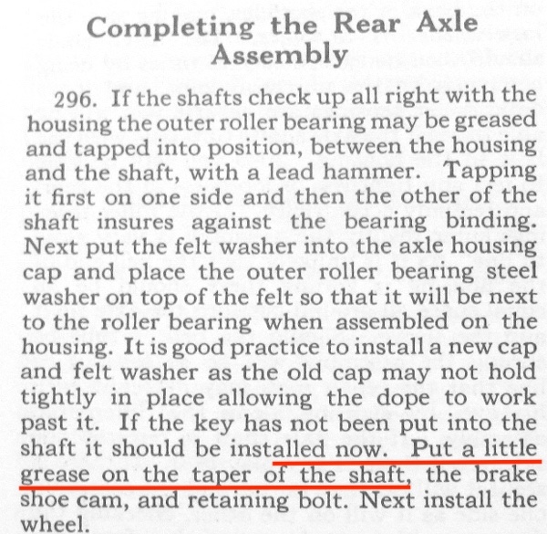

Contrary info from a Ford text book, can't recall the source copied from :roll:
Grease axle shaft.jpg (161.33 KiB) Viewed 553 times

Anti-Seize and grease are not the same thing. Depending on the grade, Anti-Seize can have flaked mica, copper powder, or other other additives. Grease would simply be squeezed out of the taper joint, but Anti-Seize would leave behind its additives to impede the metal-to-metal contact that the taper joint depends on.

Using lubricant invites having the hub go too far onto the shaft, and it also risks the hub not being locked to the shaft, which it must be, or it will not stay that way. If the hub is easy to get off the shaft, it's too loose to stay tight in service. The axle and hub tapers must be accurately made with the proper surface finish to make a good connection. A hub or shaft that has been run loose is very likely to come loose again.
