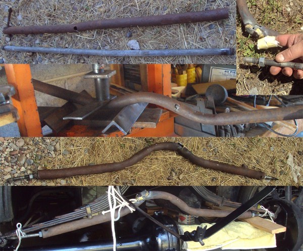

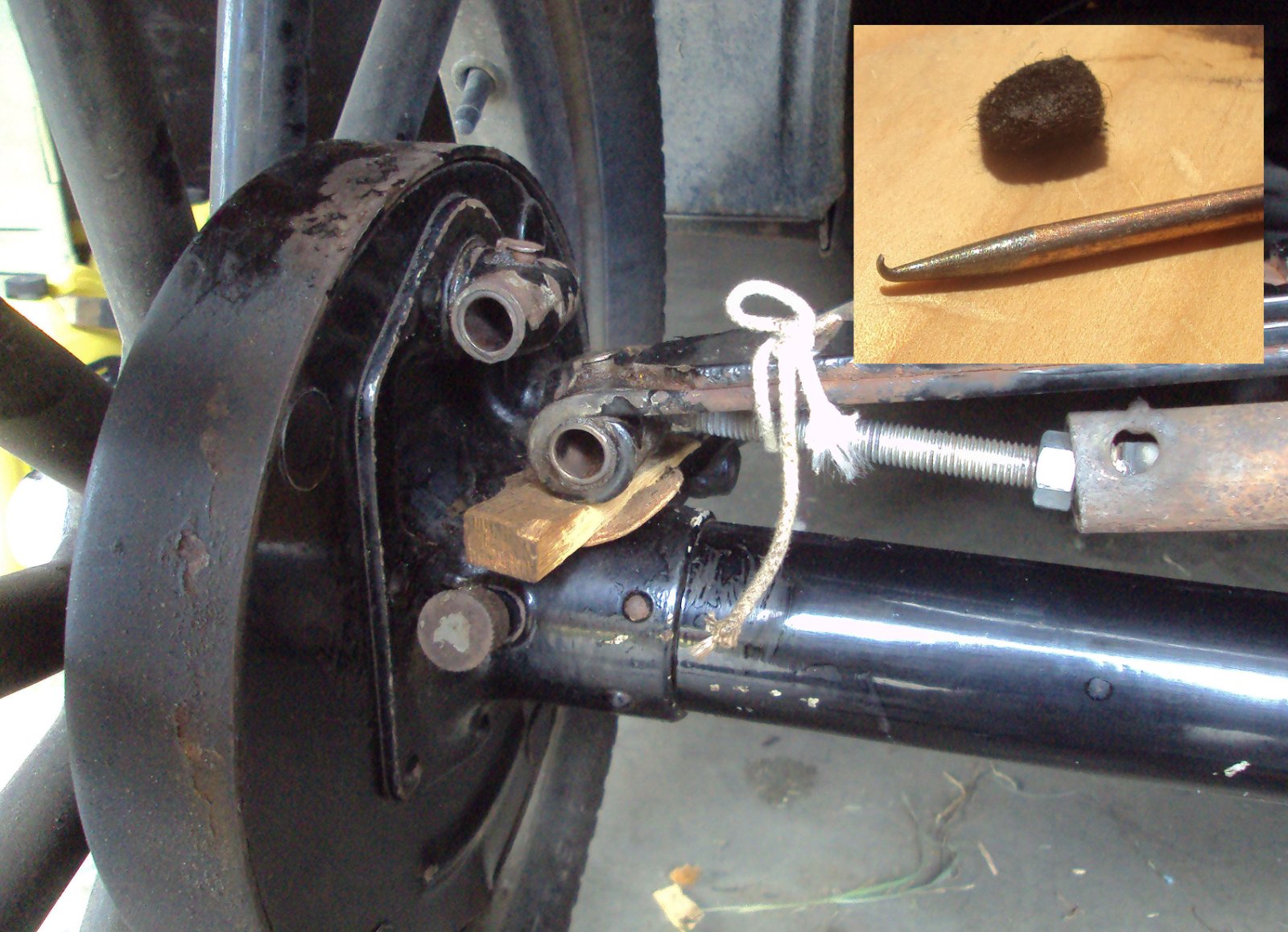

6 years ago I posted the failure of my rear spring shackle. The photo became the "poster boy" for this style and it's problems. Several others mentioned their disappointments with them. I didn't want to be the complaining customer and have reported that even though I had bought some of the better shackles the 3 remaining shackles were in place and working. This weekend I finally got around to replacing the rears. While the remaining rear shackle was doing it's job it had worn the hole in one side larger and oval.
Part of my procrastination was that I was avoiding having to spread the spring. I decided to make a spring spreader out of some old pipe. I found some 1" (1.315 O. D.) and some 1/2" (.84 O. D.) and slid one inside the other. One heavy wall pipe would be better but this is what I had. The one inch had been a u-shaped hoover wagon tongue for a Model T chassis. I thought that appropriate but on bending it where a hole had been drilled it cracked and seemed like it was cast iron or something brittle. I thought a patch brazed there might give it strength.
This is the part of the story where I ask for sympathy of forgiveness for stupidity. Grinding the patch piece I let the bench grinder grab it and sucked my finger in with it. It only took part of the nail and a couple layers of skin but was a warning to be more careful and made the rest of the work awkward with 3 layers of bandage to keep the dirt out.

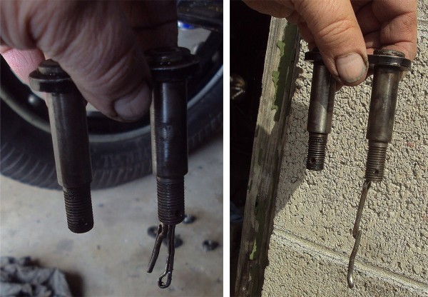

At any rate the spreader did work to some degree but needs some refining. The 1/2" threaded rods in each end were not long enough and cocked to an angle. I used some wood wedges under each spring eye. The cotter pins in the nuts behind were merciless to get out. These shackles are best installed before the read end assembly is put under the car. I found the loose shackle bolt was greasy but the other had lots of red rust on it and in it's bushing. Further more a piece of felt was still in one oiler. I had thought this was a good idea to keep the oil from running though too fast but evidently it caked and wasn't letting much oil through at all. Shown is a hooked tool to remove the felt. This very well may be what led to the failure 6 years ago. If the shackle bolt seized in the bushing and the link rode on the serrated part it sawed it's way through. If so I need to take responsibility for the failure rather than blaming the design. Before the day ended the new shackles were in place. Between the heat and shaky old man I have become it was a trial. But another item I can cross off my list. Getting the job completed always makes it worth while.

You shouldn't even need a spring spreader. Just put small 2x4 blocks between the ends of the spring and the axle housing. Put in one shackle and then lower the body/frame. The spring will spread until you can push the shackle right in. You might need to add some weight to the back of the body to do this, but either someone in the back seat if it has one or old engine block or flywheel etc You should be able to push the shackle right in and bolt things up.

To add to what Norm posted above about resting the spring on wood blocks:
Also, loosen the perch bolts as much as possible so the perches are further inboard. This will make installing the shackles easier and you should be able to avoid the need to spread the spring on the wood blocks by adding weight to the car. Once the shackles are installed, align and tighten the perches. This is how I installed the shackles in my dad's touring and my roadster.

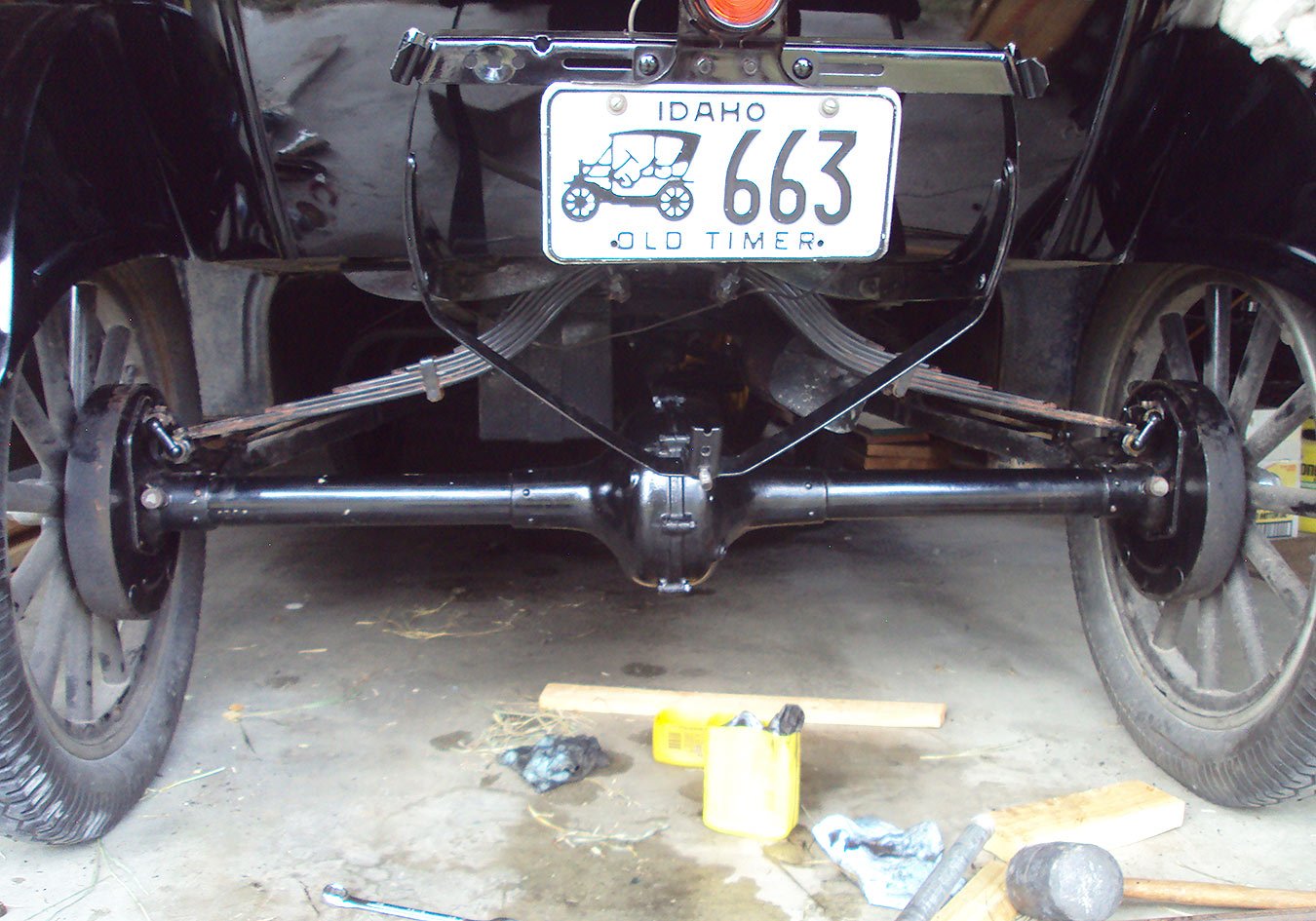

Those are very good suggestions. I have installed springs and replaced shackles several ways over the years. Several techniques were used including Norman and Erik's. Perhaps my model A days put me in the wrong direction. The photo shows how I did my A in 1963.
I inherited a Model A spreader and gave it to a Model A guy thinking I didn't need it and he could lend it to other model A guys rather than me lending it out. Sometimes we forget what has worked in the past. On a new installation off the car I simply install the main leaf and then add the other leaves using a long threaded rod instead of the spring bolt. Sometimes c-clamps are added. I guess if I had researched the subject here it would have made the job easier.

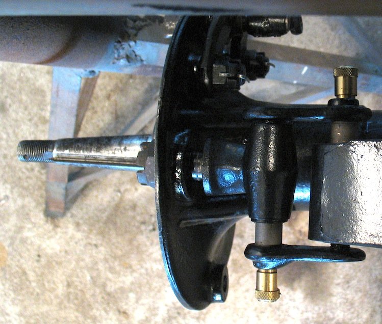

I have posted this before, but it has been a few years. The new shackles are drilled only halfway through, rather than all the way. Since the shackles are at about a 45 degree angle when in place, only one on each end of the car gets oil through that hole and to the bushing. You need to drill them all the way through, so there will be a hole on the bottom side of each one when installed. I haven't bought any new ones for several years; maybe this has been corrected. But I doubt it.

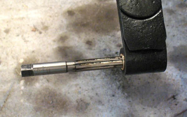

Another problem folks may be having is installing new bushings and not reaming them. Either type of shackle can be forced in place and be too tight to rotate properly. Eventually they should wear to fit but reamers are offered by the vendors for some reason. I didn't see anything in the Ford manual about reaming bushings.
- Posts: 7350
Re: The bad Shackle Revisited
In some cases reaming may be needed just get the shackle into the bushing. That goes for both kinds of bushings.

I finally replaced the front shackles after buying front and rears 5 years ago. No problems or surprises except I still wonder why the old shackle bolts are magnetic. One is stronger than the the other three.
