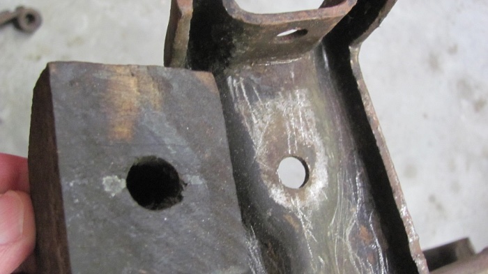

The belly bands are just added support for the engine crankcase already mounted. So yes, install the T engine factory way, wood block motor mount at pan, with both bolts, and be sure the wood block inside the frame to the inside of pan arm is tight, you want to have to knock that block in place.
Takes strain off the arm, as the whole engine will twist in the chassis with braking and low pedal acceleration.
Note the marks of the arm on the inside of an original wood block, was fitted very snug to get this impression.
