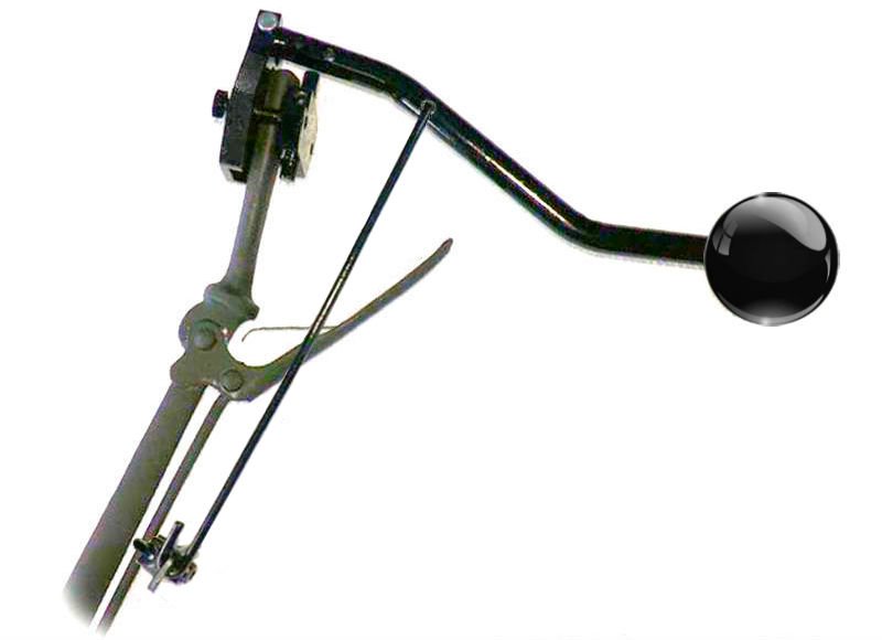

I patched together some artwork in Photoshop to show how the extension works. And yes, this accessory would have to be unbolted and uninstalled in order to completely remove the aft floorboard, but rather than do that, I'm sure there must be a way to move the floorboard out of the way sufficiently for routine greasing and oiling. Can't make an omelet without breaking eggs, I guess.

Bob
I have held the lower floor board up out of the way with a bungee cord when cleaning out the screen in the tranny and turning the grease cups without removing the extension. I removed it when changing the bands and installing AC brakes.

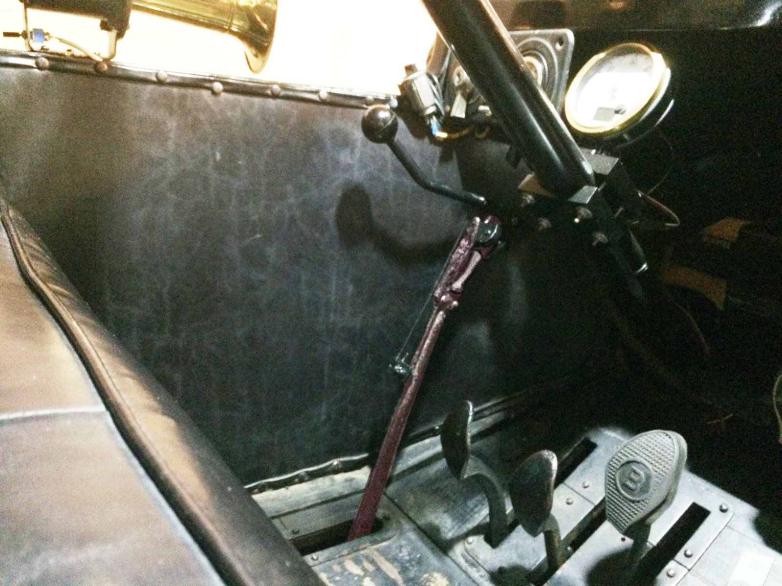

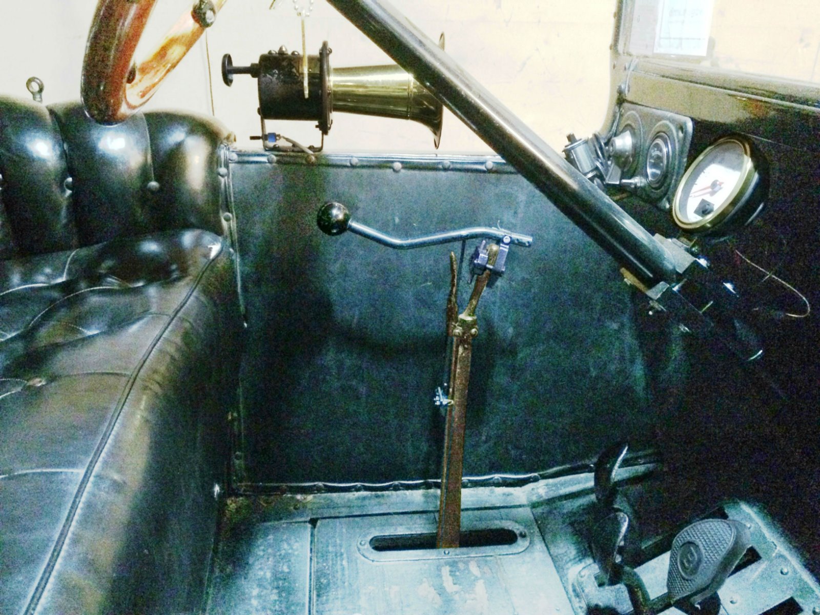

Finished up the installation. Pretty easy to do.
To release, pull back slightly, lift then push forward.
Here are some photos of what it looks like in a 1915 Touring.

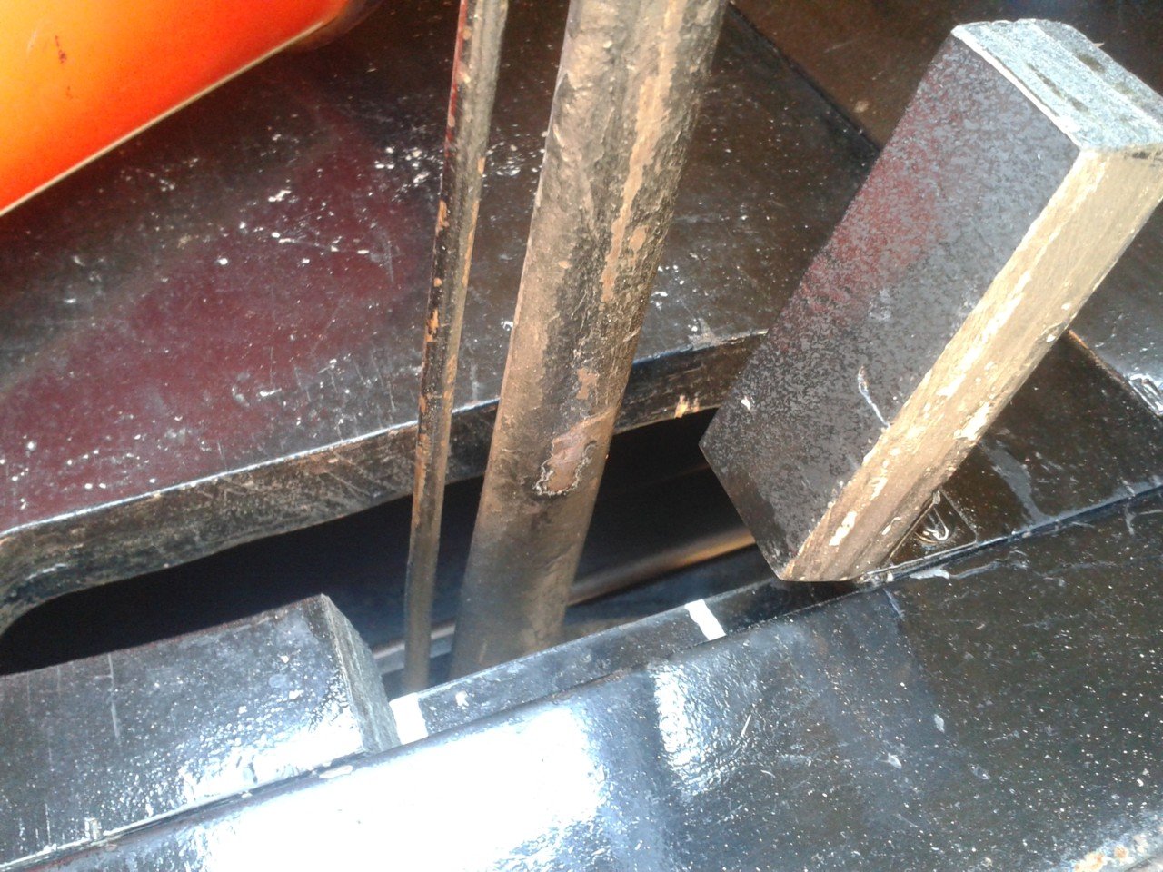

To facilitate floor board removal I have made a small hinged trap door on the side of the floorboard. Flip it up to remove the board sideways. I have also cut a small slit in my rubber floor mat, hardly visible. Removing the extension attachment to get to the hogshead is a pain in the butt and takes time and effort.

So I drove the Flivver to the local cruise-in yesterday and the lever extension was a real pleasure! Yes, it does take up a bit of side-to-side leg room when in the full aft position, but not so much in the neutral position, and not at all when in the full-forward position. Yeah, I'd recommend the living daylights out of this product for anyone who, like me, has a physical problem with leaning forward to get the lever into high-gear. Having had most of my lumbar vertabra fused together, it was starting to look like maybe I wouldn't be able to drive a Model T any longer. I'm glad that turns out not to be the case.

Hi Bob,
Here are the trap door pics as promised, hope this helps

Forgot to mention my car is RHD. If I may ask, GG, won't the extension fit a 26 - 27 and why not?

Thanks for the photos, Paul. Nice installation. I hope to do as neat a job. Thanks again.
